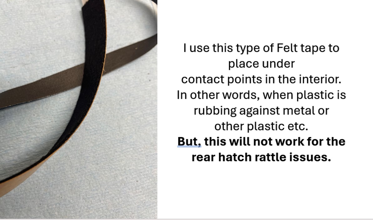

There are quite a few rattles for sure.
1) Rear hatch trim. The rear hatch plastic piece that connects to the rear hatch door. I put little pieces of felt on certain points. Got rid of those rattles.
2) Passenger side cubby with sliding top. Rammed a piece of felt between the top and the sliding door.
3) Driver side seatbelt rattle. Took the seatbelt housing off, and put some felt in there. There is a small metal flap that vibrates, so I put some felt under it. Pretty much all gone. Good video on it here:
4) Sportschrono rattle. This only rattled once or twice. I decided to take it off anyways, and put very small piece of felt under the housing, with some Krytok. It's gone (for now).
5) I did not have a cross bar rattle, but I took it off anyways as I had to wrap the bar. I put some felt on the main contact points, just incase she started to rattle like others have mentioned.

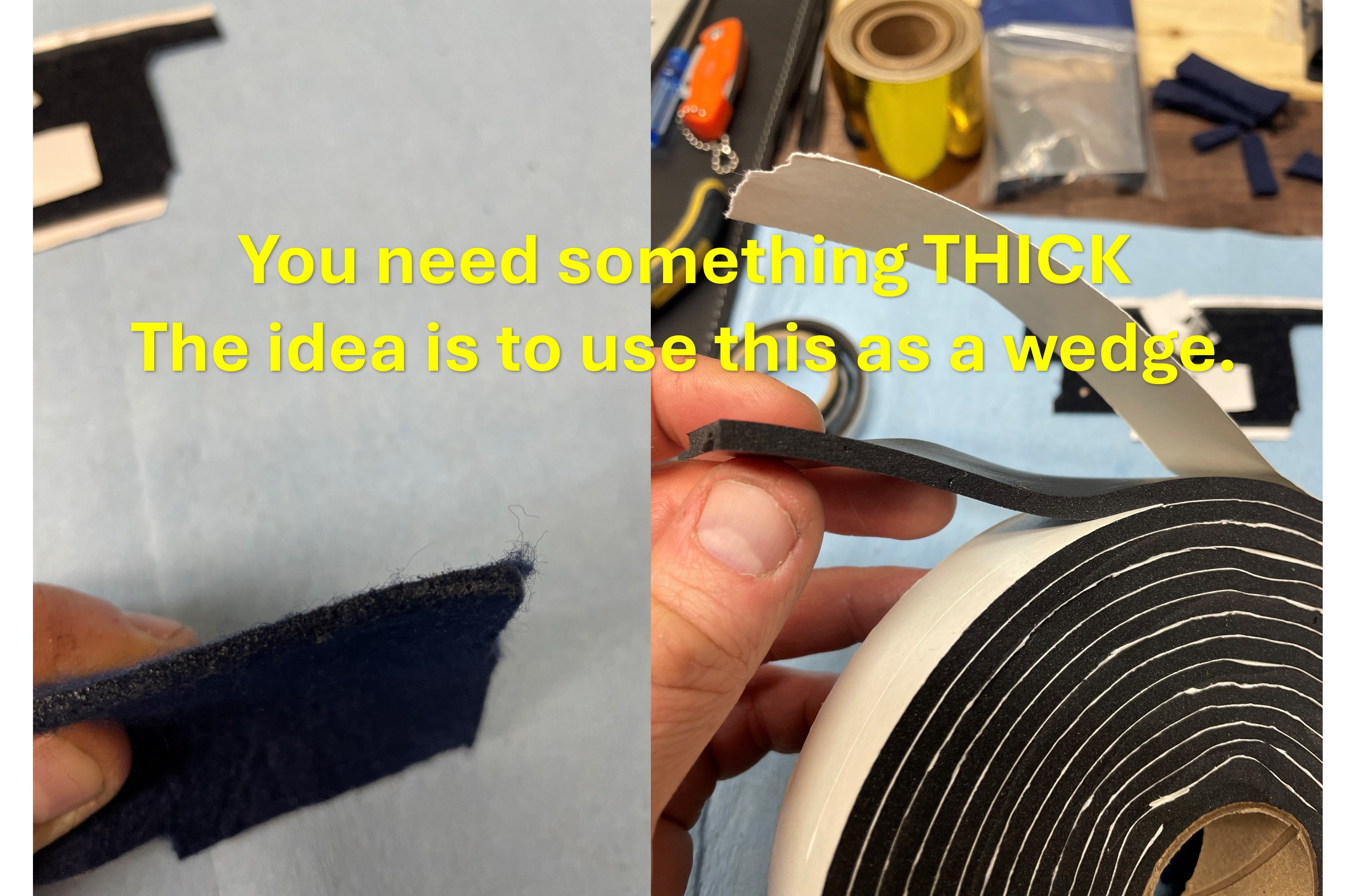

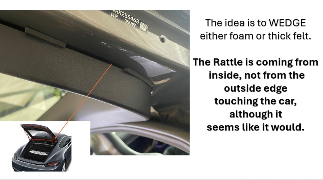

A member asked me to provide more clarity on the rear hatch rattle. This appears to be an issue for a lot of people.
Most of the time, the following things fix it (certainly not all cases, like mine).
1) Adjust the little nobbies. This can get annoying, as you keep having to do it, and it rarely completely solves this issue.
2) Take off the privacy cover.
3) Putting felt on the stoppers help, but thats a different issue that I have not experienced.
This is for the plastic trim piece connected to the rear hatch. Some would think you can just put some felt down, but unfortunately that will not fix it. The plastic trim is put on in a manner that there is always a little gap between the trim outer edge, and the actual hatch.
The rattles comes from inside the plastic trim, and not from the outer edge of the plastic trim hitting the metal hatch door.
So, I found that you need to "Wedge" something in between the plastic trim and the metal hatch door. This is not to stop it from hitting the hatch (it never did in the first place), but the create more tension inside the trim, thus creating less area for things to move around, and therefore, less rattle.
I hope the following pictures help explain what I am going on about haha.
To note: This is how it looked when I first did it. It's ugly I know, but later on I made it less noticeable. All I cared about was stopping that damn rattle lol.

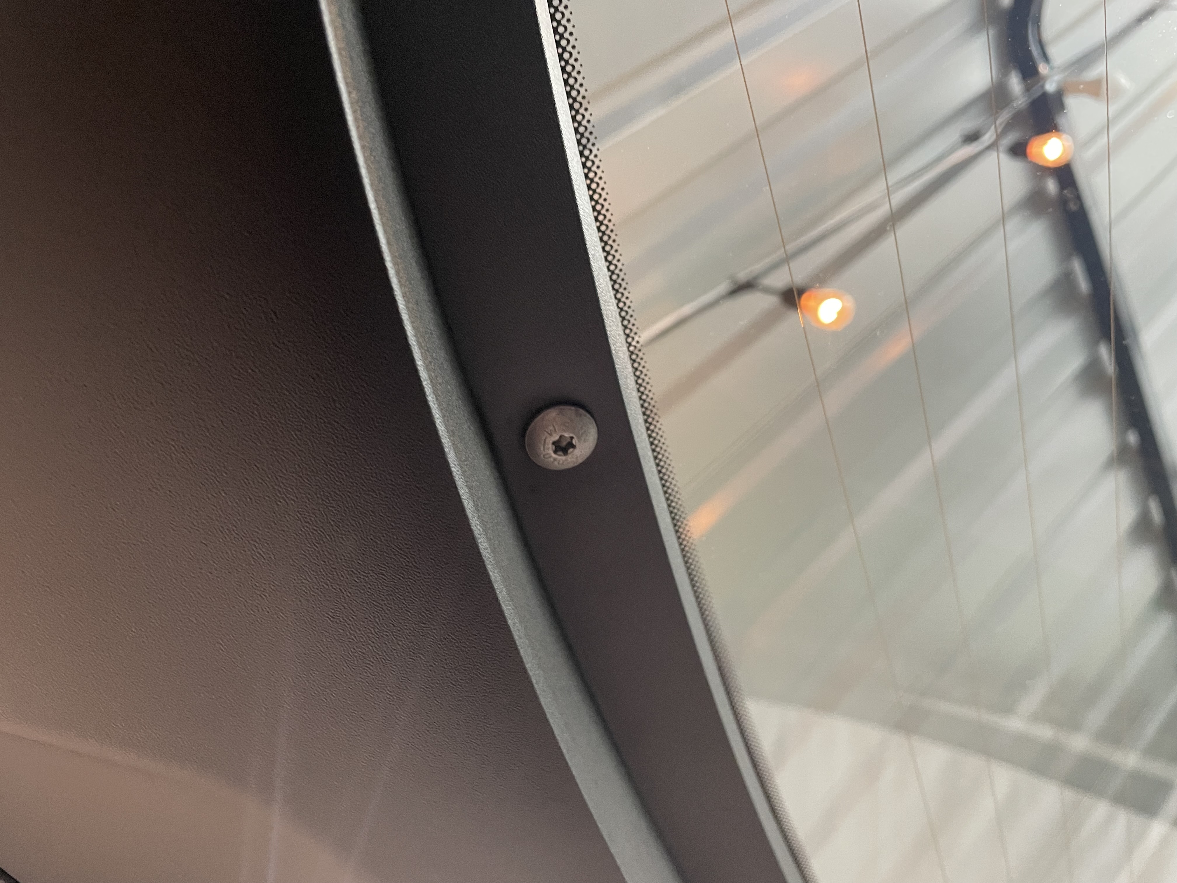

ONE MORE THING... If you are one of the people who took off the privacy cover, make sure you screw something back in those holes. If you just take off the cover, there is a lot of play now in that area. For example, see picture. (Don't worry, I eventually got black screws ha).
