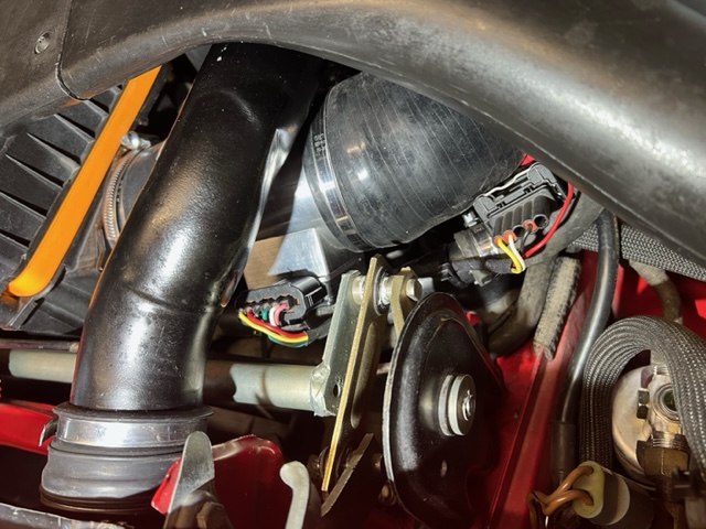

Hey Folks. I'm currently installing the Vitesse Stealth MAF/MAP kit on my 87 951. I went with the stealth kit because this will be more of a show car than a go car, so I prefer to keep the look of the factory airbox....especially since I paid over $400 for a brand new one earlier this year.
So far I have hit a snag with the fitment of the aluminum pipe with the MAF (that replaces the AFM). Per the supplied instructions/pictures, the MAF sensor plug should be mounted upside down with the plug side slightly rotated towards the front of the car. The problem I'm running into is that it's touching the coolant manifold bar and because of this, the factory airbox won't sit all the way down in it's mounts. Therefore, my hood won't close (my brand new hood insulation seems to be pretty thick).
I'm wondering if anyone else has installed the stealth kit, and if so, could you chime in with any tips and tricks? If not, my next step is to fabricate a new MAF tube so I can move the placement of the MAF in BETWEEN the factory airbox and the intercooler to throttle body pipe instead of UNDER the IC to TB pipe. This probably sounds confusing and I'll try to take some pics later tonight.

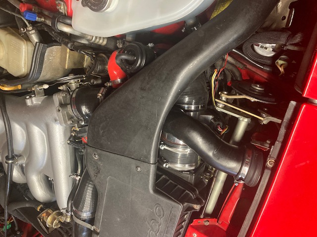

It is a very tight fit, I have the same setup and there is enough adjustment with the air box mounts to raise it so the sensor isn't touching the coolant pipe.

This is exactly the kind of help I was looking for! I will try to slowly raise the airbox and see if I can gain some clearance for the MAF and still be able to close the hood. My hood insulation is new and fairly thick.Doyle623 wrote: Mon Dec 25, 2023 7:04 am It is a very tight fit, I have the same setup and there is enough adjustment with the air box mounts to raise it so the sensor isn't touching the coolant pipe.

Well, after Christmas, the flu and a short “honeydo” list, I was able to get back to the 951 MAF kit today. I’m glad I also have my 87 S to drive around while I tinker with the turbo.
I was able to manipulate the MAF tube a little but still couldn’t keep one side from making contact with the coolant manifold. So, I cut a short section of Rennline fuel line and cut it lengthwise to put between the coolant pipe and the MAF sensor housing.
