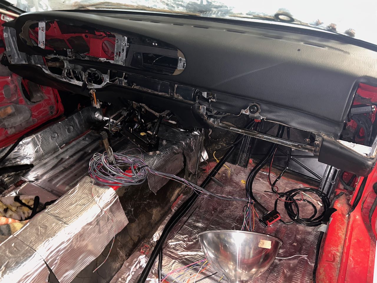

3. Since the HVAC box seems to be working, I set the dash in place. It is not bolted down yet, but now I can figure out where to place other things (e.g. mounting O2 gauge, 'KLR2.0' box, wiring lengths, etc.)

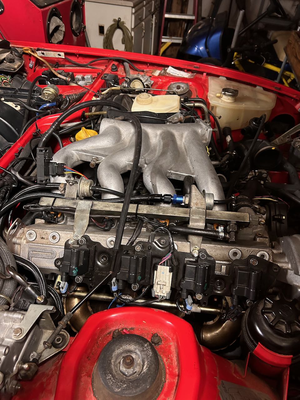

Coils in place on the bracket. One more fuel favor line to run from the J-boot to the Air Oil Separator (deleted the spider's web metal piece so have to run a line).

Dash in place.
