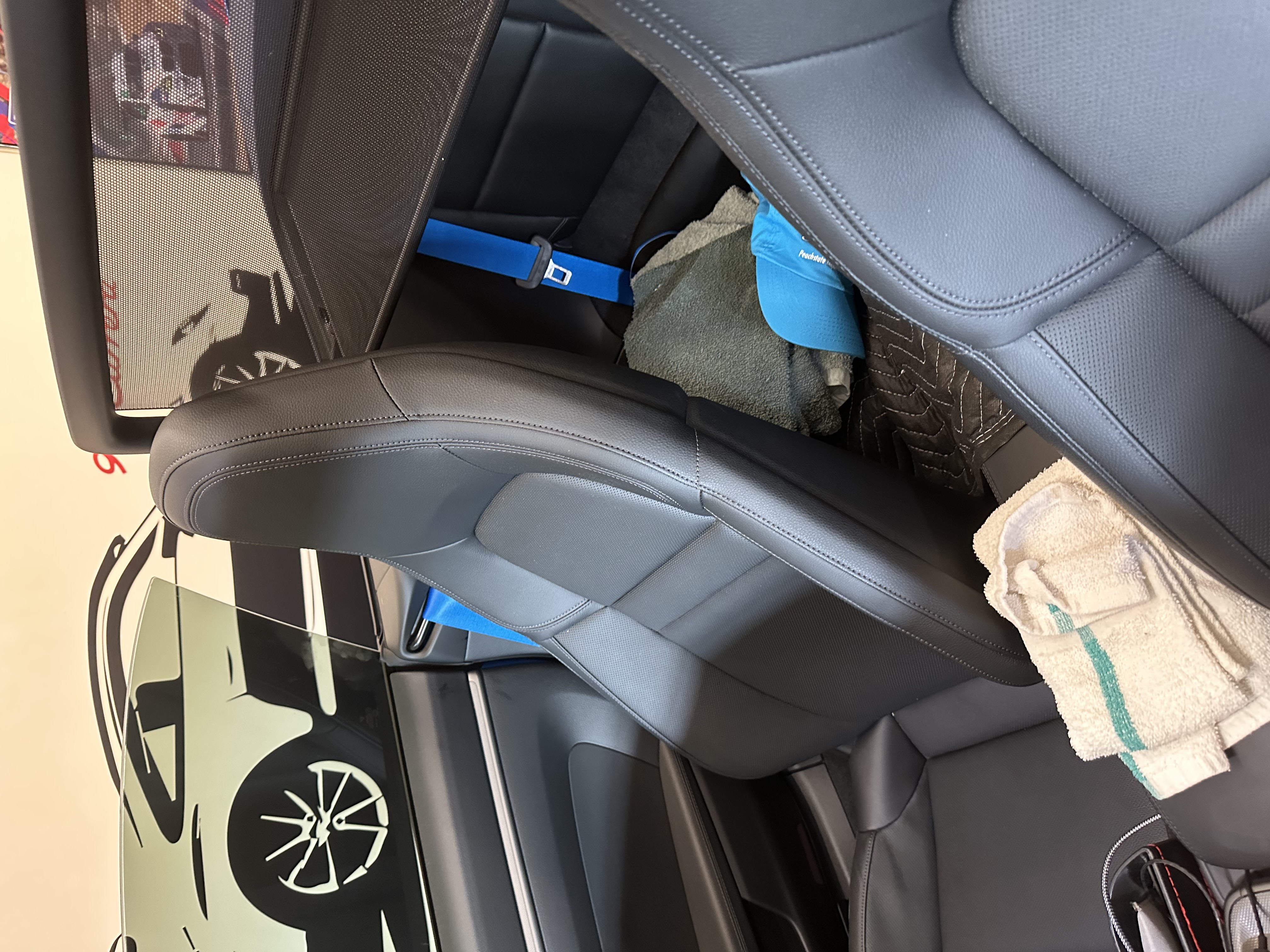

The 2021 992 was not optioned with matching Miami Blue seatbelts. Does anyone know if the 718 Cayman\Boxster belts would fit the 992? I don’t understand why Porsche offered that color for the 718 but not the 911 992. Any help would be appreciated.

Thank you guys. Aftermarket non-Porsche belts are probably a NO for me. I don’t know the testing that have been done on aftermarket stuff. Worse case, I could use Racing Yellow in it. Not my first choice. I’m mad about it, only because Porsche offers Shark Blue belts with the Shark Blue paint when they discontinued Miami Blue. Not the end of the world.
