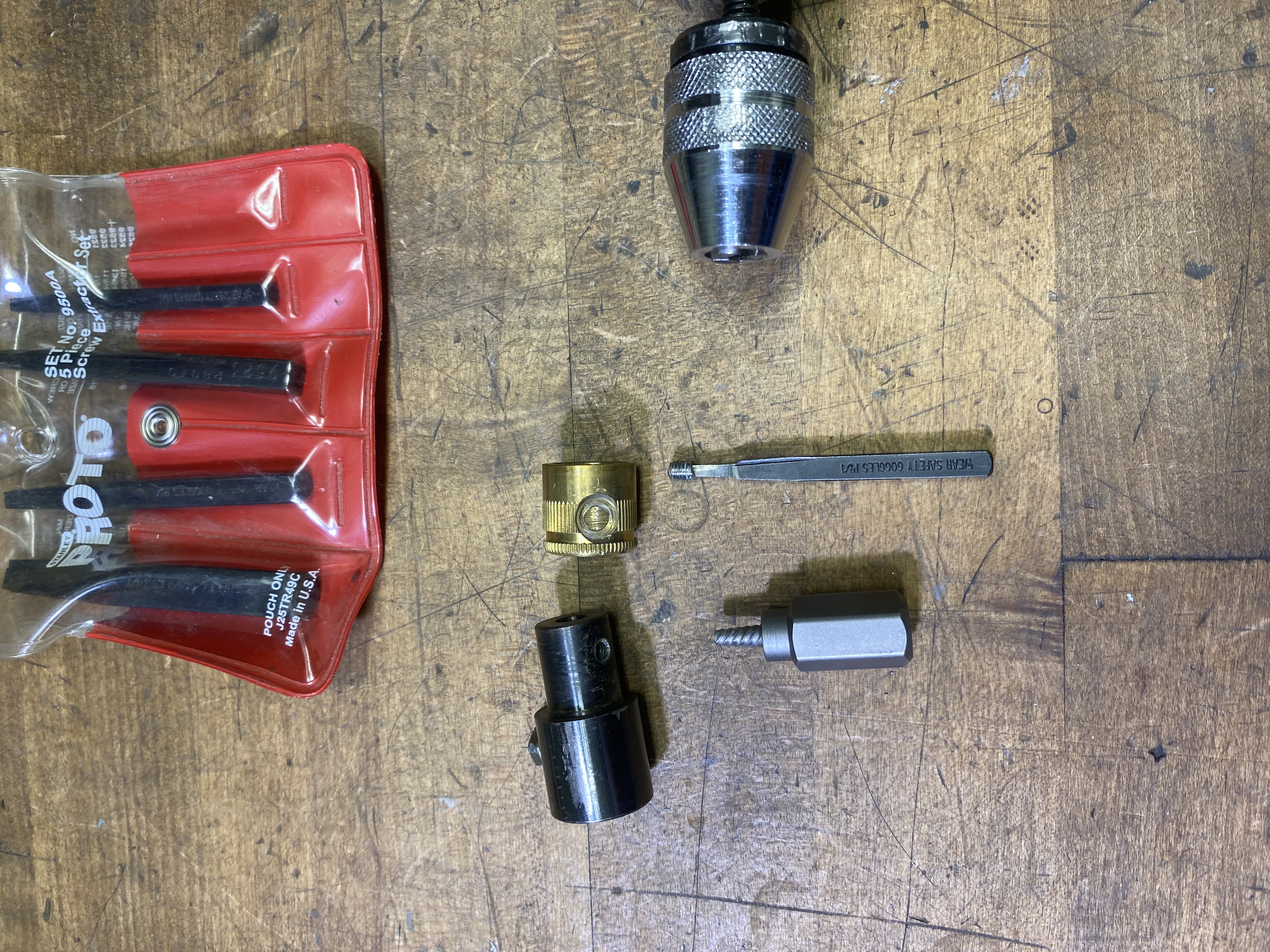

So the rotor screws really suck to remove when they are sitting in a car for 20 years.
Left hand drill bit.
Irwin extractor
Proto extractor
Heat gun
Cold spray
Most important is endless profanity directed at the part until broken piece extracted. PM me if you want to know what words work best.
The more offending the better as it scares the part into submission 🫢😉
