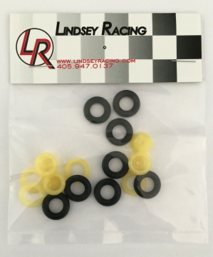

I can take pics tomorrow when i tear it down again ... but in the mean time .. i bought the kit from lindsey racing
$24 fuel inj seals Lindsey.jpg (69.48 KiB) Viewed 987 times
they look like this
but the seat caps are yellow ... the injectors are black with brown top areas and the bottom part has a an o-ring the plastic ring and a space .. so is there supposed to be an o-ring sandwich down there ? (o-ring, plastic ring, then o-ring)

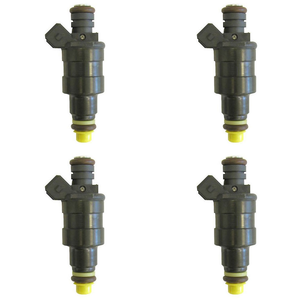

ya they def dont look like this .. there is a big space between plastic ring and bottom of inj body .. so do I gotta press the seat on better i guess .. it felt like it was all the way on though .. do I have to press pintle thru hole ? .. press hard on seat more ?
Posts: 9092
Been thanked: 4078 times
Bosch has included the wrong pintle caps for the 944 injectors for years. Almost all resellers give you the yellow Bosch (incorrect) caps, which don't seat all the way, like you are describing, so most people just keep the originals. No idea if Lindsey has sorted that out with their kit, but I'm guessing not based on your experience. The only retailer I know that supplies the right caps for sure is @Rennbay. I thinking the Rennbay kit would fix your leak...

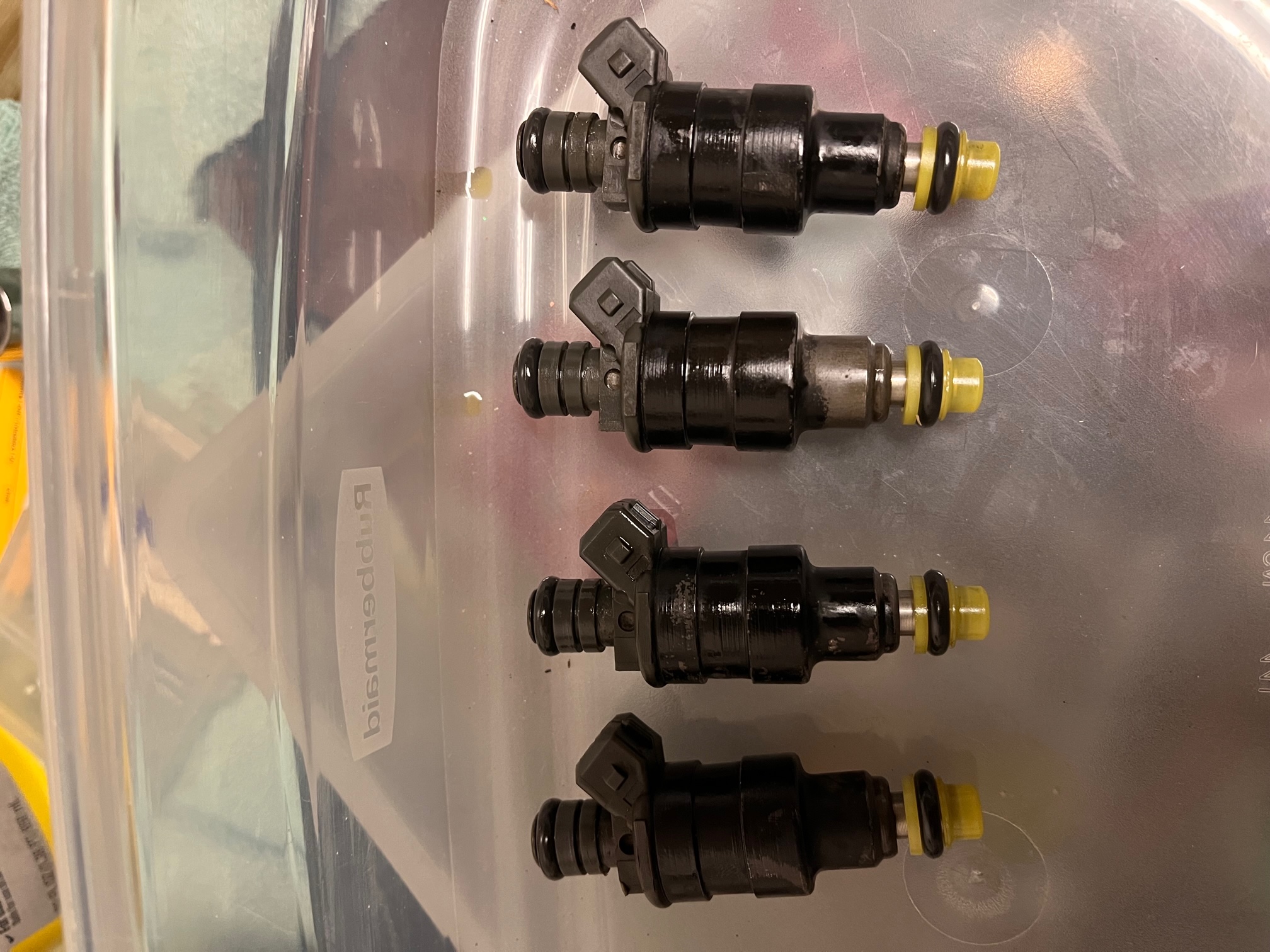

heres my fuel injectors with the yellow caps .. as you can see theres a huge space and it doesn't look right … im ordering the rennbay ones 👍🏻
-Eric
Posts: 9092
RED944M5 wrote: Wed Apr 26, 2023 6:12 pm IMG_1998.jpeg
-Eric
Good plan! That gap isn't right...

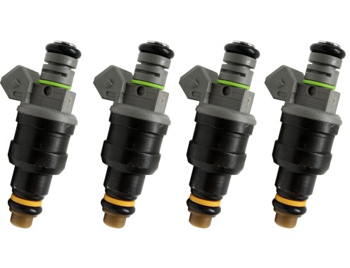

Heres the rennbay ones now in blue appearently, next to the previous leaky ones ... and I just installed the rennbay ones ... works like a charm .. no leaks ... 3d printed timing belt tool and 3d printed cam gear tool worked like a charm, belts all working good, no leaks, no white smoke ... took it for a ride, it's been down for 2 years because I was overseas for a bit .. it was quite exciting to drive it again !!
