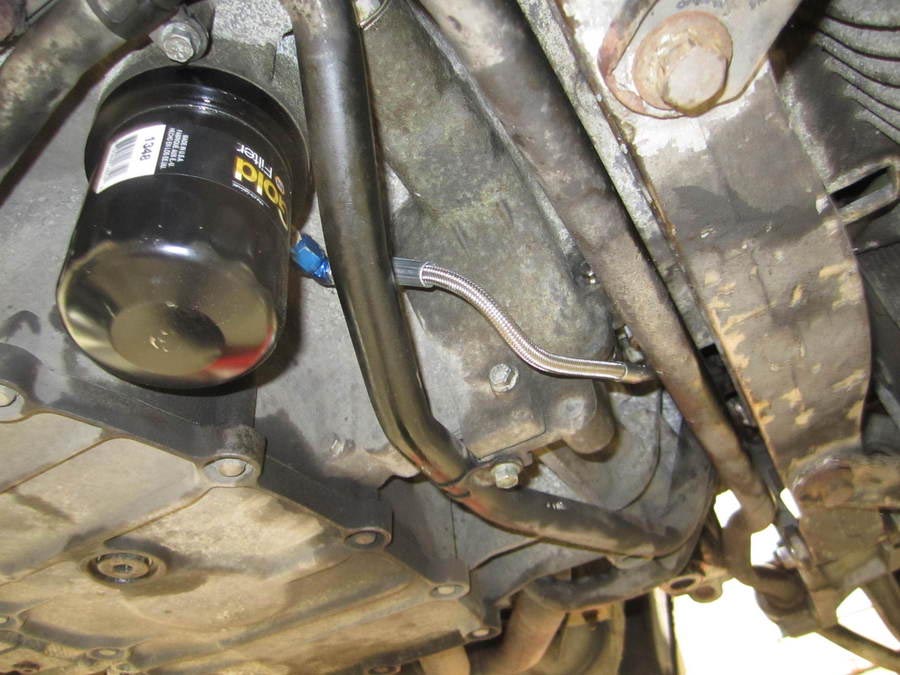

Some IMS repair/replacement kits use the installation of an oil feed line from the engine oil filter mount. If your Porsche has one of these aftermarket oil lines you know the IMS has been replaced. Not having this does not mean it hasn't been done with a different style of kit. But if you do see a line like this, it may give you some peace of mind.
IMS Oil Feed.jpg (119.51 KiB) Viewed 911 times

There is also a repair that replaces the bearing with one that has oil line from a connector coming from the top of the engine. Similar looking braided line. This one engineered by Pedro’s garage.
I have used this update on a Boxster and a 996.
