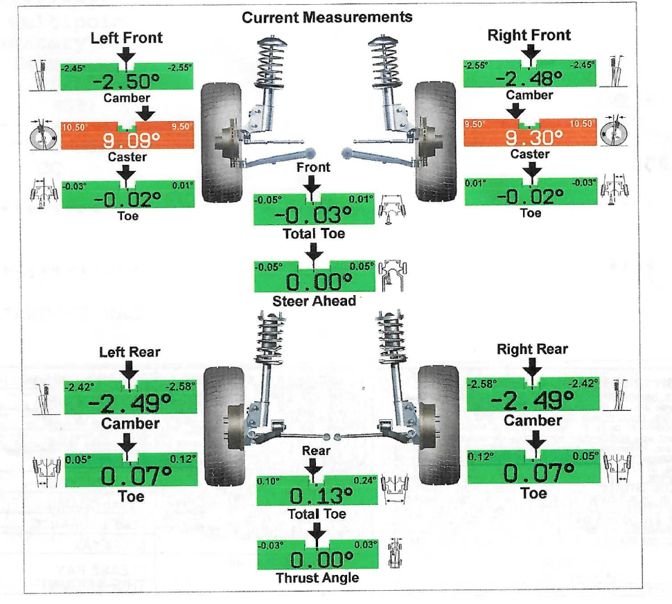

So, to use as a comparison to what's being discussed, the track setup I currently run is -2.5° camber at all four corners with slight -0.02° front toe-out & 0.07° rear toe-in. For me it also works fine for occasional street use, much of which is driving to and from tracks.
Also, this is with Tarett front monoball Race Design camber plates/spring mounts and rear Tarett Motorsport Style turnbuckle toe links.
