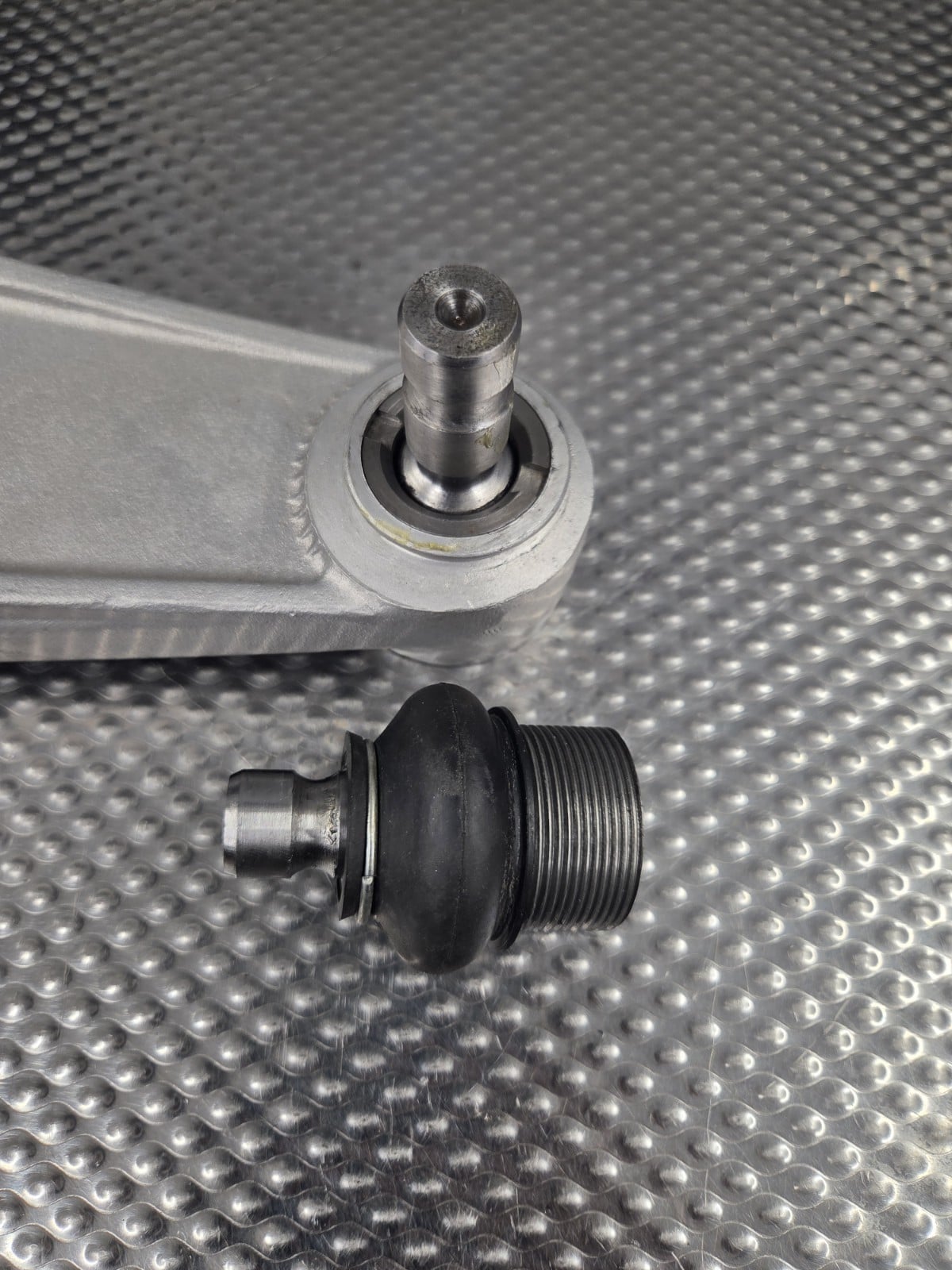

I will be replacing my lower arm ball joints at some point and whilst looking at the repair kits I found a place nearby that offer complete refurbish with a threaded type ball joint. Just wondering peoples opinions on this. A good price too where they will thread the arm, vapour blast and supply the ball joint. I like the idea of this.
- s-l1600.jpg (394.63 KiB) Viewed 50 times

How is the ball-joint secured in the arm? Loctite or staked? Get spare ball-joints while you are there.
New bushings in the control arms at the same time?

I have the same questions. It seems like a great idea, but it needs to stay put. It must have a stake or clip somewhere, right? Loctite is great, if you trust itdr bob wrote: Thu Jul 02, 2026 5:24 pm How is the ball-joint secured in the arm? Loctite or staked? Get spare ball-joints while you are there.

I saw that ball joint somewhere before and thought it was really nice. What place offers the service?
Good point about the locktite. Some of the threadlockers are designed to be semi-permanent.
I guess you don't want to use the rennbay rebuild kit because it doesn't address any possible wear to the aluminum cup in the arm?
