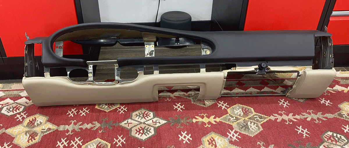

Well I pulled it out of storage and it looks pretty good. Other than the screws actually holding the dash to the frame, I honestly think I've removed all the little bits needed to remove the dash, at one point or another. I've just never did all that at once and, of course, never yanked the actual dash out. Seeing the leather one is helping to motivate me though. As lazy as I am, this doesn't 'feel' like a good job to farm out, insofar as it seems way too easy to cut corners, mix up screws, etc., etc. I also have a matching leather center console in the lower tan color, although I'm thinking it might be better in black in my interior.
This is how it looks right now....

I wish! But the truth is, this is the kind of project I can see working on in little spurts. Other than the final removal, it seems like a long/tedious collection of fairly discrete little tasks, removing one do-hickey after another until the dash can come out. I need to jockey cars around the garage so the 944 can sit a while as I chip away at it....

It is an easy job, it only takes times. IIRC there are no more than 6 bolts that actually hold the dash onto the shell. What takes time is the removal of all things attached to the dash, like the stuff around the steering column, the glove box, the radio, the gauges, the A/C control unit, the A-pillar covers, etc.

I've convinced myself that is true, and that I've done virtually all of it before in pieces, other than those last 4-6 bolts. My back has been showing it's age this last week, but as soon as that's back to normal, I'll dig in.... It's honestly one of the last major things I have not done on these cars...
