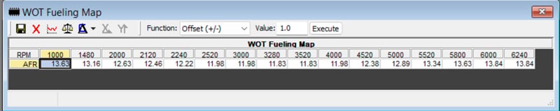

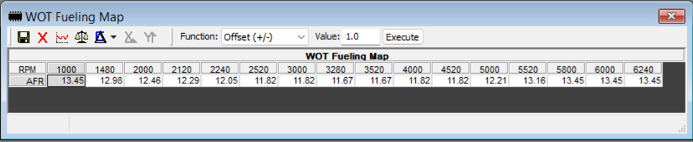

8. Full Throttle Fuel Maps
This is the map that attracts a lot of attention when ‘tuning.’ When running a 944 Turbo at 15 or 16psi, knocking (aka pinging, preignition, or detonation) is a critical concern. Gasoline consumes oxygen when it burns. At an AFR of 14.7:1, in theory, pump gas will have just the right number of oxygen molecules to burn all the gas, not too many, not too few. It’s also the sweet spot for minimizing the various emissions, so the car is designed to run at this AFR most of the time via its closed-loop O2 system. However, at full throttle the closed-loop system is turned off and tuners end up adding more fuel to the mix. The extra fuel helps cool the intake charge and makes it less prone to knocking. Up to a point, extra fuel also helps make more power. A good starting point is to shoot for about 11.8:1 at wide open throttle from the onset of boost all the way to redline, with little to no knock. Note that the factory let's the AFR lean out a bit on the top end, most likely mirroring the torque curve produced by the relatively small factory turbos.
The XDF maps are set up in theory so that you can enter your target AFR for each RPM range, but in practice there are too many variables for it to work with precision. Don’t expect to plug in 11.8:1 and necessarily see that on your wideband, especially if your motor is not stock. So use the numbers in the map as directionally correct, but don’t stress if you have to enter a 10.8 in the table to see 11.8 in practice. The only thing that matters is the AFR you see on your wideband. A little variation is ok, but don’t let it get much above 12 when on boost or you put your head gasket at risk. If you dip into the 10’s, you’ll be losing power and will eventually bog the motor. Here’s the factory Turbo, Turbo S, and a couple aftermarket maps for reference. The wide variation among the maps makes clear It's best to tune your car based on the actual wideband results -- not someone else's map!

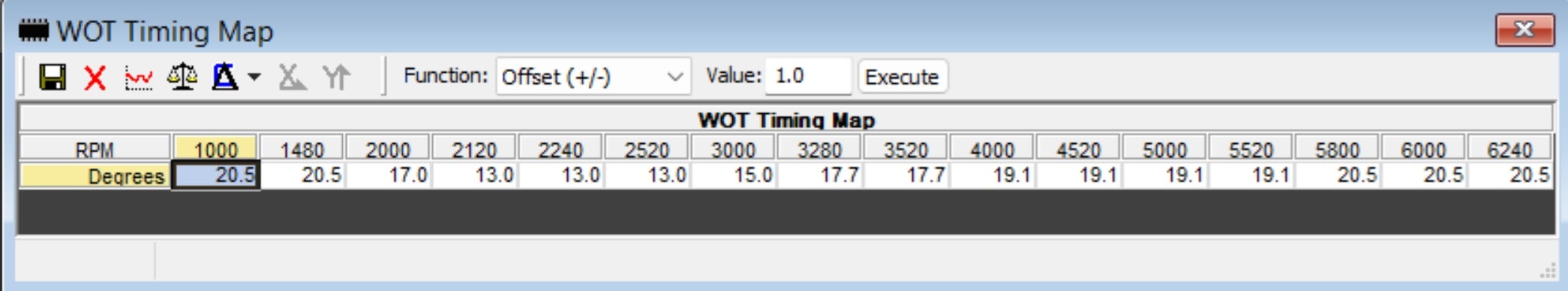

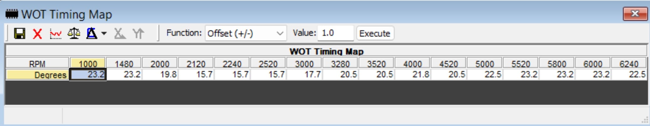

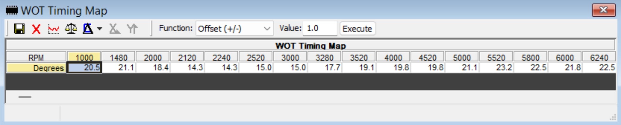

9. Full Throttle Timing Maps
Be very careful with these maps. Too much timing advance can cause excessive engine knock and blow a head gasket in very short order. Ask me how I know. If you venture into full throttle timing, work in very small increments and keep a close eye on your knock monitor. Fuel octane rating is important here too. West Coast 91 octane will ping sooner than East Coast 93. For reference, here is a stock ’86 full throttle timing map, compared to a Turbo S map and a typical performance chip map. I wouldn't try to add timing like the aftermarket chip unless you have the fuel/octane to support it and can tune on a dyno to see if the extra timing is actually yielding any extra power. Sometimes chasing an extra 2 horsepower isn't worth the risk.

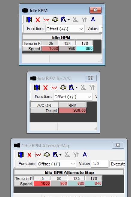

10. Idle Speed Maps
While maybe not the most exciting, a solid idle can add significantly to the overall manners of a car. If you have an aftermarket camshaft or other changes that would benefit from a faster idle, we have you covered. The idle speed adjustment is a Carpokes exclusive, thanks to some very smart Carpokeans who were able to help pinpoint the code logic and location of the idle speed maps. Thank you johnb and Dave W! The main idle speed table has 3 cells tied to engine temps, and the XDF allows you to set the RPM for each of the three heat ranges. The XDF posted below contains a second idle control map you can try if the primary map does not affect idle speed. We discovered in the process of uncovering the correct 3-cell idle map location that there is at least one other potential map location that might come in to play on some cars. Without getting into the details here, if you have a Focus 9 Tech DME or any car where the wire to PIN 28 of the DME was previously cut to install a map sensor, the alternate 4-cell idle map may control. If so, be aware the A/C idle map will not work. If you ground DME Pin 28 (like the factory did) and/or talk to F9-Tech about making that change in its DME, you should be able to use the primary 3-cell map and the A/C idle control map.
If you opt to set a different idle speed when the A/C is on, just be aware that the rpm you enter only controls when the compressor is on, so when the compressor cycles on and off, the rpm will cycle between the A/C idle rpm and the standard idle RPM. As such, you may want to avoid making the A/C idle significantly faster than the standard idle.
