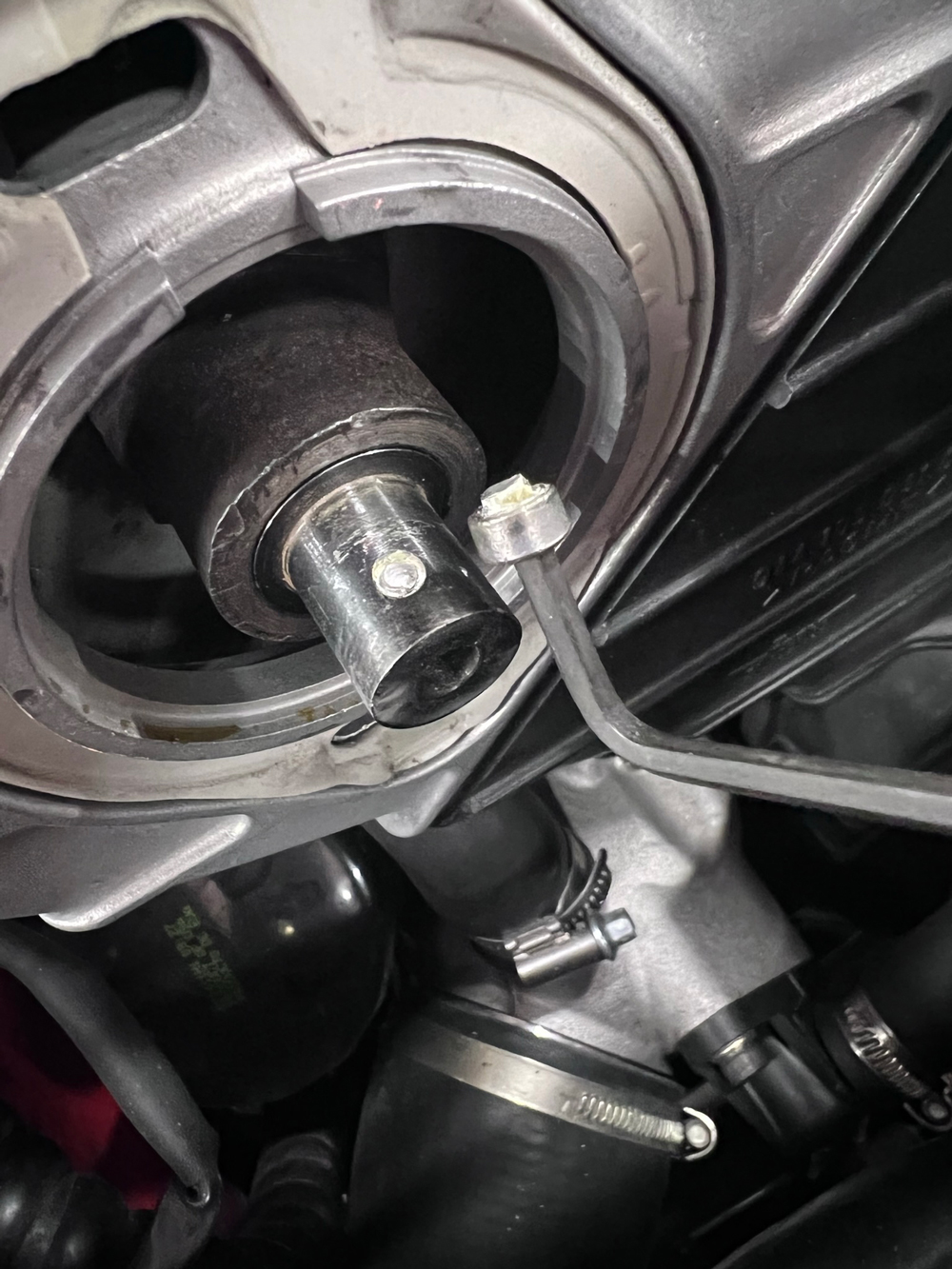

Doing my bi-annual tune-up to prepare for smog and this happened. The head snapped with almost no force. I suppose I should be happy it snap while driving and start spinning the rotor. Fortunately, since I hoard 944 parts, I had another extension piece handy, but needless to say I had to drop the little M5 screw for it down into the timing belt abyss TWICE before getting the little jerk to thread. As for the broken bolt, there was a time when I'd feel compelled to get just the perfect Porsche bolt, but those days have passed. 12.9 M4x10 bolt from the hardware store will do just fine, and hopefully take longer to petrify than this one did....

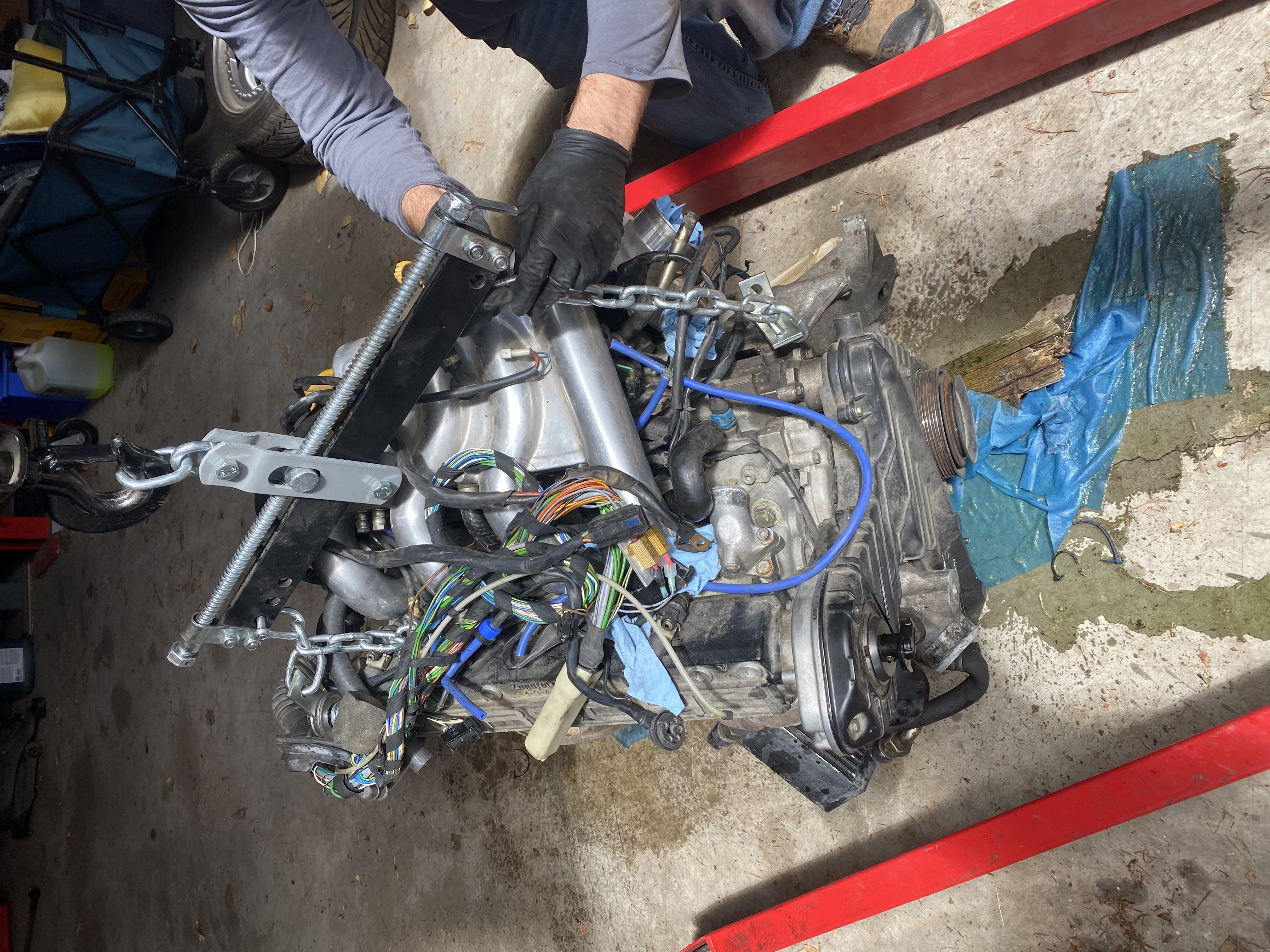

I have sprayed the hell out of that on this engine with WD40.
It’s still soaking until I get back to Soloracer’s shop
It’s been a pain on every car I have worked on my with them sitting so long.
Going to try heat gun when I get to trying to remove it.

Doyle623 wrote: Tue Aug 16, 2022 2:29 pm After 20+ years of ownership, I've come to expect this :D I have become a skilled bolt extractor though!
I change the rotor every 2 years for smog (almost a superstition), so really didn't see that one coming. I guess I've been using the same little bolt every time and it finally had enough.... When I have free time, I'll see if I can salvage that extension.
