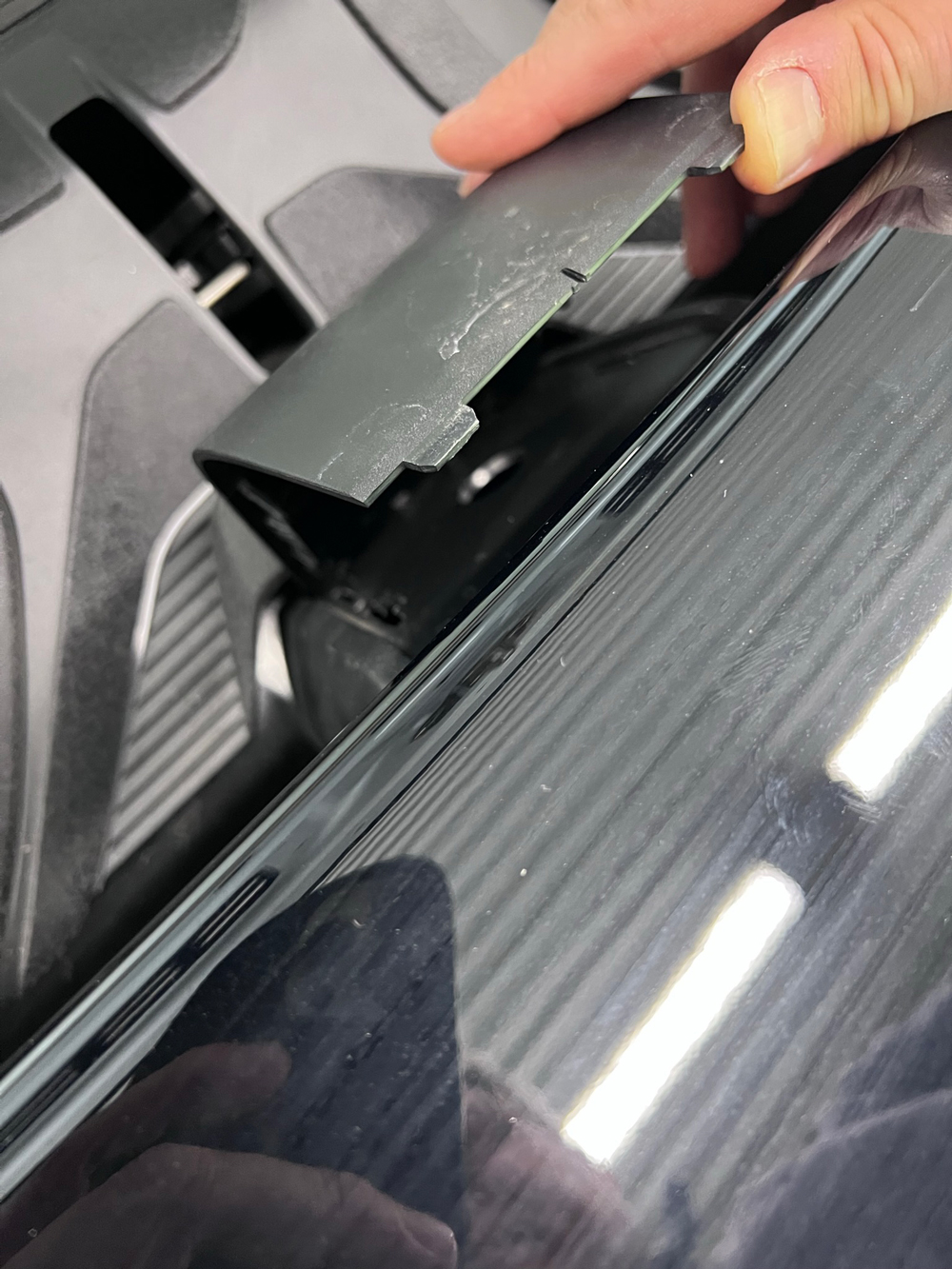

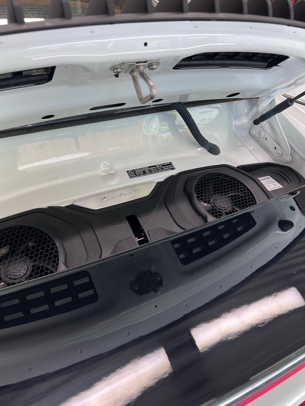

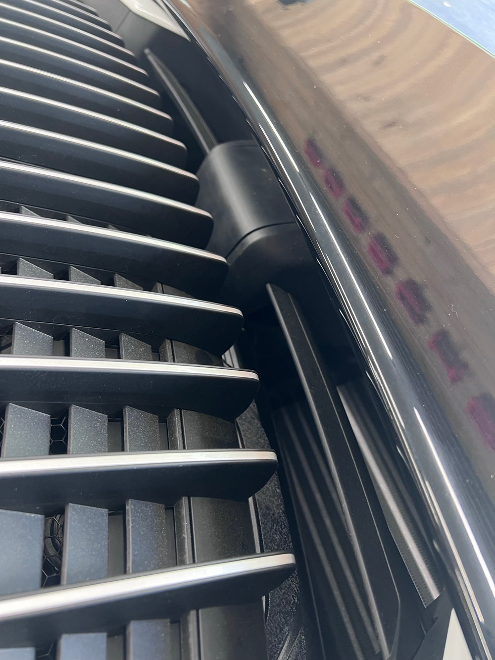

I doubt these pictures help much other than to highlight the problem. There is a flexible panel right behind the latch with a hole underneath. On my car you can get the panel dislodged even with the lid closed, but I didn't find anything under there that would open the lid. There was a rubber nub that felt like it might be a push button, but it didn't do anything on my car, so maybe just the something is contoured underneath. I have to believe Porsche has some provision for a failed solenoid. I just read that on the 2023 corvette, they eliminated the manual key latch, and they actually put out a TSB saying to use a 3 inch hole saw on the body to get at the latch if the solenoid stops working :shock:

Tom wrote: Sun Aug 14, 2022 4:50 pm I doubt these pictures help much other than to highlight the problem. There is a flexible panel right behind the latch with a hole underneath. On my car you can get the panel dislodged even with the lid closed, but I didn't find anything under there that would open the lid. There was a rubber nub that felt like it might be a push button, but it didn't do anything on my car, so maybe just the something is contoured underneath. I have to believe Porsche has some provision for a failed solenoid. I just read that on the 2023 corvette, they eliminated the manual key latch, and they actually put out a TSB saying to use a 3 inch hole saw on the body to get at the latch if the solenoid stops working :shock:
OMG! at this point I wouldn't be surprised if Porsche didn't have something, but I hope they do. I think that panel is on turbo only as I don't have that. I sure appreciate you doing that for me though! I remember a small cable with ball at the end (with is what the design is) coming right out of the solenoid, only about 5-6in long, But that seems really odd that would be the location of the emergency one, right beside the actual device, with nowhere easy to reach it.

Glad it's behind you, and even happier to hear you didn't have to use a 3 inch hole saw like the corvette!! Any idea what path they took? When I was looking at mine, I was a bit stumped as to how to get in there. The black grills on mine look like they could probably be pried off from the top to gain some access. They are held in place with plastic push-pin thingies, but it seems like that might get destructive fast, although maybe you could get under enough of them with the tail lights removed -- couldn't really tell. At any rate, it would be great info if you knew what parts they took off to get in there. $513 suggests it took them a while.....
