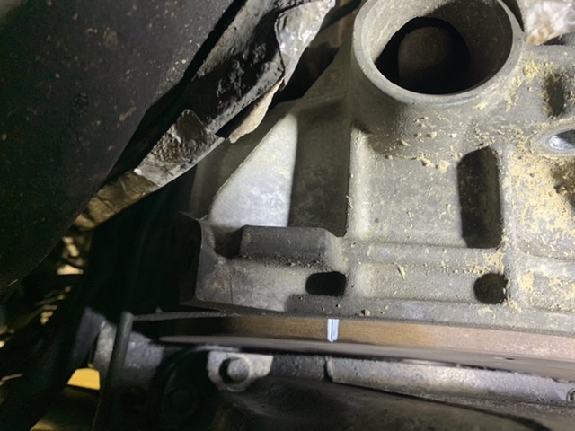

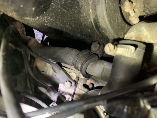

Yes I was looking from the top in the inspection hole by the speed/reference sensors. (Photo atta he’s, but not in focus enough to see the small line)
And ya too late I had already turned the crank without the belts on. I did not feel any heavy resistance.
I checked again with the help of my 9 year old, and from the passenger side looking into the TDC hole I saw the finest scribe, which mates with my mark I had on the crank and confirmed with the #1 cylinder at TDC.

My strong suspicion is that you have a factory flywheel and that the surface rust on the outer edge is making the OT and line difficult to see. There is a rumor that they made the marks deeper on the later flywheels for that reason, though I can't confirm that. I can't really tell from those pictures if you are aligned, and that bottom line does not seem to look like the notch people generally use - see Clark's below.
