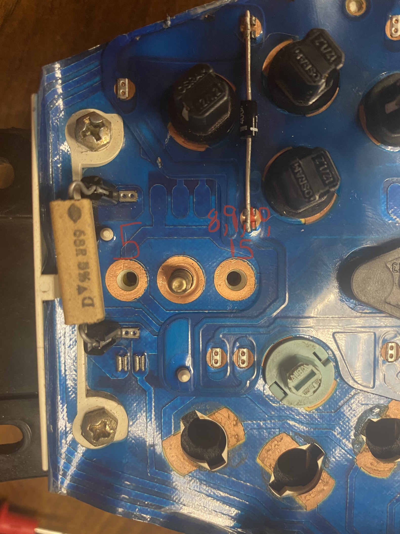

When I do a continuity check, this is where I get continuity. This is the back of the voltage gauge. Im guessing the right trace is what feeds through the various indicator lights.
When I reinstall the “football” connector, the center post has continuity with all of those pins (5,8,9,10, and 15)

Yep! All are pins on the membrane that correspond to connector A.
I just checked the coolant temp gauge and I have continuity between pins 12 and 3 on connector C on the membrane. According to the schematic, pin 3 on connector C is for the fuel economy gauge?

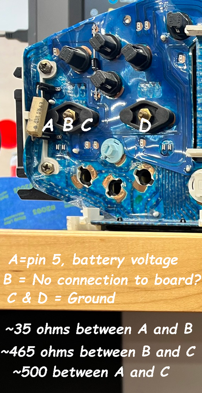

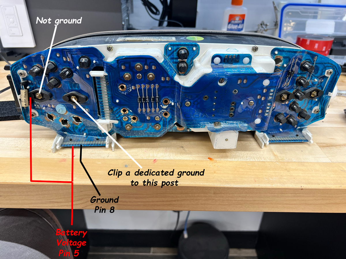

Didn't have as much time as I wanted today, so only looked at the volt meter side. See pictures below, but the bottom line is Connector C, Pin 5 is the input for the battery voltage. When you ohmed that out to ground, you were seeing exactly the internal resistance of the voltage gauge (suggesting it should be working). To drive the gauge on the bench, I put a voltage supply on Pin 5 and ground on Pin 8, using a variable voltage supply, and the gauge read exactly the same as the voltage supply.
To test if you have a bad ground to the gauge, run a dedicated ground wire from the center nut on the football behind the OIL PPRESSURE gauge (not the volt gauge). Absent an internal flaw on the blue circuit board, that will give the volt gauge a clean ground. If that fixes the low reading, then I'd take the football off and make sure contact C in my picture below ohms out to Pin 8. If so, then the ground to the bezel on Pin 8 isn't clean.
If the dedicated ground doesn't fix it, then I would put a multimeter in Pin 5 (+) and Pin 8 (-) on the harness side of the connector, with the ignition on, and see what voltage reading you get. If it's low like the dash gauge, and Pin 8 ohms out to ground, then that leaves only the power supply on Pin 5, which is internally connected to battery positive via a 'weld joint' inside the harness.
