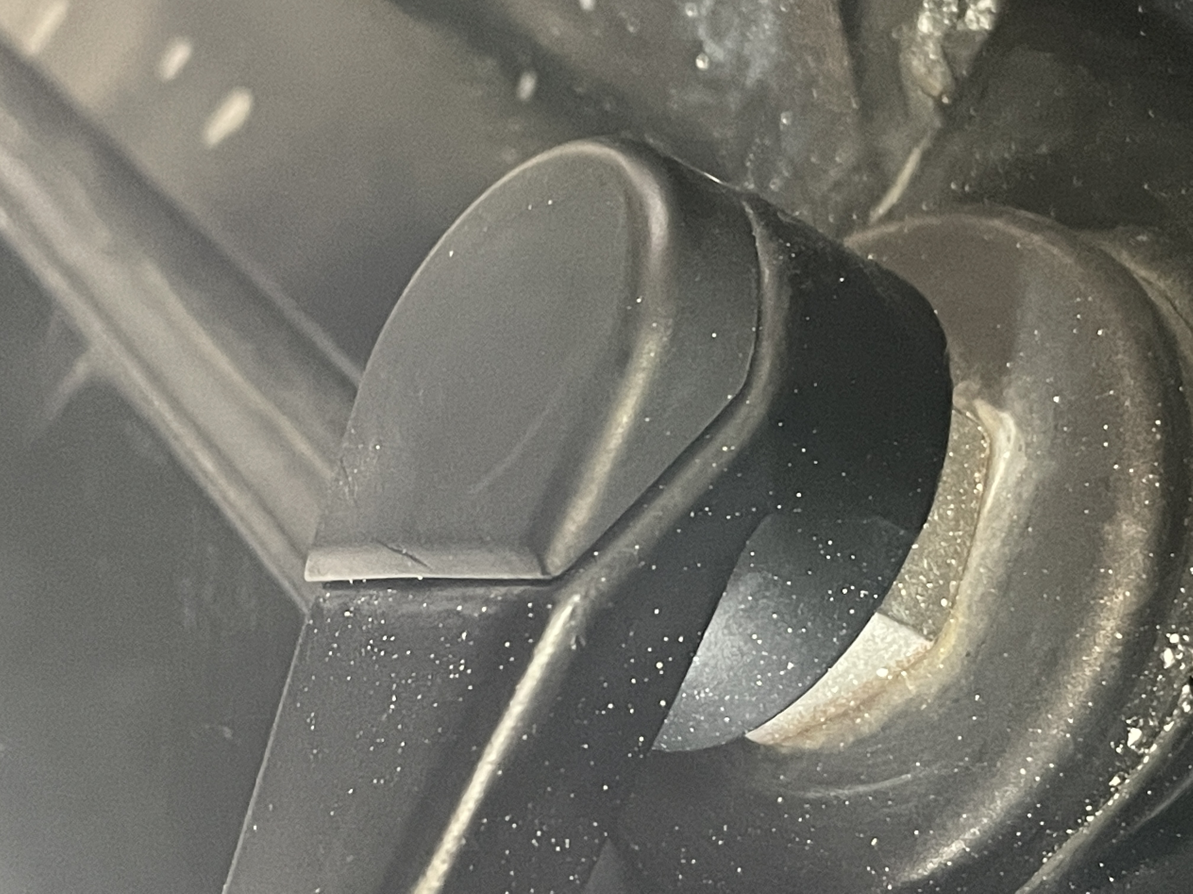

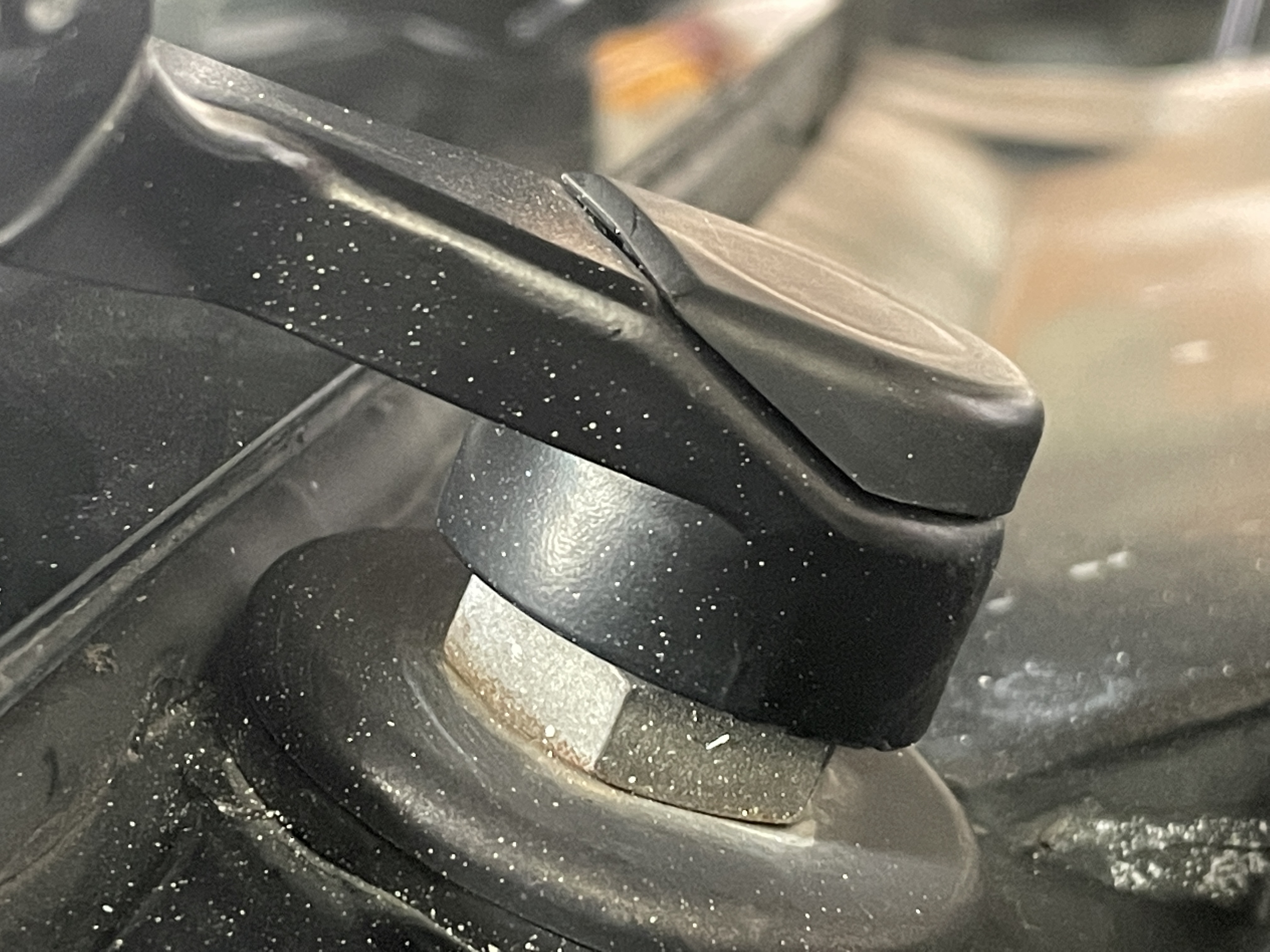

It looks like my S2 has the same caps as pictured on the first post. Please excuse the general dirtiness and overspray from a (bad) respray by the PO.

That's super helpful, thank you! In that first picture, I assume you could push the cap down a bit so it sits more like the second picture? Either way, these pictures confirm what I suspected -- that the cap does not sit flush against the arm across the straight edge....

Correct, the first picture should look like the second, I just wasn't able to do it with the angle/leverage I had. From the original picture, that little tab on the cover should sit in that cast slot on the arm, so it may also be that I have some gunk in that arm that I need to clean out.

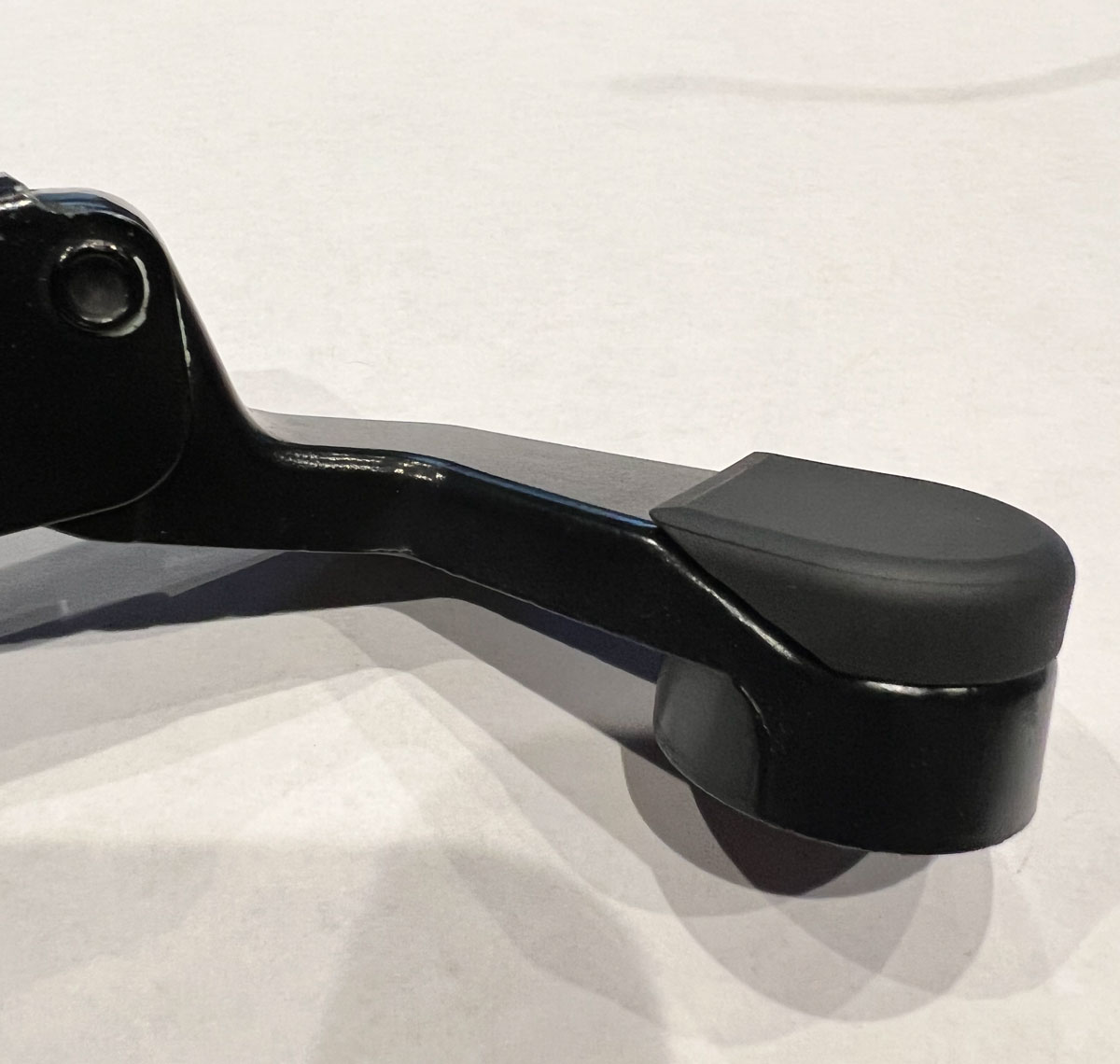

Here's my first pass...

I agree that they look really nice already, on your Rev 0.
That's some nice resolution you have there, or did you work on the part a little after printing?

Zirconocene wrote: Mon Jul 11, 2022 10:58 am I agree that they look really nice already, on your Rev 0.
ETA Random idea: Can you incorporate a little Porsche crest? It seems like it would fit there very nicely.
That's the beauty of resin printers. It prints at about 1/20mm per layer, so most parts come out looking smooth as a molded part. That one wasn't sanded or anything, but I did hit it with black primer to get the best visual on the arm. I think this version is just a little bit too tall. I just reduced it a mm and am going to print again. I like the Porsche crest idea. I'd just need to find something I could incorporate into the model without trying to draw it myself...
