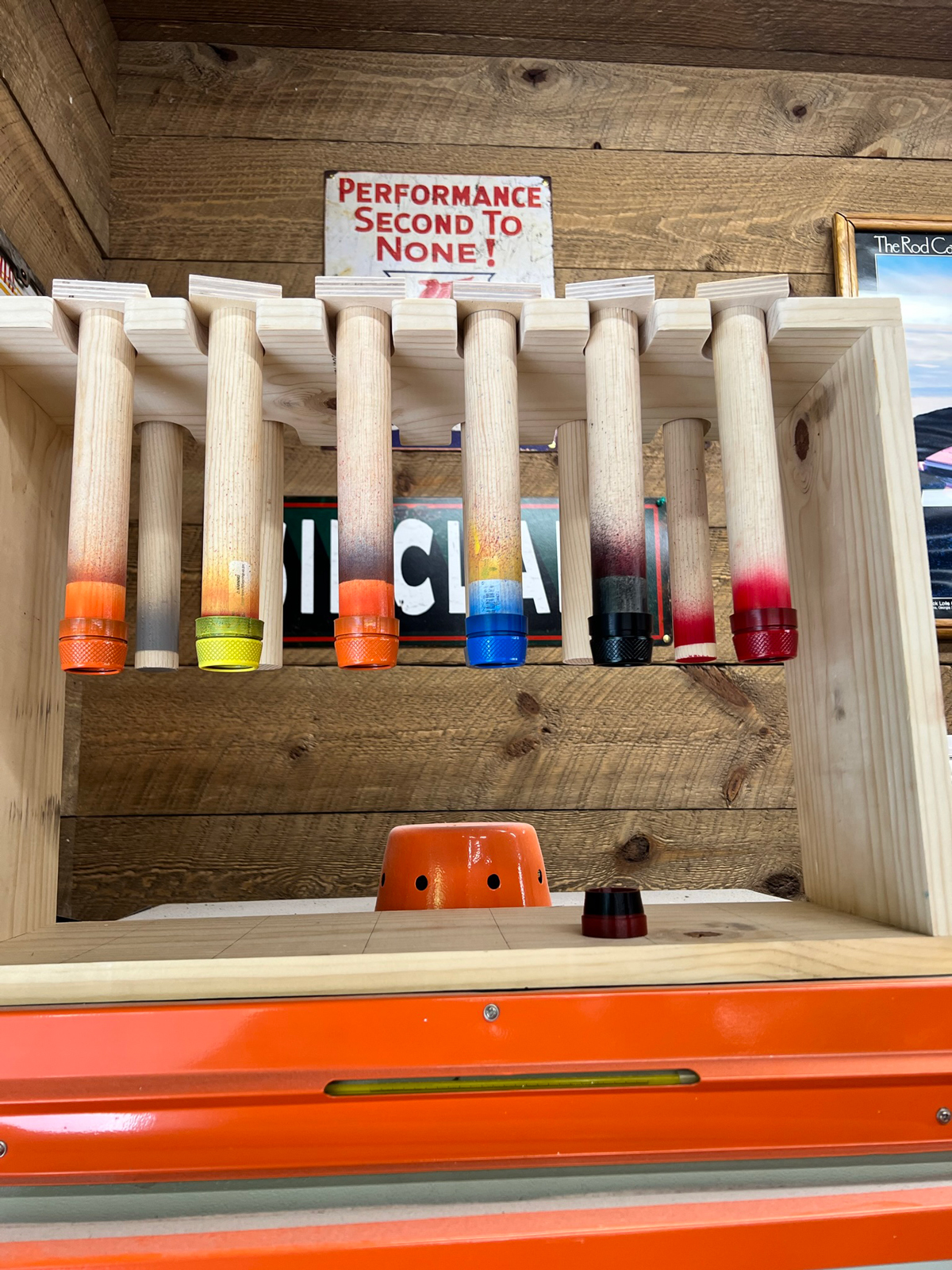

For the Mode Dial covers, I get a shinier/smoother top ring if I let them dry upside down after painting. I previously had a super inefficient means of doing that, so built this painting and drying station...

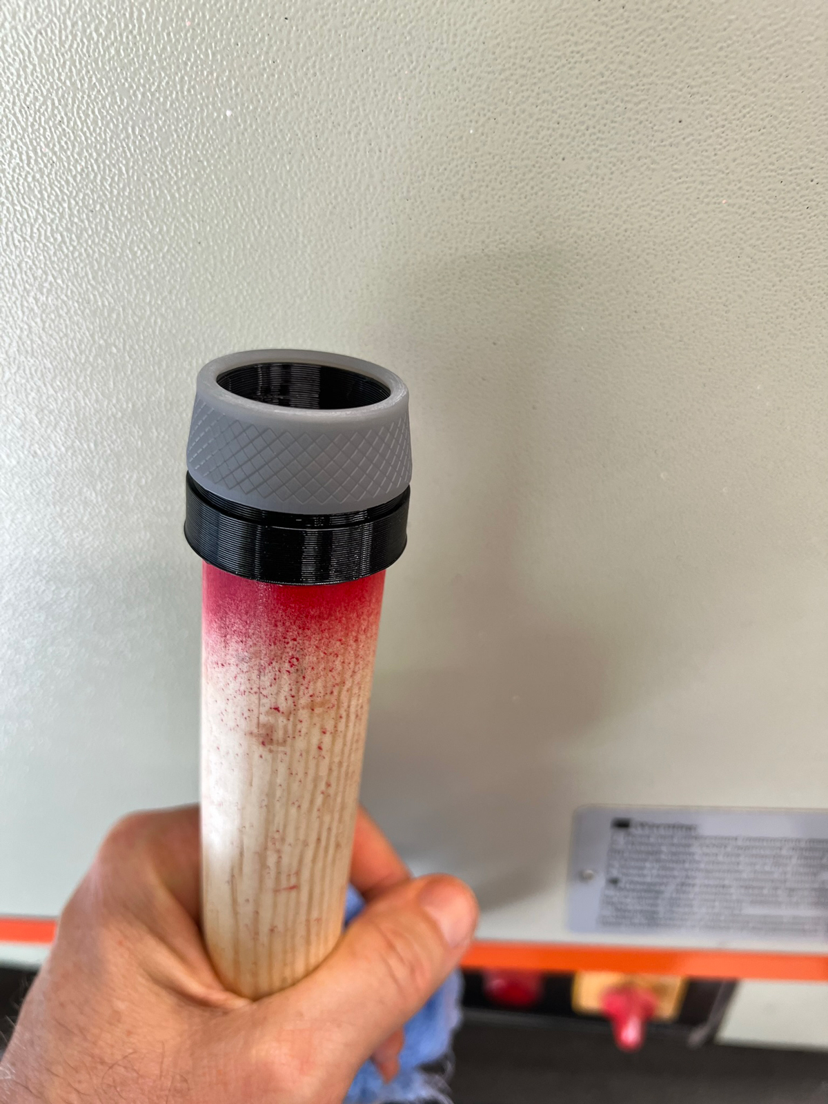

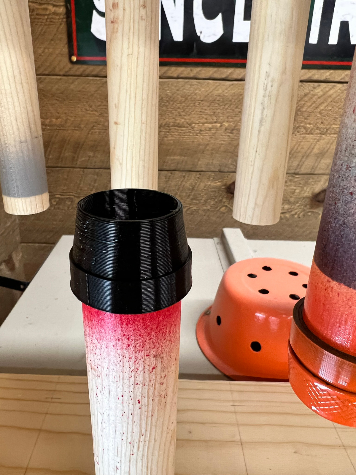

I 3D printed these mounting pieces for the ends of the painting dowels. They are printed in a rubbery material (ninjaflex) and make a perfect paint stand for the Mode Dial covers.
In addition to holding the part, the mounting pieces effectively masks the inside of the cover and do a much better job of masking than the painters tape I was tediously applying to each one in the past. :)

Now why in the world do they dry shinier upside down? And whatever prompted you to try it? Thanks again for the mode switch cover, this reminded me I've got to pay you for the shipping. And I'm considering a chrono bezel to match the mode switch. Decisions, decisions....

I starting hanging bezels upside down to dry with the base coat of the two-part paints, because it’s very runny and would constantly thin out over the upper edge/ridge if the bezels, and the plastic would show through. I kept adding more coats trying get it to cover fully, which caused other issues when I put the clear over it. One day I just flipped the wet part upside down so the paint would flow down over the upper ridge, and that did the trick finally. I then tried the same thing with the thicker single stage paints like Rustoleum, and discovered that it helps with the shine because of the same reason. Instead of the paint flowing down and showing any imperfections in the top ring, this way it gets thicker and forms a glass-like surface — essentially giving that wet paint look even after it dries. :)
