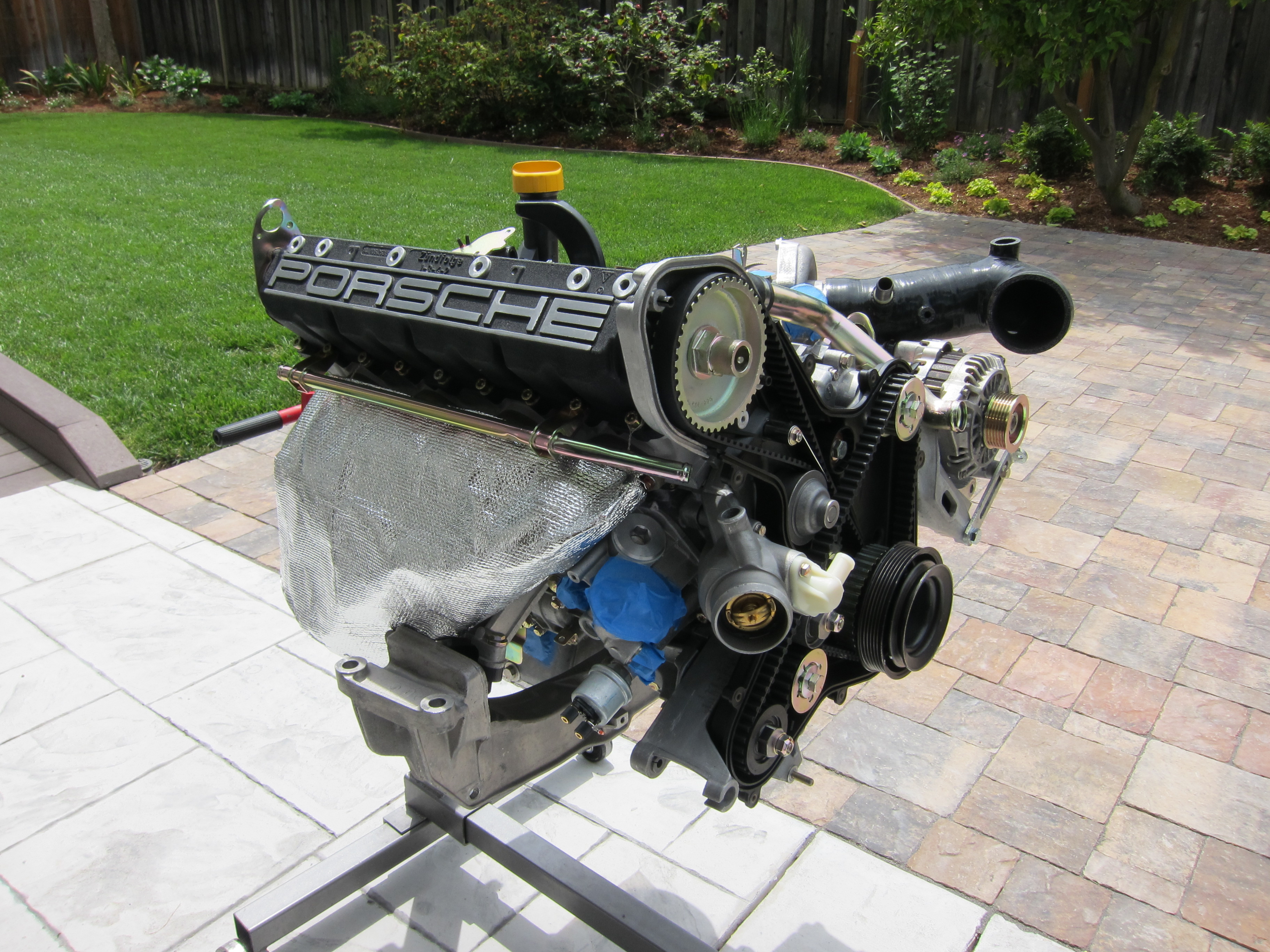

I’ve been imagining this for a while and finally got it in the car. It’s a simple 6x18” sheet of thin aluminum I got at Lowes for $13, so definitely nothing fancy. One straight bend and a lot of hand forming, especially on the rear edge. Any input/suggestions welcome!

Interesting. Looks like its not supported on the outboard side. Given that its aluminum, any concerns for cracking at the mount points?
I took a slightly different approach with a heat blanket:

Dare wrote: Wed Jun 22, 2022 8:25 pm Interesting. Looks like its not supported on the outboard side. Given that its aluminum, any concerns for cracking at the mount points?
Good point about it cracking, and no it’s not supported on the outboard side. I guess time will tell how well it holds up. I like the heat blanket idea! Much easier to handle than a rigid sheet of aluminum

Yup, I looked at that before making mine. As I understand it, the OE shield on AT cars is there to keep the ATF lines cool rather than protect the whole area from the headers. I wanted to keep the fuel lines cooler and also channel any leaking fuel away from the headers
