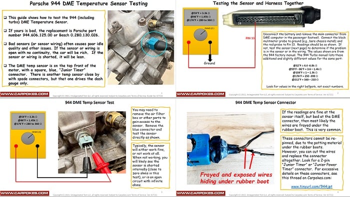

Attached is a 4-page pdf showing how to test the DME temp sensor on a 944 or 944 Turbo.

Thank you for this! I know my harness is messed up on mine making it the main issues for my misfire just waiting for the new harnesses to come in but I’m going to use this to test my actual sensor tomorrow! 🙂
