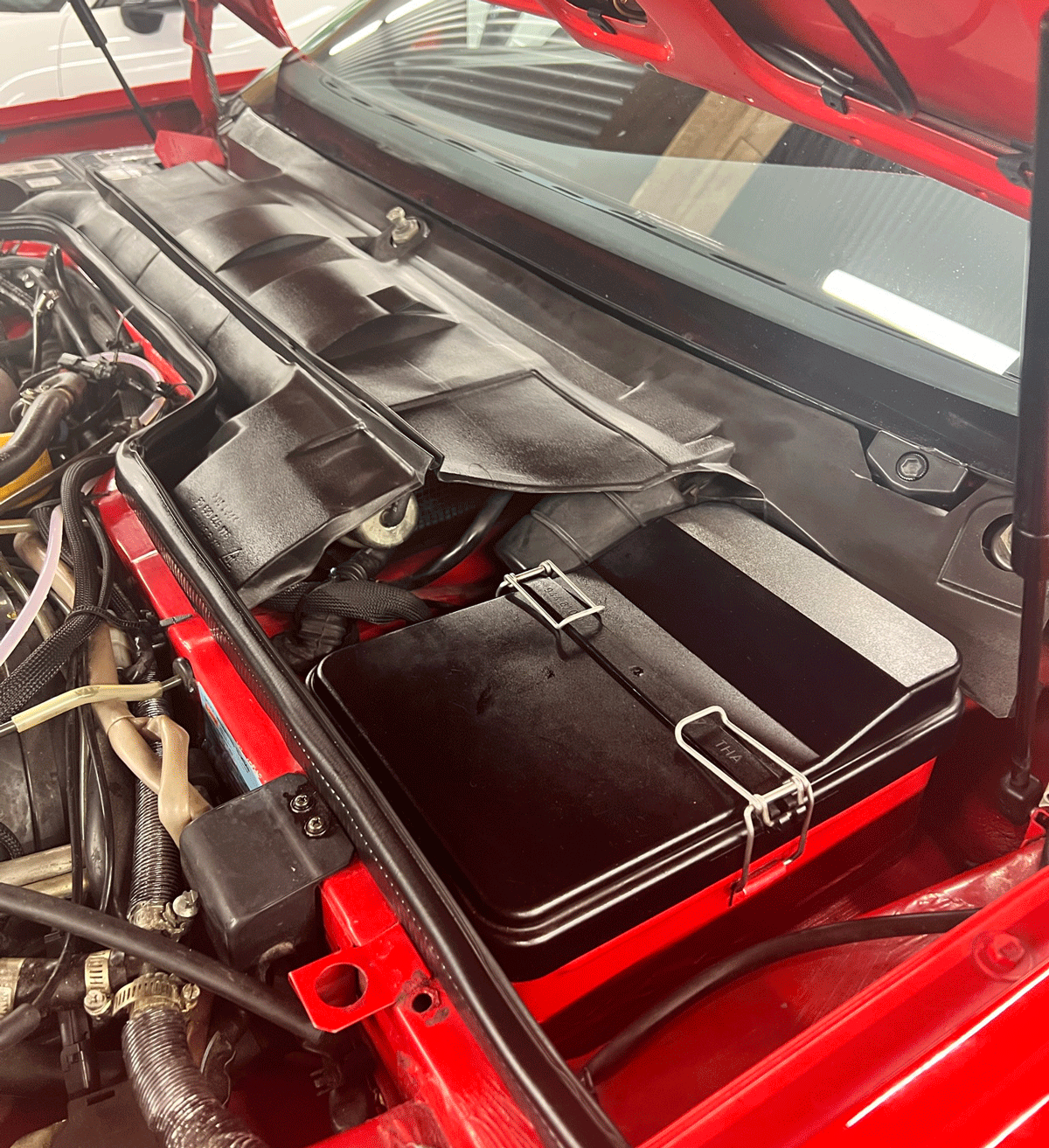

In the meantime, the cowl area of my car has never looked better after pulling it apart and cleaning (and a helping of Griot's Black Satin). I need to print some windshield washer nut covers though...
