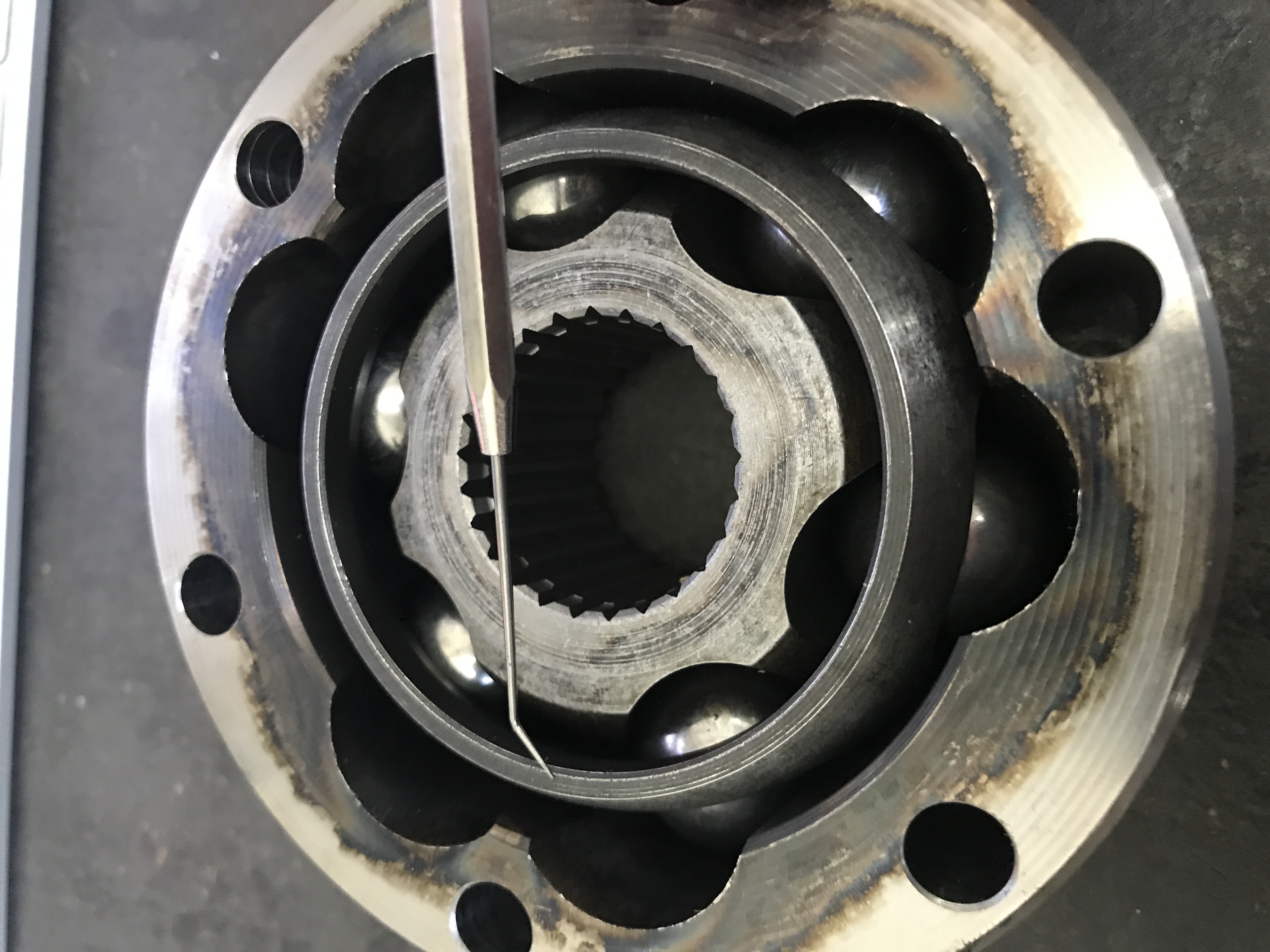

A picture might help, as I'm not 100% sure which chamfer you mean? When I did mine, I noticed the little ridge, as shown in the pictures below. I can't remember how I concluded which side was which, but remember obsessing on it enough to call the manufacturer, who said it didn't matter, and then finding 'something' compelling to conclude it's best to install them like this:

What brand are the CB joint you bought? I've been looking at various pics on the internet and they do seem to differ from Lobro vs. Empi etc. If in doubt, I'd look at replacement axle assemblies from the same make and do yours the way they sell them. That said, as long as you follow the basics and the joint moves freely after assembly, I think a lot of the internet advice is (1) hard to validate, and (2) intended to pick up an extra degree of movement here and there but not all that important really. When I called EMPI that time and asked, the product service engineer guy basically rolled his eyes over the phone and said none of those subtleties really mattered as long as it articulates after assembly.

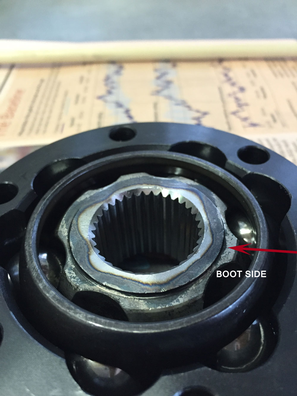

Here are some pictures to show what I was trying to describe.
Here is the bevel I mentioned.
Here is the flip side without the bevel.
Here is a photo with three grooves which face either the hub or the diff, basically the outer ends of the axle. The bevel face of the cage is on this side.
Here is the single groove that faces the axle, basically towards the center of the axle. The non beveled face of the cage is on this side.
Finally, here is the part number from the new CV. Maybe a bit hard to read.
But I agree with your assessment that there will be little difference from a functional standpoint so I'm going with the three rings out and thus the bevel out which is what the car had when I purchased.

On the "flip side without the bezel," the splines are chamfered to help it slide on to the axles, so to me that would be the inboard side. Can't quite tell from those pictures if that's your plan....?

I hadn't noticed the chamfer on the splines but you a correct. The spline chamfer side will go inboard.

The three rings face outward from the axle or away from the center.

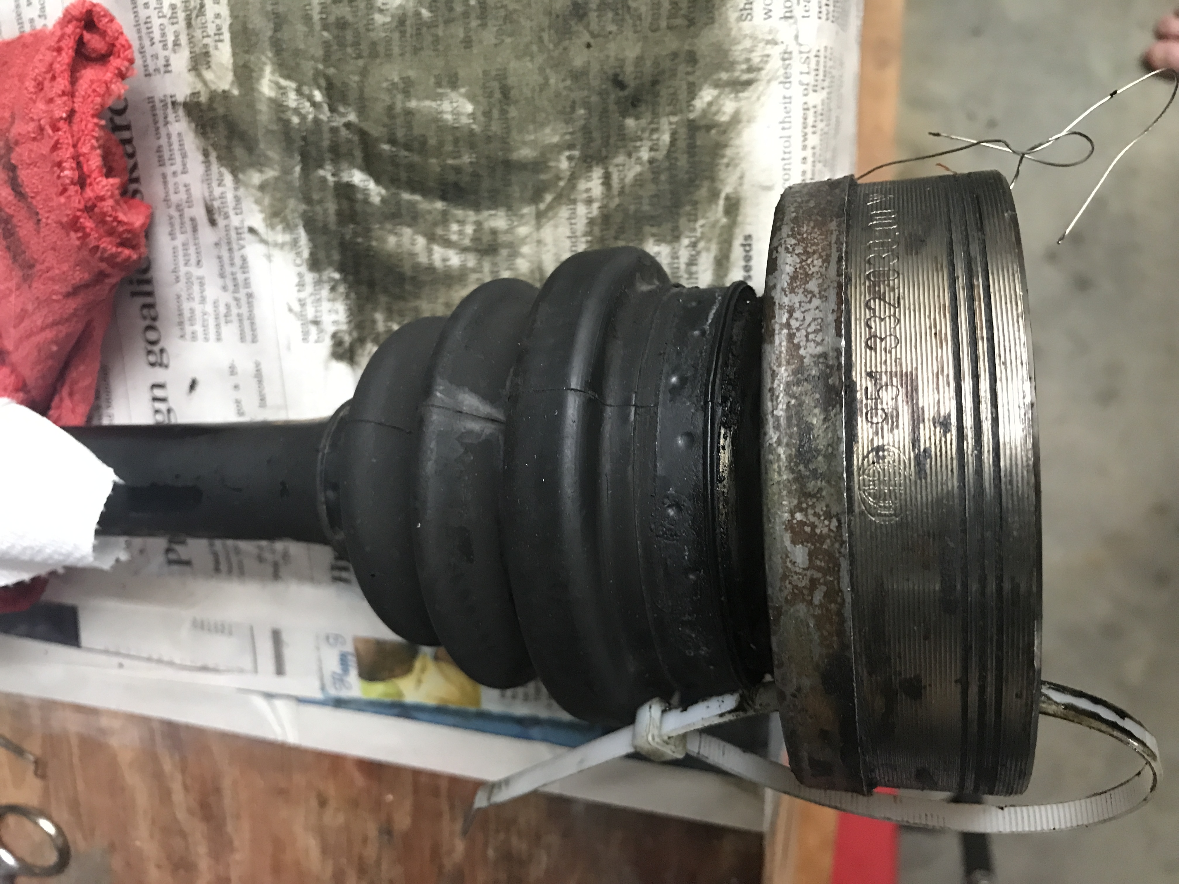

Here is a photo of what I believe to be the original CV before removal.
