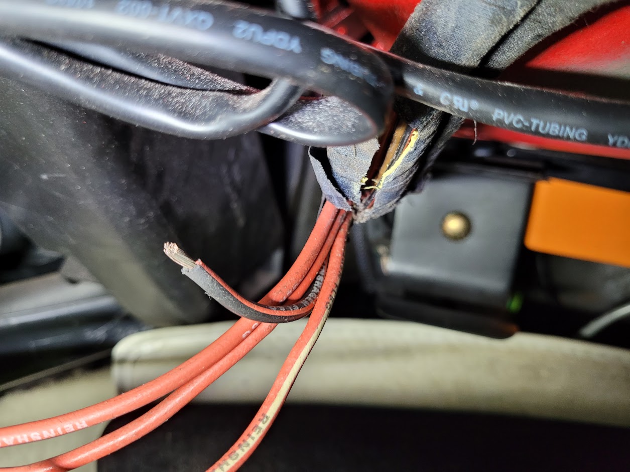

Unfortunately, when I snipped the resistor wires back, they were still in bad shape no matter how far back I went. I cut them back as close as I dared to where the harness merges and disappears behind the dash, but there was still a lot of that greenish mold. So I cleaned them up as best I could and crimped on new wires and connectors. I cleaned up the tabs on the resistors, and now the fans are working now at low speed. But next time I pull the dash I think I'll replace all that
wire.
This is what they looked like even after taking 8 or 10 inches off the end:

Sorry to see those wires have the dreaded green creeping death going on where the copper strand core corrodes even though it is still inside the wire insulation sheath. Usually you will just keep chasing it further and further into the harness and never find good clean wire. Hopefully you can get a decent enough connection to your new wire that it will work, but eventually the original corroded wire will turn to green dust and the only real way to fix it is to replace the harness with a new one. :(

355 wrote: Mon May 23, 2022 11:49 am Sorry to see those wires have the dreaded green creeping death going on where the copper strand core corrodes even though it is still inside the wire insulation sheath. Usually you will just keep chasing it further and further into the harness and never find good clean wire. Hopefully you can get a decent enough connection to your new wire that it will work, but eventually the original corroded wire will turn to green dust and the only real way to fix it is to replace the harness with a new one. :(
Yeah when I saw this I started thinking about my engine harness too. I think there's a Kroon engine harness in my near future. It won't include these resistor wires but the the temporary fix is ok for now until I pull the dash and do it properly.

As far as the fan wiring, I had the same issue on my '86, only difference is the resistor pack is under the dash. Mine was corroded from the relay in the fuse block as well as on the fan end. I repinned the fuse block with new wires, cut the dead ones and left them in the harness, and just ran new wire all the way to the resistors. There was no pulling the old wires out unless I removed the HVAC box (not happening...).
