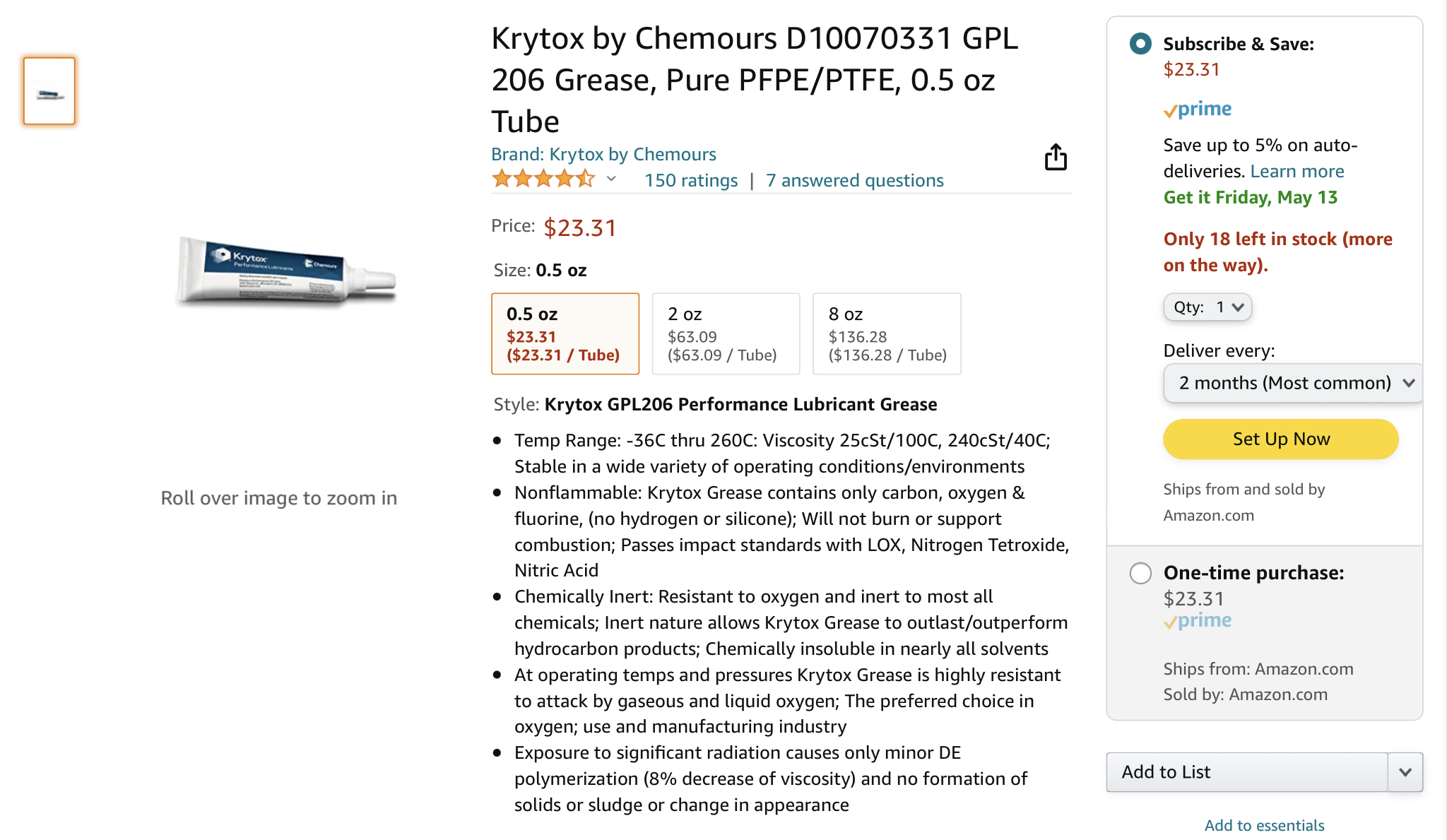

In all the chaos surrounding my recent fuel line leak, I forgot to post this. My rear hatch has rattled and creaked for years, despite new clasps, rubber receivers, adjusting many times, etc. I assumed it was mostly the glass separating from the frame, but I figured no harm trying Krytox to see if it would help. This stuff is incredible. I put it on the weather stripping and paint all around the full length of the hatch opening and all around the pins/clasp area -- anything that touches something else when the hatch closes. The results were just amazing. Zero noise from the hatch, despite the glass delaminating. Can't recommend this stuff enough.
Krytox comes in a little tiny tube, but it goes a very long way since you need very little for it to work -- think greasy fingers leaving a smudge. It's designed to work on virtually all car surfaces too without staining or damaging --paint, rubber, leather, vinyl, etc. I got my little tube from the tech at my Porsche dealer (when chasing rattles on my 991) but you can get it on Amazon, etc. My dealer used GPL 206 in a gel, but there quite a few types to choose from. This stuff is worth its weight in gold for those who hate squeaks, creaks, and rattles. That is all. :)
