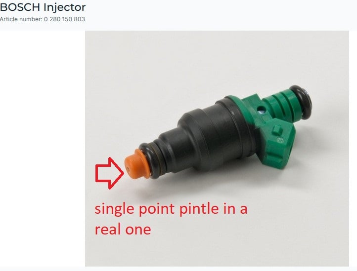

Went thru this a while ago...Have been looking at Delphi FJ10475 same resistance as ours, but higher flow. So duty cycle has to be adjusted. Make sure they are real Delphi rather then the "Herreko ".
Pics of fake vs. real.
Sox
Real injector
Fake injecter (5).jpg (63.46 KiB) Viewed 253 times
Fake
Fake injecter (2).jpg (335.81 KiB) Viewed 253 times
Real
Fake injecter (4).jpg (50.4 KiB) Viewed 253 times
Fake
Fake injecter (6).jpg (340.98 KiB) Viewed 253 times
