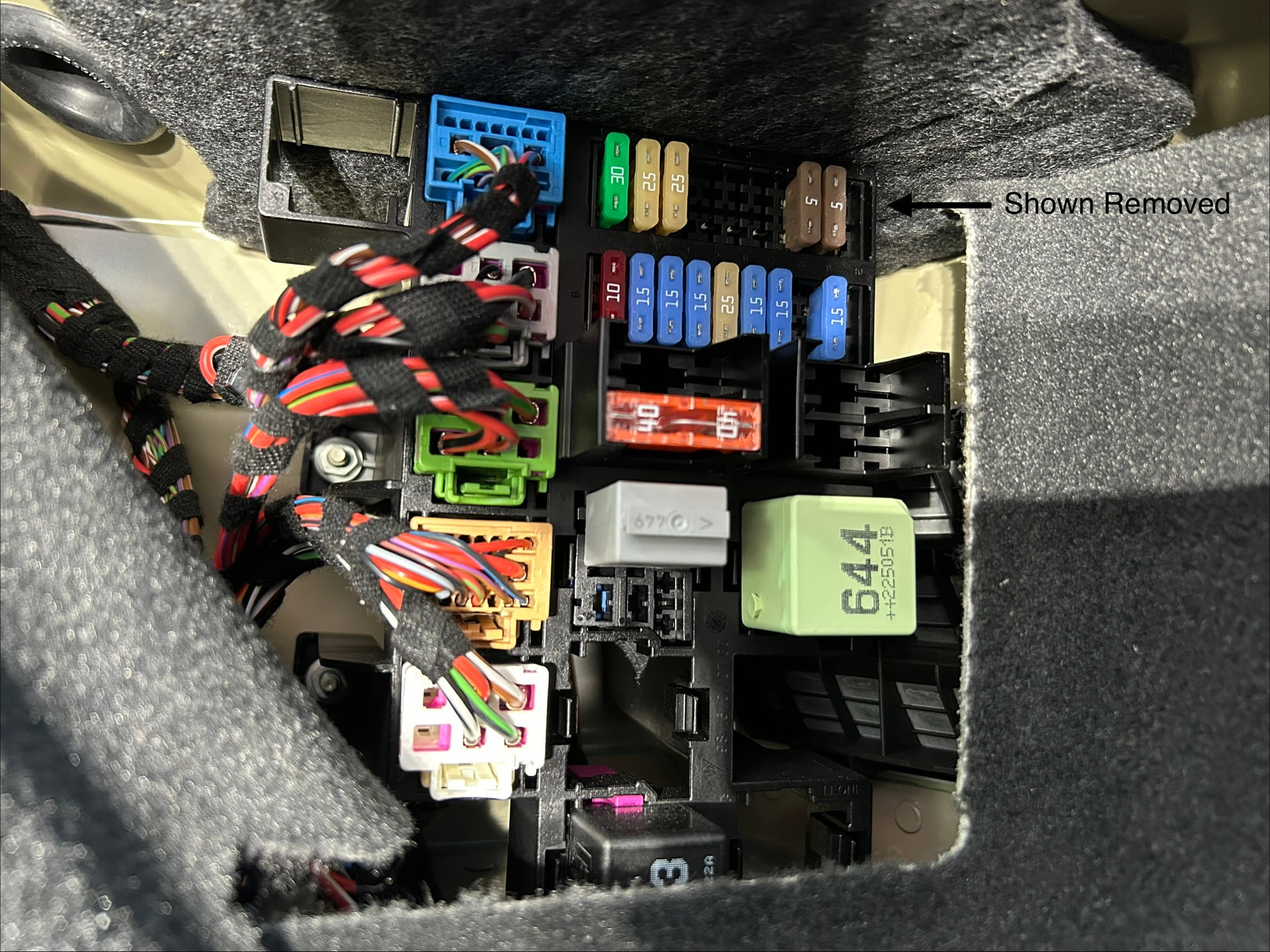

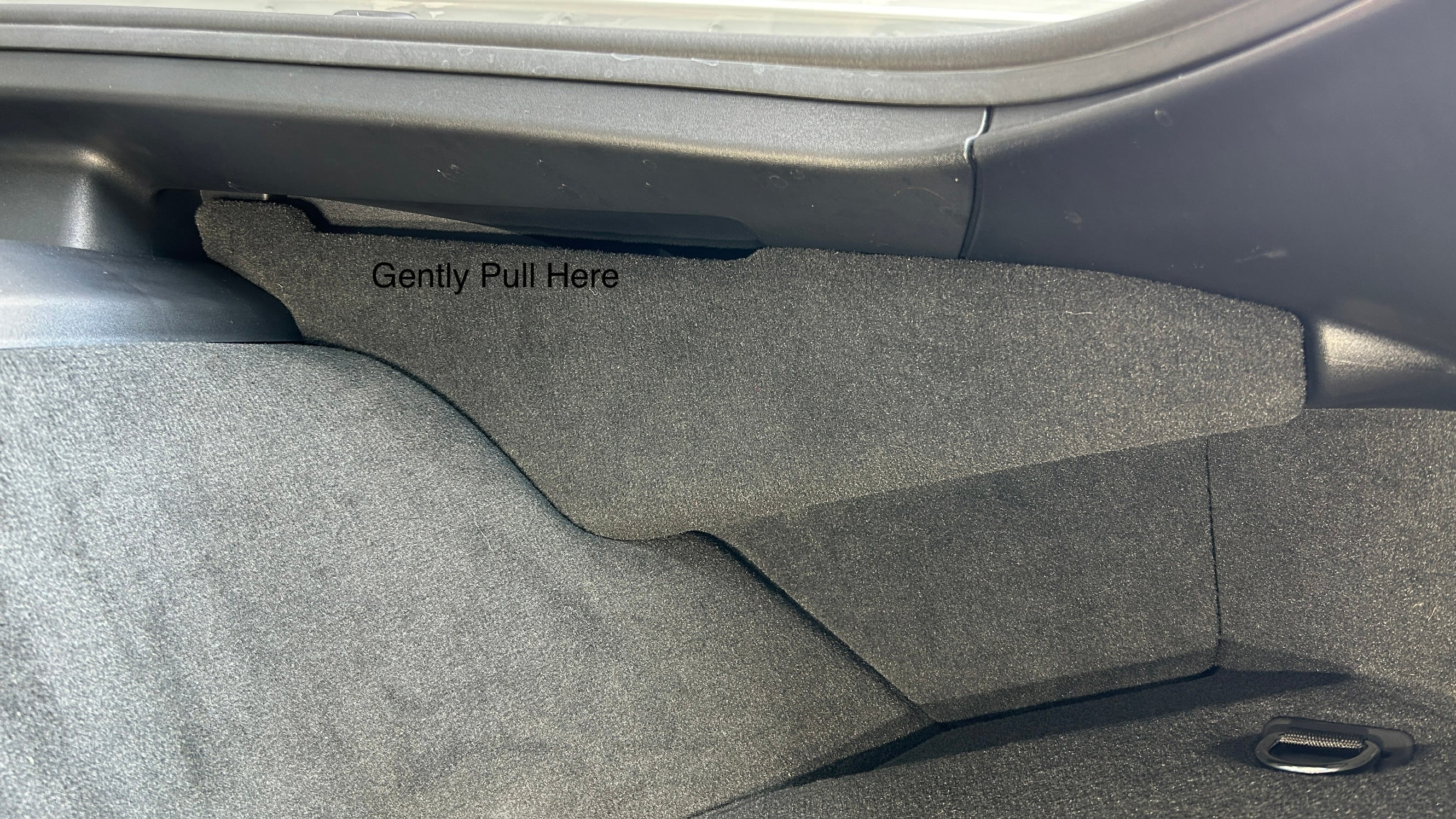

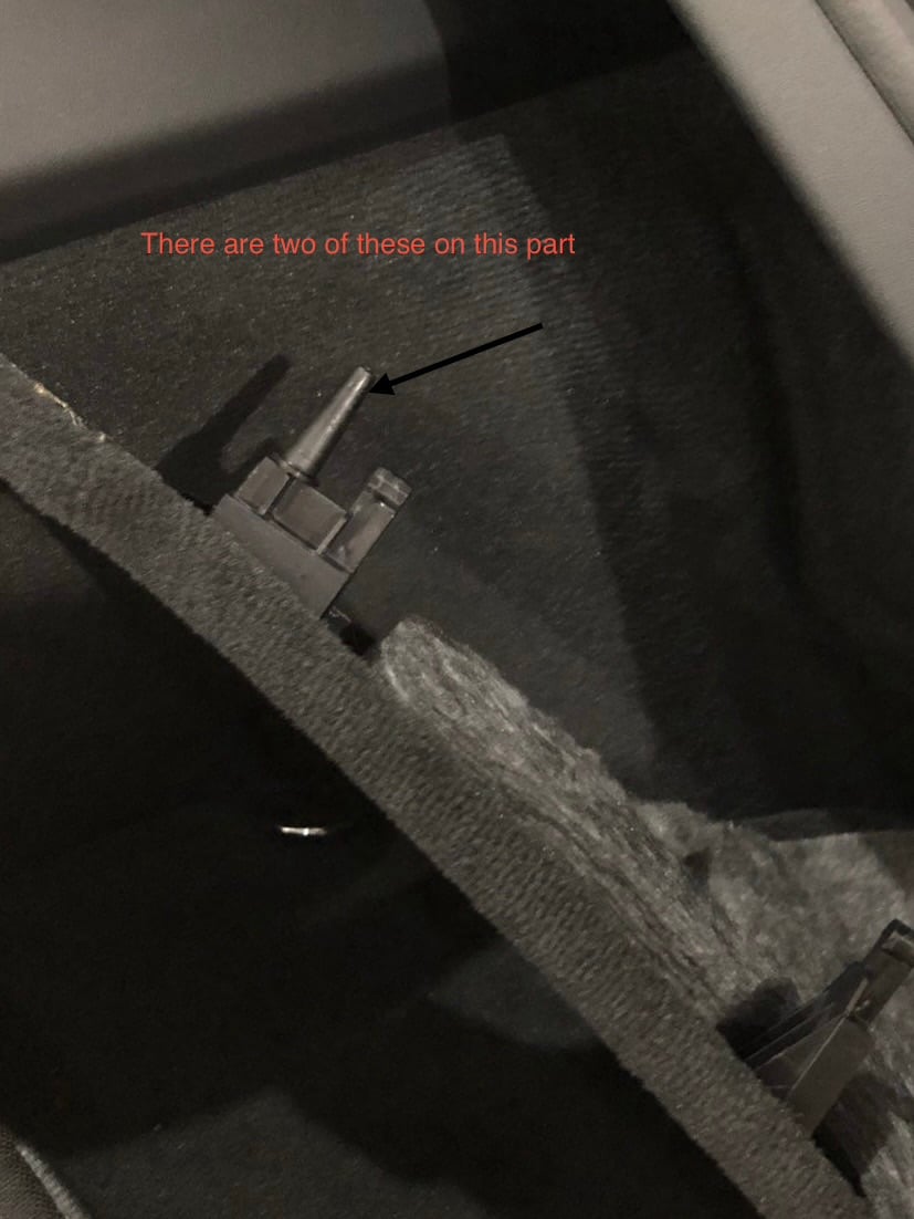

1. Remove Fuse Cover on the rear passenger side (LHD Cars), watch for the little cones that like to fall off.
2. Find the 7.5 Amp Fuse in Slot 10, and remove it.

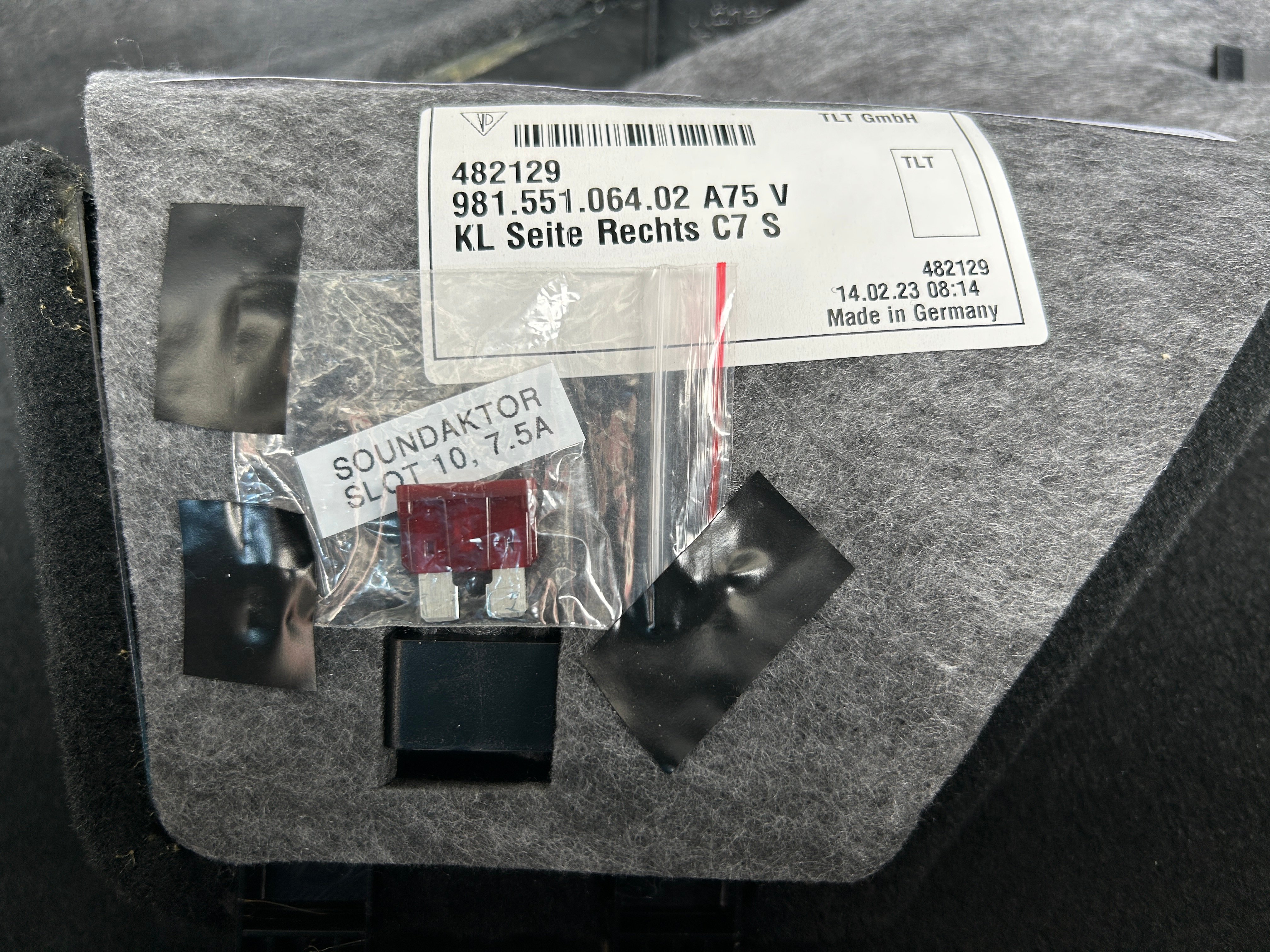

3. I followed an example from another forum and taped a baggie containing the fuse, inside the fuse cover.

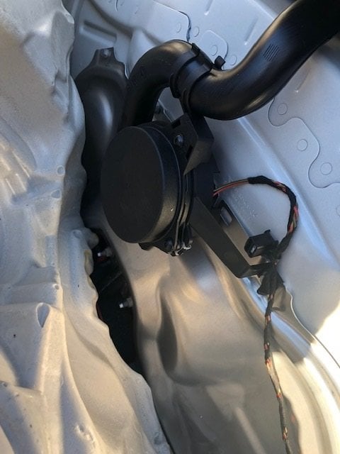

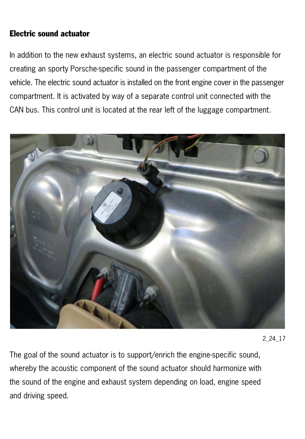

Tom wrote: Thu Jul 23, 2026 6:11 pm On my 991, there was a tube that carried engine noise into the cabin. Is the 718 version purely electric? I sold the 991 before I ever got around to it, but it was also unwanted noise to me -- made the car drone in the cabin when the pse flaps were open...

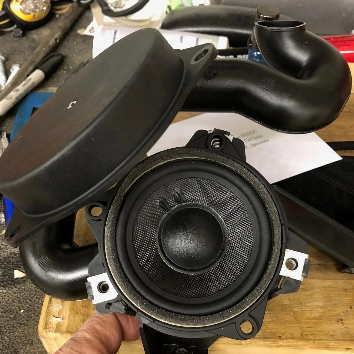

When the 718 was introduced it had this:
That was the style of Soundaktor that was found in VW and Audi cars.
2019 - 2025 models had a newer design, which is a speaker and tube design apparently less harsh than the older design as it does not vibrate the firewall the way the older design does.
Newer Design:
The fuse pull works with either as it kills power to the Control Unit.

The speaker pictured looks like it’s higher quality than the ones supplied with the Bose system in my Cayman. 😉
