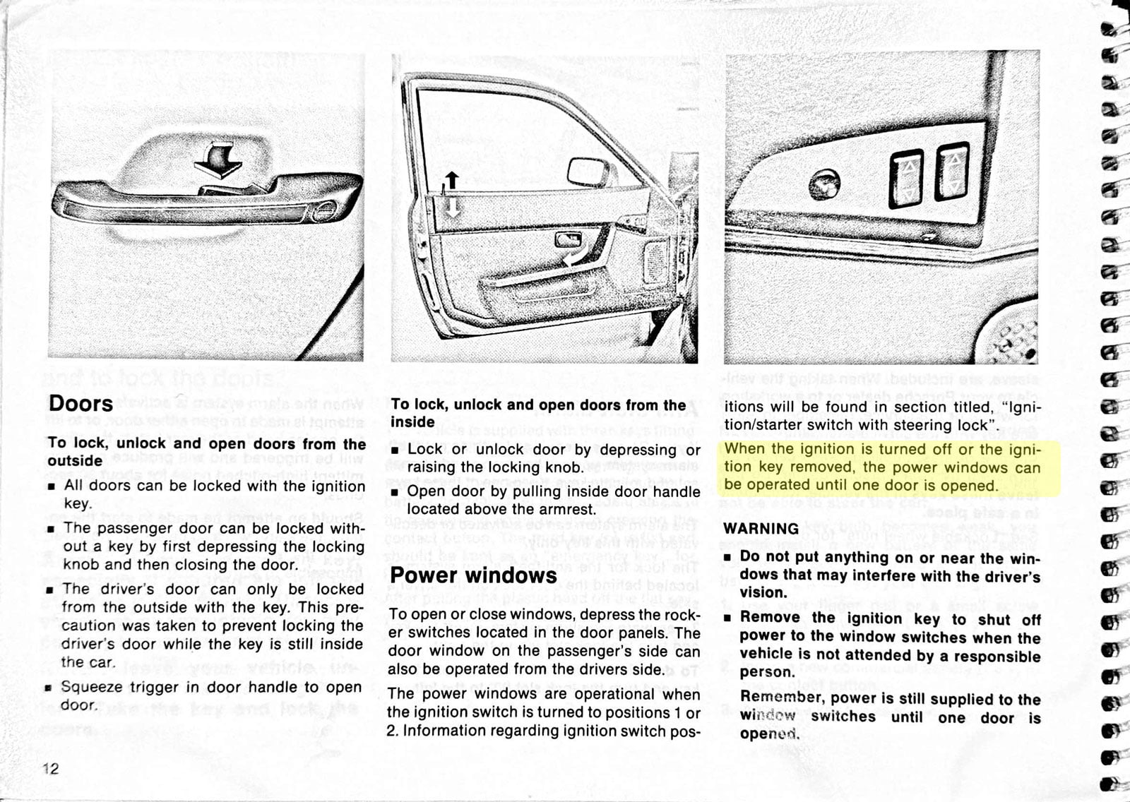

This thread made me paranoid so I went to an obscure, rarely-referenced source for the answer -- my old owner's manual. :shifty: It says exactly what @soxnail said. I understand from poking around that a stuck relay can also allow the windows to work without the key. But, perhaps more relevant here, I also found an NHTSA regulation that prohibits (in the US) the windows from working without the key (except after removing the key and before opening a door). Since the car works exactly as specified by that US law, I would not be at all surprised if it were a US-only 'feature.' If anyone has a Euro Owners Handbook, I'd love to see if this page is different....
https://www.nhtsa.gov/interpretations/2831o

Can’t really remember if my West Germany -delivered car’s manual has a similar page, but I can check when I get back home in a few days. And yes, I can confirm that there’s a distinct difference in the way US-spec car electric windows function vs. ROW cars. I wonder if Canadian cars function more akin to their ROW or US counterparts in this respect?
