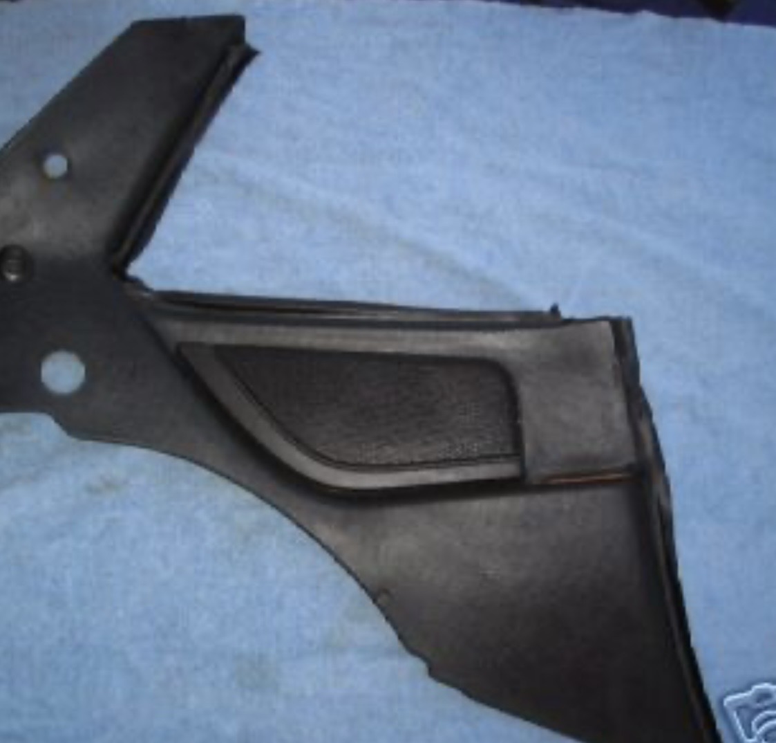

Looking to see what size speakers people are able to fit in the front doors and rear quarters. I would love to find a set of what I think are from 968. Part 944 645 046 00
but I think they are NLA. Would love to see pics of what people are doing. Not looking to keep it stock looking. I’m willing to cut the panels. Also thinking of rear seat delete and making speaker boxes.

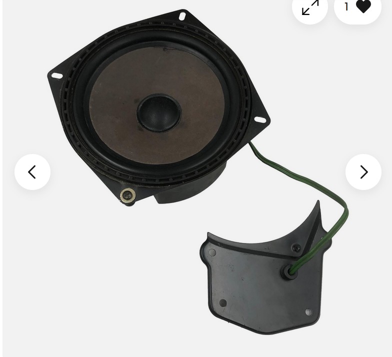

I think this is the stock round rear speaker and adapter. Is that small plastic piece on the bottom all that's needed to get any 6.5" speaker to fit? I saw this on ebay in the EU. From what I can gather, there is a L and a R side adapter plate. But, you're right that it wouldn't be too hard to fabricate your own, but the real piece is nice too.
Is this what you bought from Germany?

chrischrischris wrote: Wed Jun 17, 2026 7:29 am I think this is the stock round rear speaker and adapter. Is that small plastic piece on the bottom all that's needed to get any 6.5" speaker to fit? I saw this on ebay in the EU. From what I can gather, there is a L and a R side adapter plate. But, you're right that it wouldn't be too hard to fabricate your own, but the real piece is nice too.
Yep it's just two small pieces of metal like in your photo and both sides are different.
