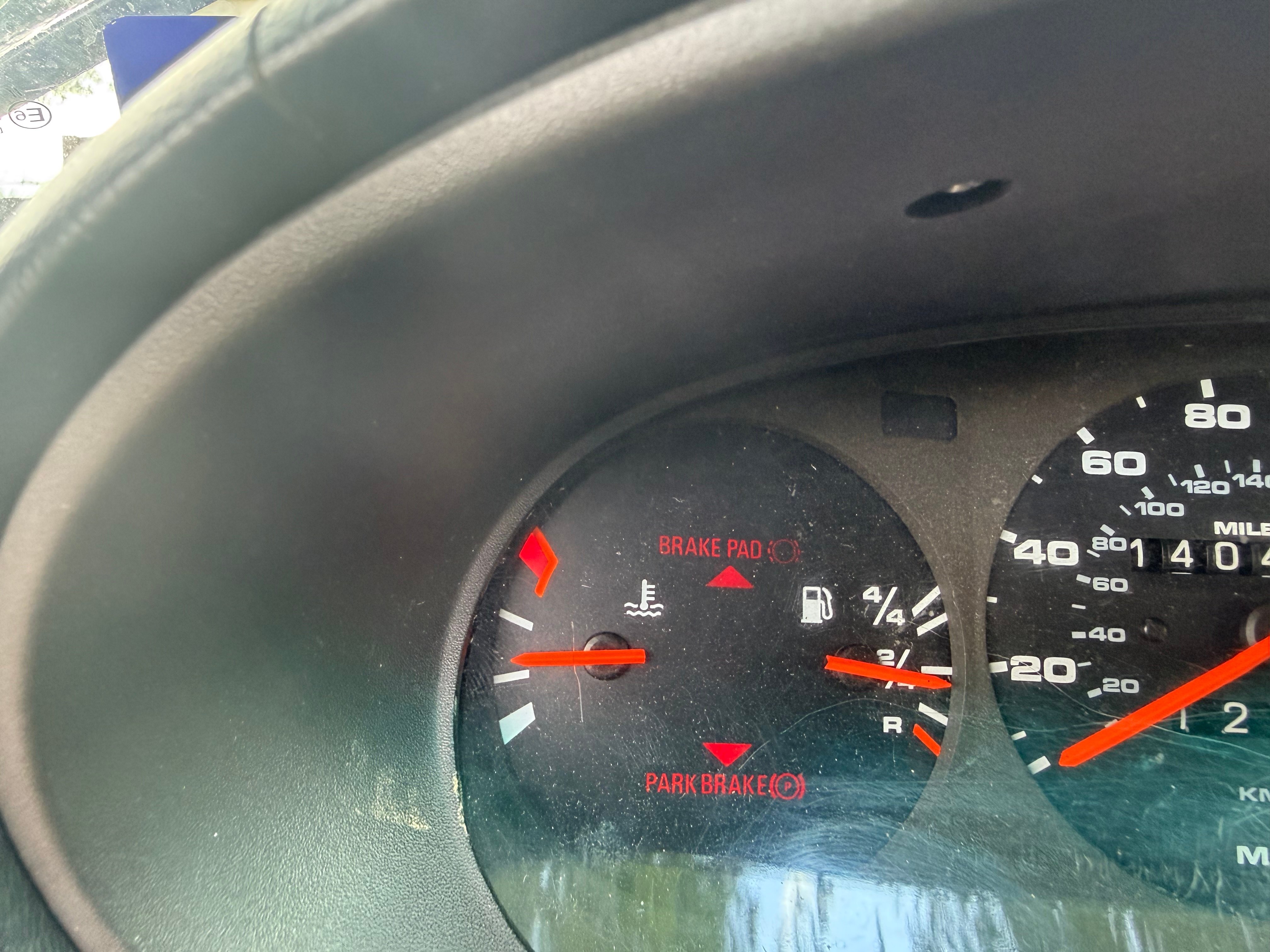

Unfortunately, now I have another new plot twist symptom. The red light on the temperature gauge came on when the fans kicked on the second time but the gauge was reading around the halfway mark or less.. See picture attached. Edit: forgot to mention, I did recently change the temperature sender with a uro unit. I wonder if got a bad sensor. is that idiot light reading the block temperature? I went ahead and shut it off after this happened.I guess at this point I need to just know if I’m overheating or not. I have no idea if I can trust the gauge and now the light coming on really has me wondering. This is new.Any ideas on this? Guessing this still could be air pockets as well in the system or like you said, poor circulation.

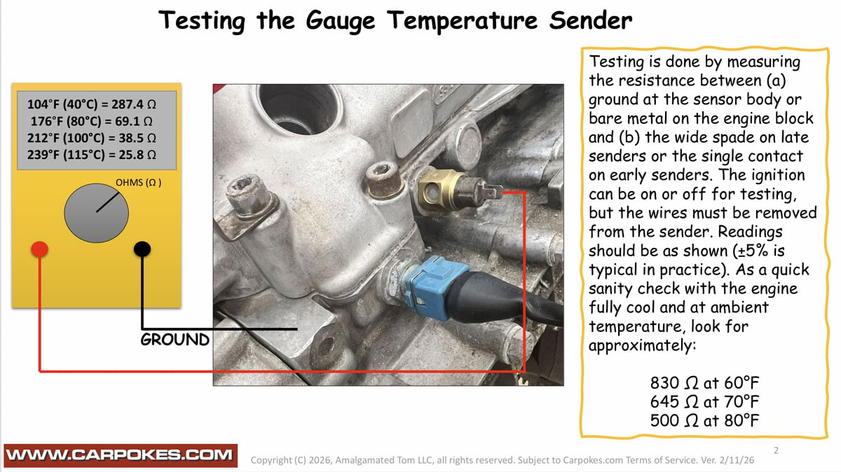

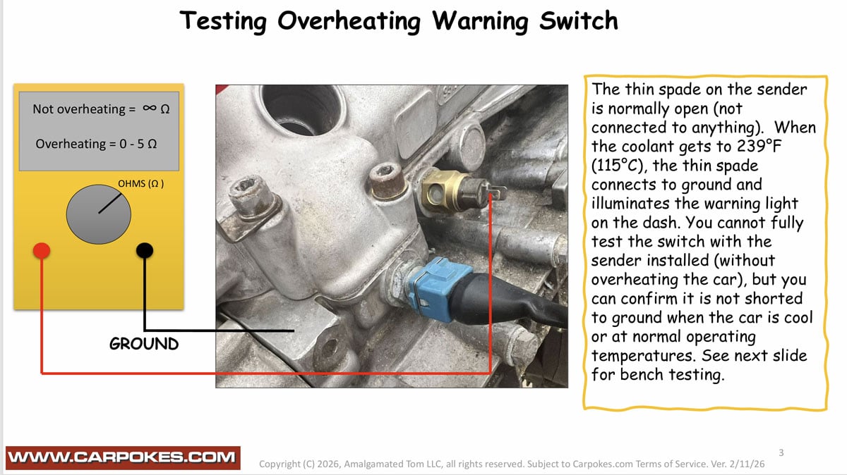

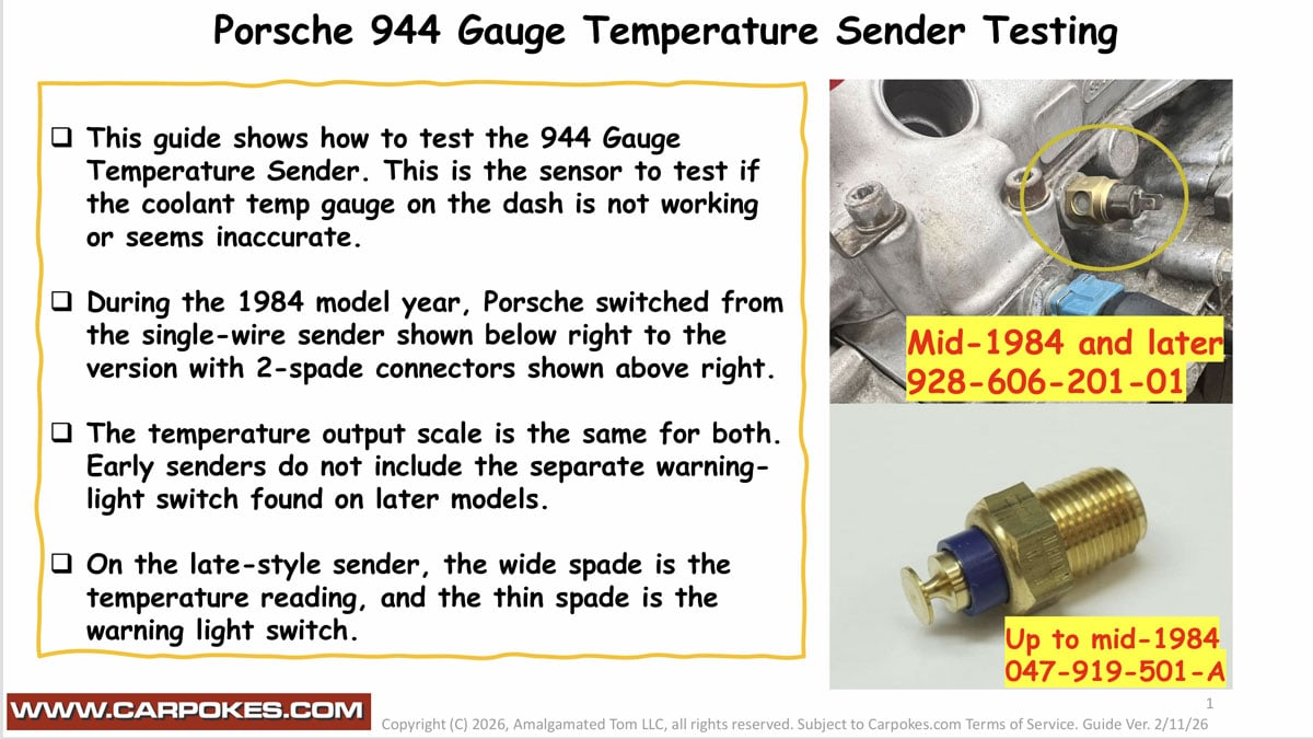

That warning light is controlled by the same sensor as the temp needle, but the two can fail separately. The sensor is in the block -- it has two spade connectors. The wider spade creates a resistance (ohm) reading to ground, which the gauge shows as a temp. The narrow spade just shorts to ground when the temp exceeds the upper limit. We have a test procedure to check the sensor in the download section, but in an effort to get it out into the wild, I've reproduced it below as regular image files. This way you can test both the warning light function and get a good sense if the temp needle is being fed accurate info. Unless your harness is shorting to ground somewhere, or the narrow connector came off and is touching the block (and therefore grounding), it looks like that part of your sensor is suspect. That doesn't necessarily mean the temp portion is bad, but warrants testing it for sure, and if the warning light part is bad you'll want a new sensor either way. Here's how to test....
