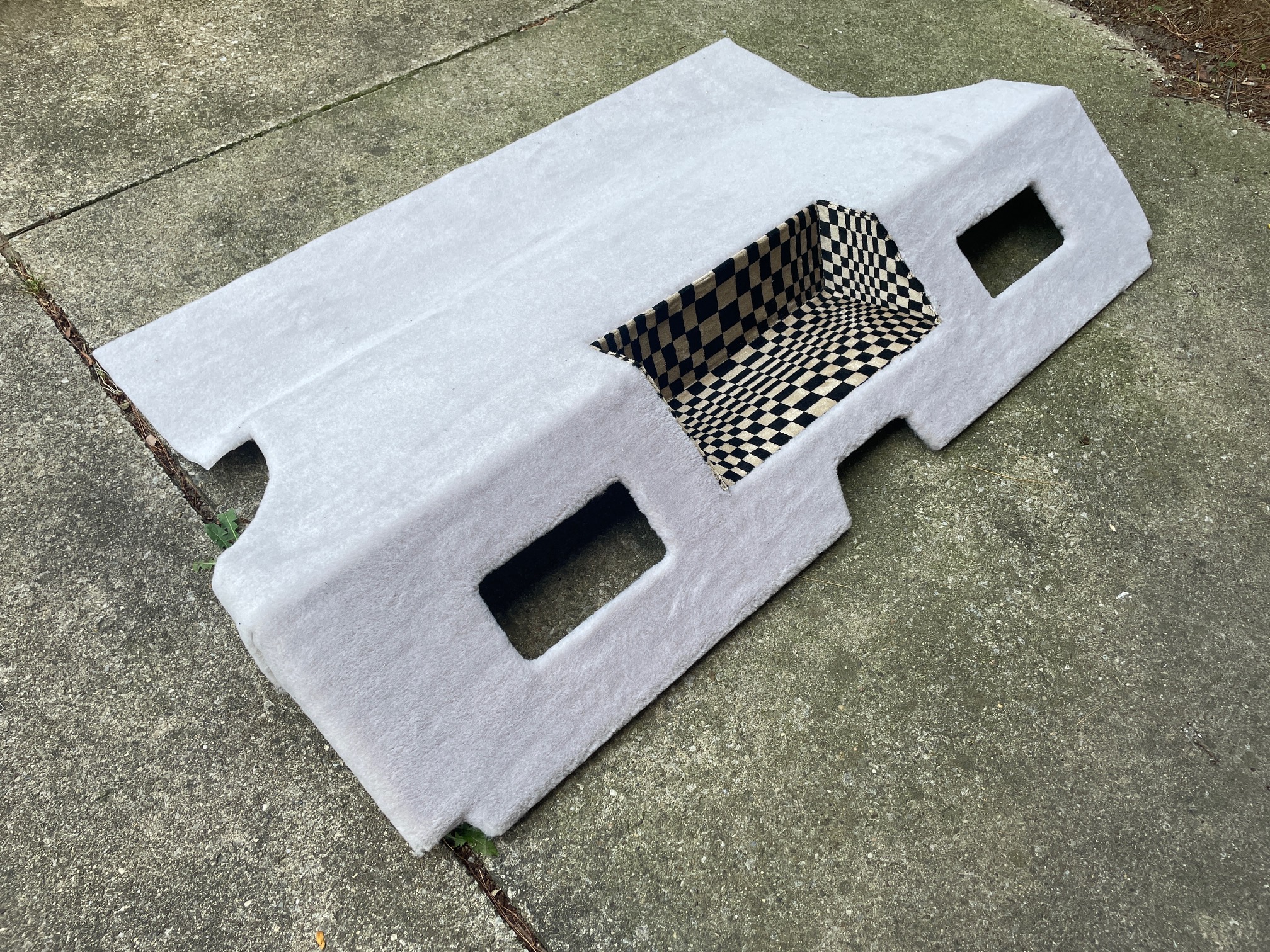

I picked up a Deutsche 9 rear seat delete shell many years ago and still like it a lot. Installation is about as easy as it gets -- just pull out the rear seats and set the shell in place. That’s it. It’s a very simple shell and weighs next to nothing. I’d bet it’s lighter than carpeting.
Deutsche 9 now appears to be Sportwagen-Zuerich, but they still show the rear seat delete on their website:
http://www.sportwagen-zuerich.ch/concre ... 1-and-968/
Initially, I just placed the shell over the bare metal after removing the seats, and the fit/look was excellent. What surprised me was how much additional driveline and transaxle noise entered the cabin afterward. A lot. The rear seat area seems to act like a bit of an amplifier.
I think whalenlg benefits from the large rear speakers in comparison — they probably block some of the sound and disrupt the “amplifier” effect. Mine was loud enough that I ended up adding stick-on Dynamat material on the pan metal, which helped quite a bit, though it’s still noticeably louder than a stock 944.
At this point, the cabin noise is somewhere between a Lexus and a UPS truck. :shifty:
I could probably double down on the Dynamat and get it closer to stock quietness, but honestly it’s now just loud enough to feel cool and mechanical, while still quiet enough not to drive me nuts. :)

Hey Tom, Is that the same as the 968 Club Sport Rear Seat Delete?? I looked at that and it looks like it’s just the carpet replacement…. I’m looking for something to fill up the space where the rear seat was and possibly gain some sort of storage area…. Maybe you can post a picture of exactly what you have….
Re: Rear Seat Delete
Posted: Mon May 11, 2026 2:33 pm
by Trouble
Disregard that message Tom, I just opened up the picture…👍👍👍

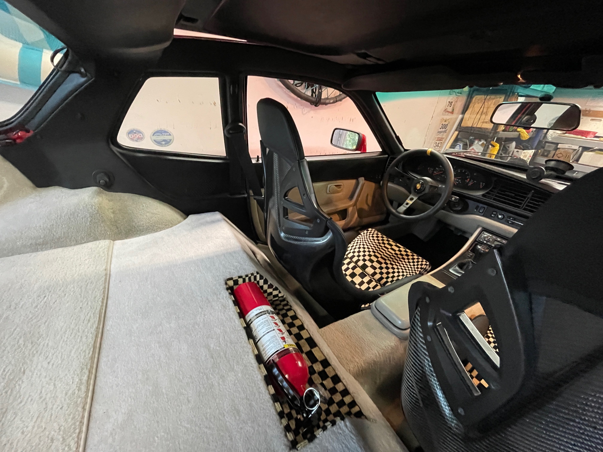

I made my own.
Very easy to remove rear folding portion and seat belts. I left the bottoms in case I want to reverse it, and I didn't want any extra road noise.
As for what I encountered: lots of birdseed. Last owner had rodents and this was their winter home.
If I had to do it again, I'd add the cross bar that the Porsche OEM one has to keep stuff from sliding forward.

VERY NICE clean look!!!! I’m looking to remove the lower seat cushions and build some sort of storage compartments just like the Club Sport…. The seats are weathered up pretty bad and I don’t plan on going back and having them replaced anytime soon…

@Aaron_N
I agree with Trouble, that is a really clean looking piece, and I like the cutout for a fire extinguisher...smart addition!
Love the seats as well!
