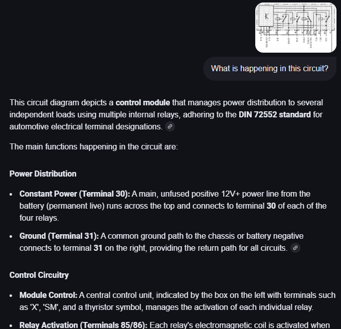

A friend of mine let me know that he's been using AI for circuit translation and having good success. I'm not good enough to determine if there is wrong information being returned, since the devil is in the details for these kinds of things, but I think this is sort of slick capability. Without further ado, here is what I've been messing around with.

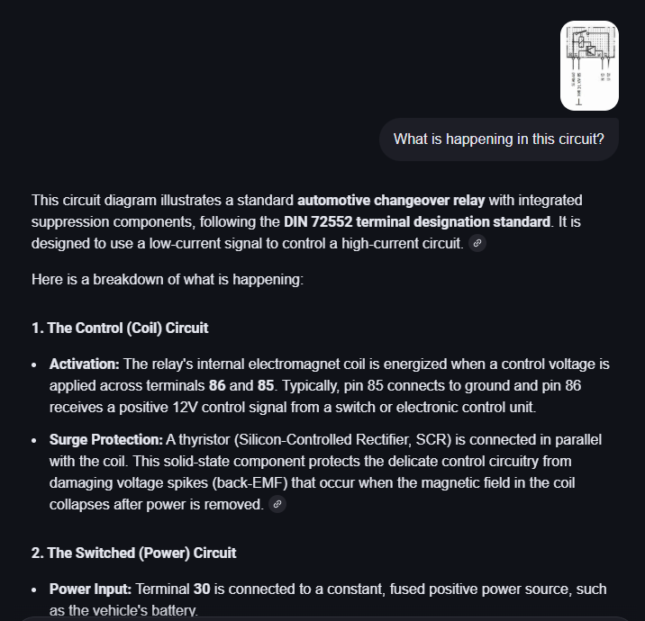

For the backup light relay:

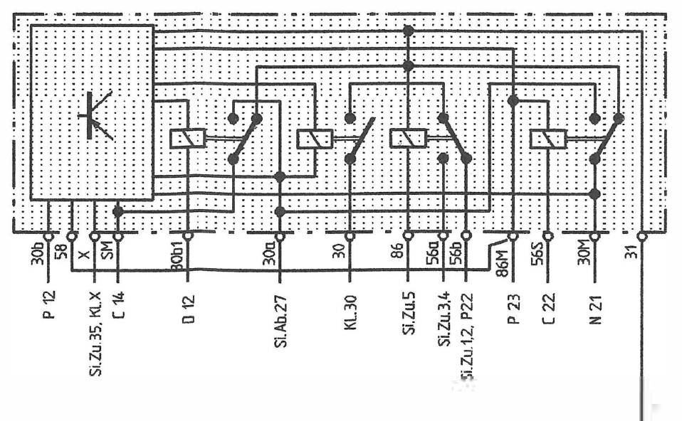

A more complicated relay, the Light Combination relay:
I still need to make up my mind about this usefulness; being generally not on board with AI makes me sort of hate having it be actually useful.

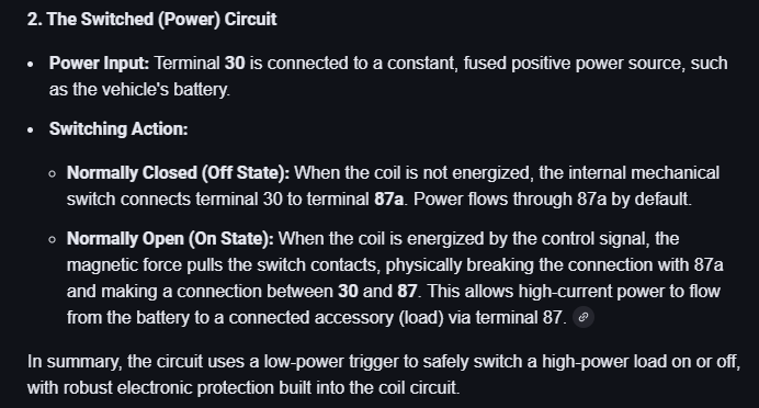

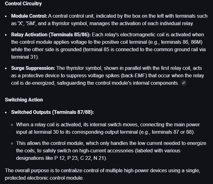

Oof ... usually AI is a little better than that. It is explaining things that don't exist. Like the thyristor across the first relay coil. I don't see that. I do see a PNP transistor symbol loosely in parallel with the coils. Term 30 is defitnitely not the main common power. Even 30a, b, c ... we can't be sure based on that. This makes my brain hurt

With no sarcasm whatsoever, I would love someone that actually understands EE dissect what came out of the AI about those circuits. And because I think that AI for these kinds of things is a bunch of hoopla (but confident sounding hoopla), I would love some further validation that it is unreliable here, it really warms the cockles of my AI-bubble-fearing heart.

What that means is that it has zero ability to understand or process images. When you ask it questions about an image, it has to try to convert the image into "tokens" (I said words before but they are really fractions of words called tokens). This translation process isn't very accurate because it's just guessing. If there's any way you can convert the image into something formal involving words, you should get far better results that way. For instance if you can express a circuit design in a SPICE netlist it will probably give you very good answers.

I am an EE. I use AI once in a while to help with tedious tasks or to give base code for an operation. The problem is that it will be confidently wrong. You have to know what to expect and be able to make sense of it, or else you will go down a bad rabbit hole, quickly.Zirconocene wrote: Tue Dec 02, 2025 4:22 pm With no sarcasm whatsoever, I would love someone that actually understands EE dissect what came out of the AI about those circuits. And because I think that AI for these kinds of things is a bunch of hoopla (but confident sounding hoopla), I would love some further validation that it is unreliable here, it really warms the cockles of my AI-bubble-fearing heart.

YES! That would definitely give you a better answer since it doesn't have to translate the picture to symbols first. I'll have to give that a try.johnb wrote: Wed Dec 03, 2025 5:35 am For instance if you can express a circuit design in a SPICE netlist it will probably give you very good answers.
