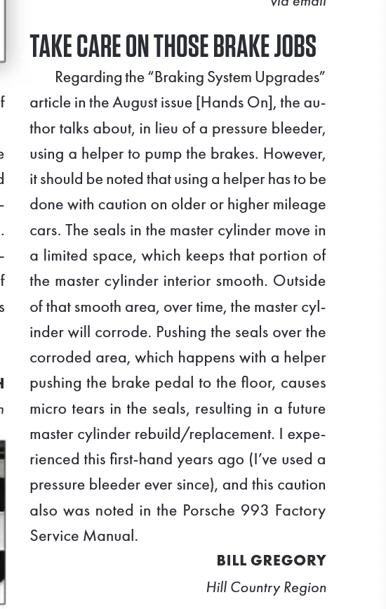

I read the following last night in the new issue of Panorama. May not apply but it is plausible.
Screenshot 2025-10-19 170144.png (80.99 KiB) Viewed 421 times
