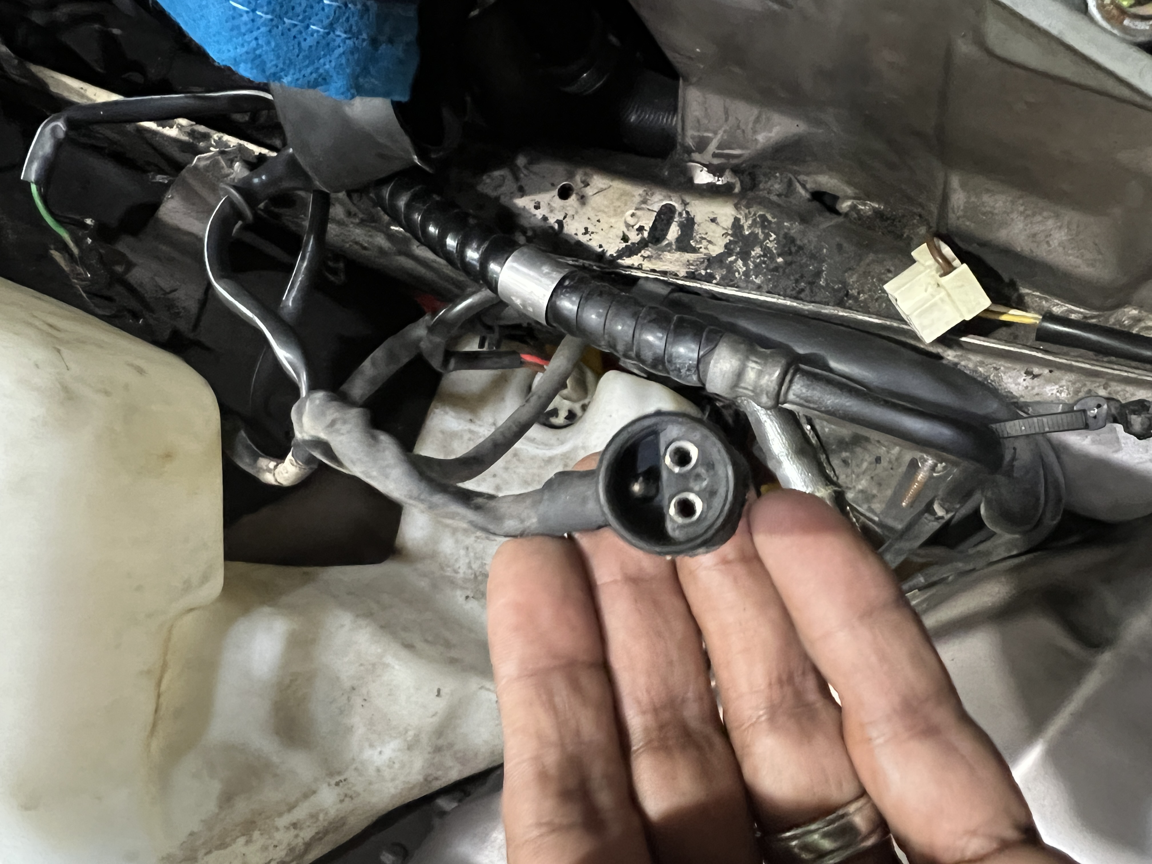

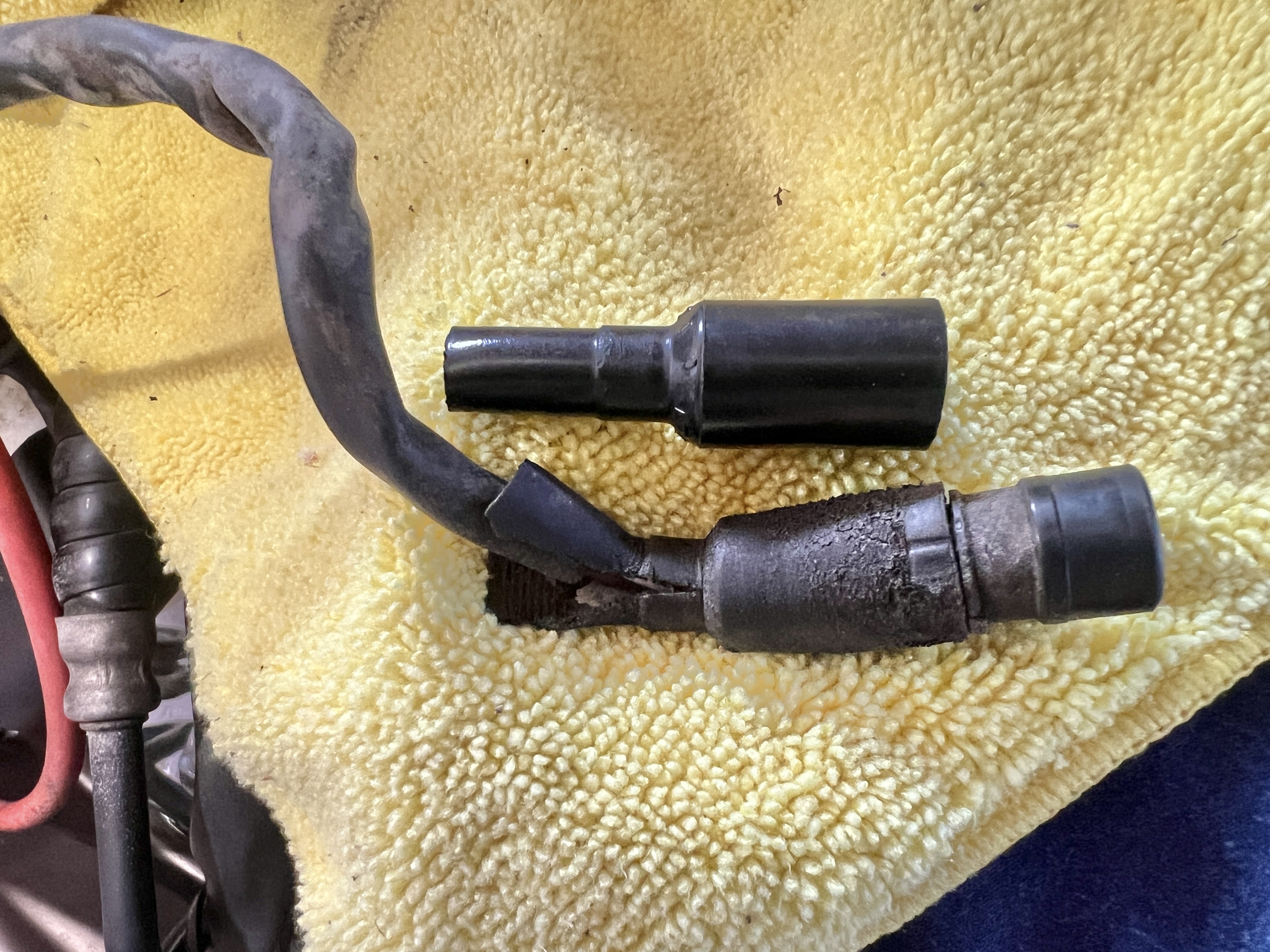

Bought new rubber grommet/sleeves for these headlight wiring plugs.
I was hoping that the connectors can be depinned so I could pull the individual wires through the new sleeve.
Does anyone know if it can be done with these connectors? I need to either purchase or borrow a set of tools to try it.

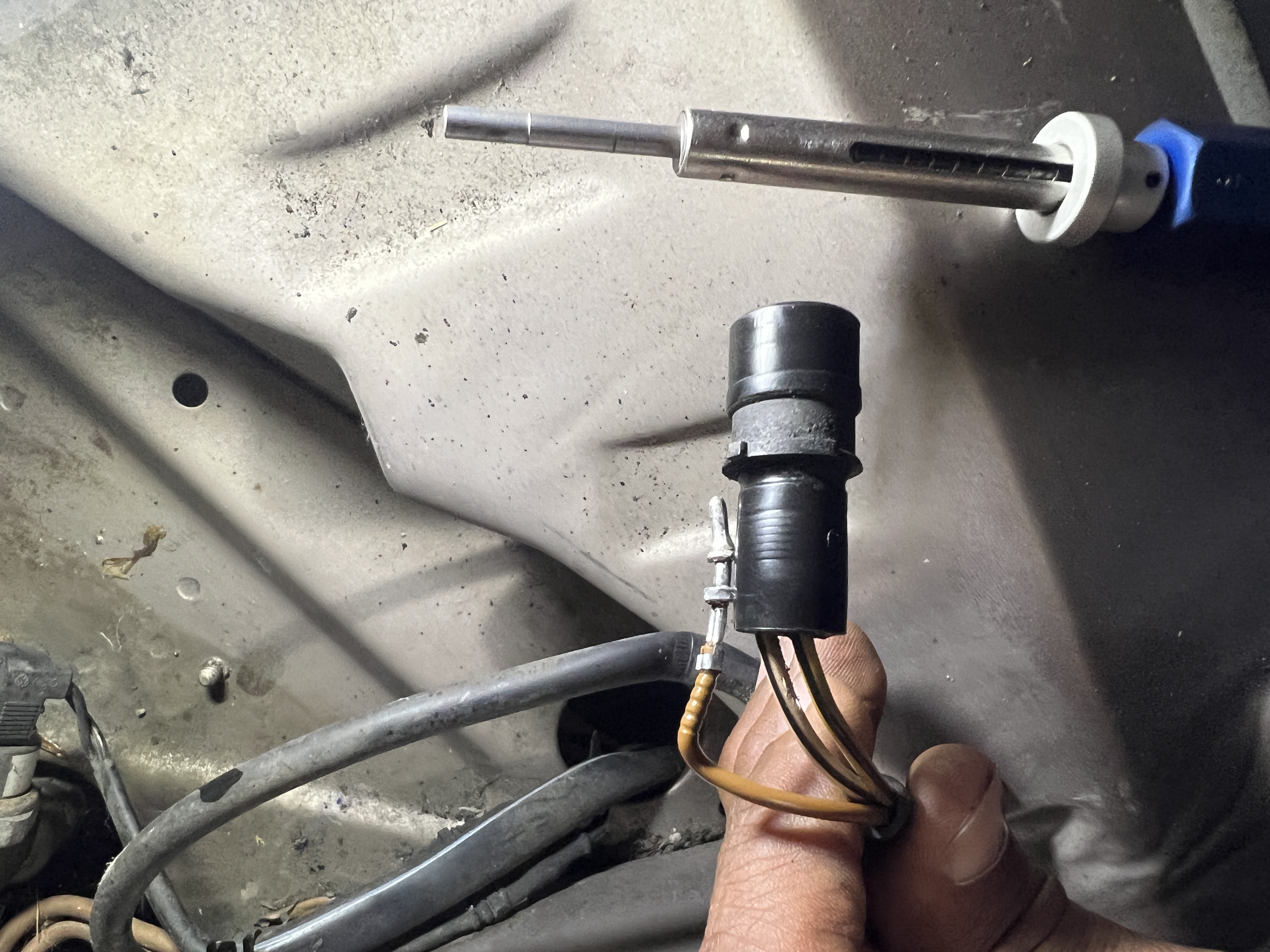

@gb951 - Those are the ones I ordered, but I got them directly from the company and paid an extra $10 for shipping. Ugh. They are expected to arrive today.
I was able to remove the male pins with a tool I borrowed from a neighbor. The females ones don't fit the borrowed tool.
Will try those and post an update once I get the delivery.
