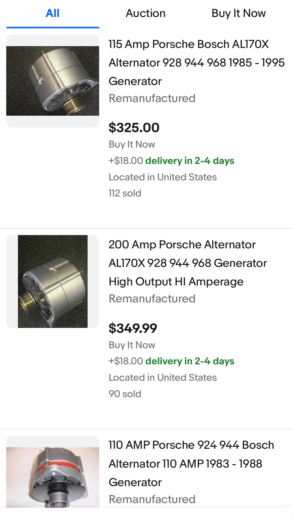

If you’re referring to BNR parts for alternator rebuilds in LA, I’ve been using them for decades.
https://www.ebay.com/str/bnrpartsalternatorsandstarters
All the Bosch rebuilds for my ‘90 Corrado were losing bearings every two years. The guy @ BNR verified his rebuilt 90 to 140amp Bosch alternator would work. He offered to find a cherry picked core for me, add SKF bearings, better fan and stated I’d never have another problem.
That was 10-15 years ago. I still have the extra one I purchased because no one else builds them like them.

Over a 15 years ago BNR used upgraded components in a stock Bosch housing for my 90 Corrado g60 that was eating alternator bearings every 2 years. They rebuilt with SKF bearings and took the 90a OEM unit to 140. I’m still running that alternator 15 years later. They found a way to up the amps to 200 now in the same shell.
My recommendation would be to do as previously requested of me when ordering. In the comment section on eBay add “Pls use SKF bearings”. They may charge a little more but 15+ years of longevity is worth it. The quick recharge of a depleted battery from storage or a battery on the fritz via 200amp is what’s needed on a classic to get you and the car off the road safely.
