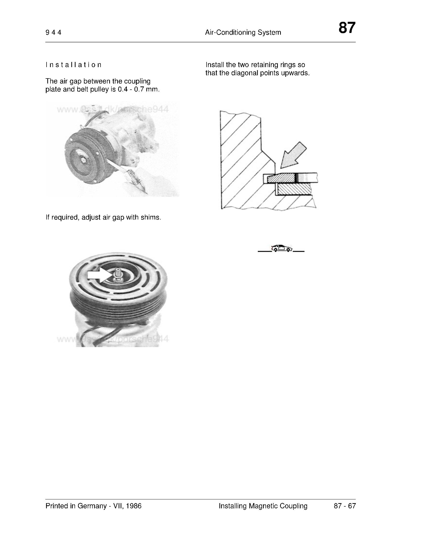

Here is the information directly from the factory workshop manual...
ac compressor air gap conv 1.jpeg (196.18 KiB) Viewed 1015 times

The spec clearance there considers how much the friction material might 'grow' when hot or wet, vs. how hard it might be to have the coil pull the metal drive plate back against that friction material surface. Your 0.010" clearance is really small, and when they drag you'd know by the burn marks, the swelling, and the fragrance while driving. Your burned-off paint is a serious telltale of heat from dragging.

The gap is too tight should be around 0.020"–0.040. A 0.010" gap (or less) can cause drag and premature wear. Since you're already pulling the compressor for the R134a conversion, now’s the time to adjust it. You’ll need to remove the clutch and either shim it properly or file down the spacer. Check the clutch plate and pulley for wear while you're in there. Resistance (3.1Ω) is fine, so focus on the gap.
