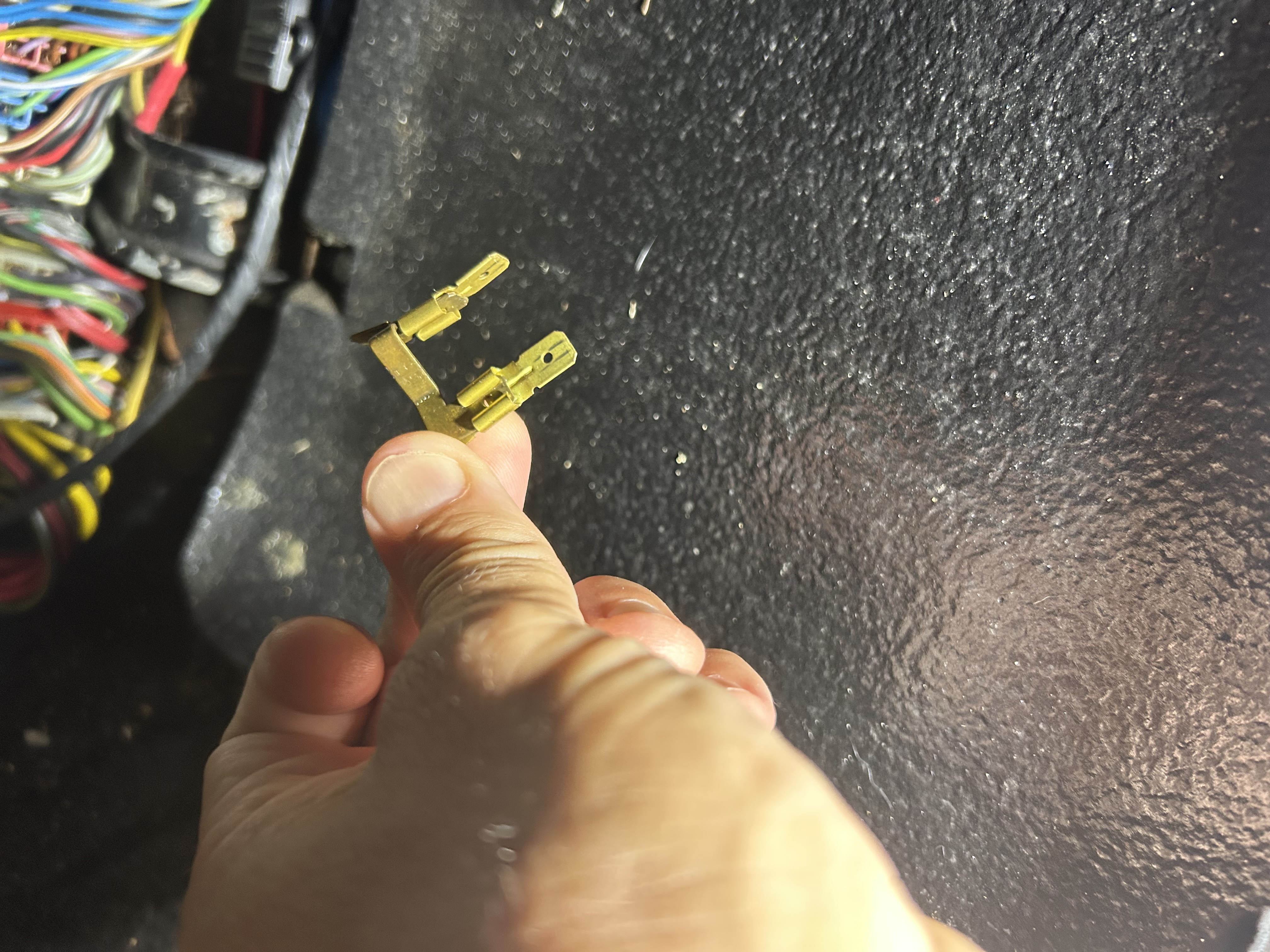

Update! I used a test light to check the jumper in the fuse panel. With the key to “start” it lit weakly the first try, weakly and I hear the fuel
Pump prime the second time and the 3rd time it lights up properly and the car starts.
This tracks with what’s been happening, which is that it takes 3 turns usually.
The jumper looked good, but I have a new spare for fuel pump emergencies so I used some deoxit on the panel contacts and tried it with the fresh jumper. Same thing.
Going to move to the ignition switch and see if anything looks amiss.

Not me but two owners ago - John Nitz. I have kept the name out of respect!Tom wrote: Mon Jul 07, 2025 6:34 pm We need more 928 folks here! dr bob is a walking encyclopedia on those cars (or some modern AI equivalent thereof) so it's always good to see that knowledge go to good use. Tell your friends.Are you the same MrGreenJeans who was on RL --with answers to the 944 questions no one else had?

Tom is too generous. I do a LOT more troubleshooting on the cars than actual work. My 1989 car has only had a couple 'unplanned' repairs needed in the 25+ years I've had it. The original LH controller for injection was a known weakness, so I found a spare and had it updated. When mine started showing signs of imminent death, I swapped in the spare. Then had the original rebuilt and put it back in, kept the other one for field diagnostic rescues on others' cars. My fuel pump relay 'gave up' at the bottom of my driveway at our previous home above Los Angeles. We dragged the car back up the hill, and in a few minutes it was good as new with a new relay. Everything else on the car has been 'maintenance'.
The fuel pump relay in the '78 CIS car has the ignition pulse sensing circuitry built in, so it's worth keeping both the jumper (for diagnosis), and a full spare relay. There's no electronic controller for the CIS K-jet injection on the early 928 cars, so nothing there to keep as a spare. Still, a handful of Bosch 53b-style relays can easily bring joy back into an interrupted trip.
Sounds like you are on the correct path so far. You can do a little more verifying before you trouble the ignition switch. A fused (~~15A should be sufficient) in the 87 contact in that socket, jumpered to battery (the rail at the top with the incoming red wires...) should reliably crank the starter. If it doesn't, follow the downstream diagnostics. If the fuse blows, you may be looking at a short in the wiring harness. As our cars age and the wires in the engine bay get more crispy, the risk of insulation failure increases. Then it's a few sleepless nights worrying about what the wire shorted to.
Tangent: I keep a few jumper wires in the ride-along kit. One has a light bulb in series (good when chasing short circuits that are blowing fuses), a second with a fuse and a push-button starter switch for exactly the situation you are describing, and a third with a heavy-duty toggle switch and a fuse, specifically for the fuel pump. 12ga Wire for all of them. These, spare fuses, bubs and relays, plus a DMM, make up almost half of the 'extra tools' in the car these days. A small compressor substitutes for the factory units, a set of mini jumper cables plus a jump-start box, a combo screwdriver... I don't bother carrying tools for any roadside repair I'm not actually willing to do. But the little jumper wires are pretty handy for field diagnostics, and may be just enough to get home where there are better resources.
For the switch change, the gauge binnacle gets carefully loosened, wheel comes off, the cover comes off the steering wheel console with the switches, then the steering column gets unbolted but supported as you lower it for access to the switch. The connector and switch screws will be a LOT easier if you have a ratcheting angle screwdriver with IIRC #0 or #1 Phillips bits. Note he key and switch clocking as you remove the old one, match them before you screw the new one in.
There's not a lot of WYAIT for the switch replacement. Setting the depth for the horn contact is most easily performed with the DMM at the horn relay socket, measuring continuity as you adjust it with the horn button pressed. There's a bearing at the top of the column that might deserve replacement as PM, especially if the steering wheel rotation is at all noisy or grumpy. Order the bearing when you order the switch. Use care as you reset the turn signal switch in place, as the nylon release fingers are pretty fragile at this age. A bit of new grease there will extend their life some too.
A 'good' hack: There's a starter lockout relay in the socket where the jumper sits in the auto gearbox cars. Besides offering in-gear start protection, it also unloads the starter "50" contacts in the ignition switch. With a relay in place of the jumper, you can ground the open relay coil contact in the base as if the actual neutral safety switch were closed, and let the relay do all the heavy lifting when you wan tor run the starter motor.
And in general, the cars benefit a lot for cleaning all the ground points once in a while. A pretty impressive number of maladies and annoyances are magically solved when corroded ground points are restored.
