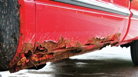

Another thought is that, while high humidity on its own won't rust out an already dry car, it definitely will impede the drying out process if a car is wet from driving in the rain, washing, etc. The moisture seeps into body panels, contacts, electronics, interiors, etc. and high humidity will keep it damp for longer - not something you want to happen continuously over time.
Add in road salt (yes, I was in southeast MI for almost 20-years beginning in the late 60s, dealing with roadways infested with the rusted quarters, rockers, doors, etc. of living dead vehicles) and you really have a recipe for disaster. Plus, there are other chems and pollutants that are made worse by excessive moisture.
If a vehicle is one that a person wants to take care of long-term and, especially, if one lives in a high humidity part of the world and/or around salt from any source, then a de-humidified well-sealed garage is a plus. It's a little bit of extra insurance and is one that's relatively inexpensive and easy to implement.
