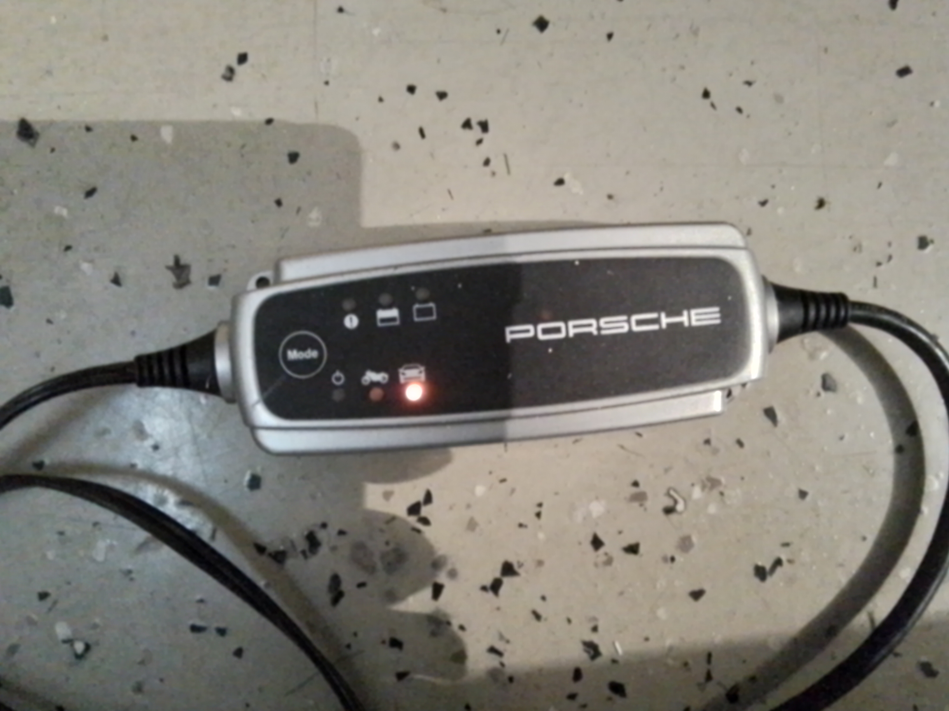

What does this mean
When these units stop working are they done permanently or will they work occasionally?
Instead of throwing the unit in the trash I decided to try the ash tray receptacle and low and behold it worked.
Went back to the trunk and plug in to the receptacle and she functioning just fine.

Good to know. Maybe it acted like a reset in some unknown way.
