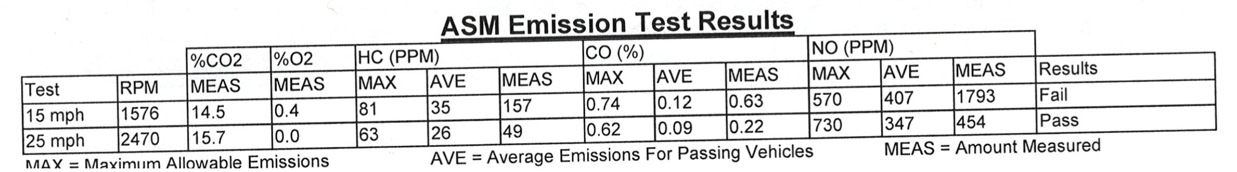

Hey all, was wondering what step's ya'll may take to get the emissions of a 1988 951 down. It only fails at 15 and not 25 and is known to pass when very hot.
The guy I got it from did a bit to it -- including new injectors/waste-gate/fuel pump/etc. Was hoping it could be as simple as a new cat, but it seems unlikely after talking to some local shops.

Sorry to say, but both high CO AND NOx at 15 MPH indicates the catalytic converter is the issue. The oxygen sensor system oscillates between rich and lean of stoichiometric to reduce CO and HC emissions (lean mixture helps this) and NOx (richer mixture helps this). If both are high at a lower RPM/reduced exhaust gas temperature, I think we have the answer . . . .

cda951 wrote: Thu Apr 03, 2025 10:42 pm Sorry to say, but both high CO AND NOx at 15 MPH indicates the catalytic converter is the issue. The oxygen sensor system oscillates between rich and lean of stoichiometric to reduce CO and HC emissions (lean mixture helps this) and NOx (richer mixture helps this). If both are high at a lower RPM/reduced exhaust gas temperature, I think we have the answer . . . .

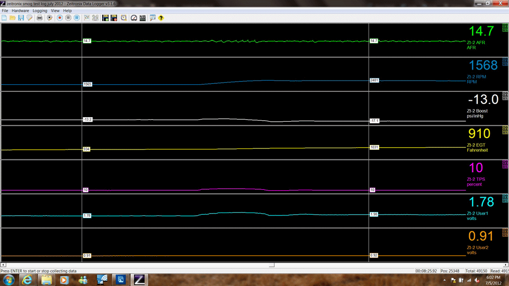

CO looked 'ok' in the chart, no? Did you misread, or think the .63 is still too high even though under the limits? It looks like it had high HC and NOx on the 15 mph run. I'd say that points to a lean mixture with missing, which is worse when they are lugging the motor mercilessly at 15mph. I once logged my CA smog test and confirmed the motor is under more load at 15mph (see below). Since this car did so much worse at 15mph, I'm thinking vacuum leaks and maybe weak ignition. dr bob's angle with the injectors is aimed at the same lean condition, but if the injectors are new as you say --and correct for the car!? -- then I'd start with the odds-on 951 favorites of vacuum leaks and weak ignition. What vacuum do you see at 840rpm when the car is fully (fully) warmed up?
I once had a chance to tune a 951 real time on a live CA dyno test with no cat installed. The car had big injectors and a MAF too. We were able to get any 2 out of 3 numbers under the limits, with the third always being just barely above the limits. So while a new cat will mask a LOT of issues and lower the numbers on just about any car, I would be inclined to triple check for vacuum leaks; and change the spark plugs, cap, rotor, wires and probably 02 sensor unless you know for sure they are fresh. You can always try a new cat once the car is running in tip top shape if it still doesn't pass.
Log from actual CA dyno test on a 951... note the vacuum reading on the left (15mph) vs the right (25mph)...
