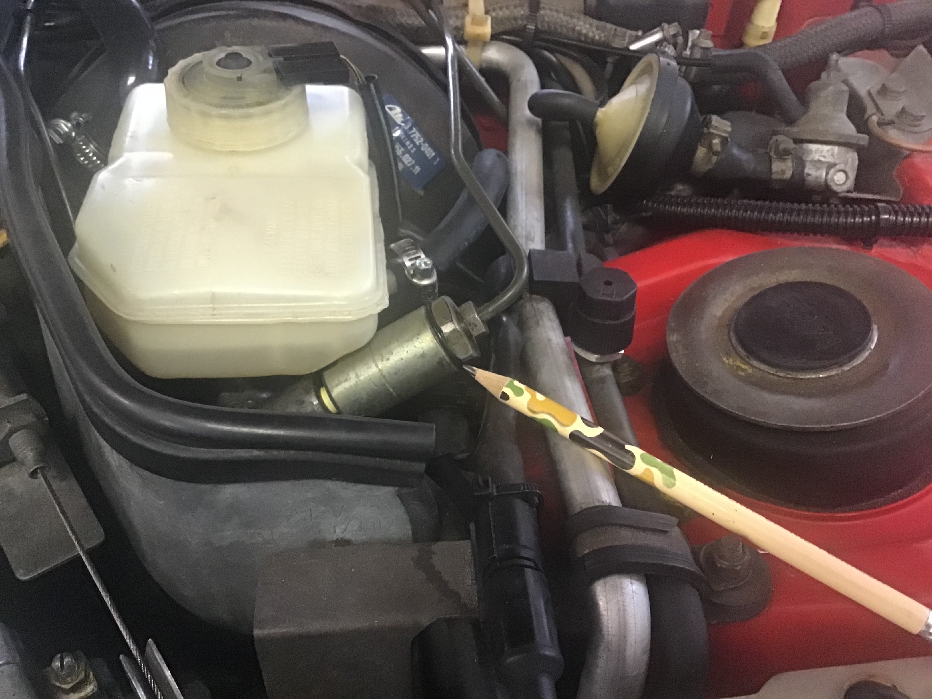

Has anyone
successfully resealed the brake pressure regulator (951-355-305-01), which is attached to the front of the master cylinder? Mine has a very slow leak and I’m 100% certain it’s originating where the regulator screws together. Pelican is asking over $1000 for one! Aftermarket is close to $400.

Update...
Figured I had nothing to loose, so I broke open the regulator. Needed heat to soften the thread lock/sealant, but it finally released. Regulator had a bit of sludge, but no obvious problems. Replaced the small o-ring, put it back together and so far, 75 miles with no leaks!
