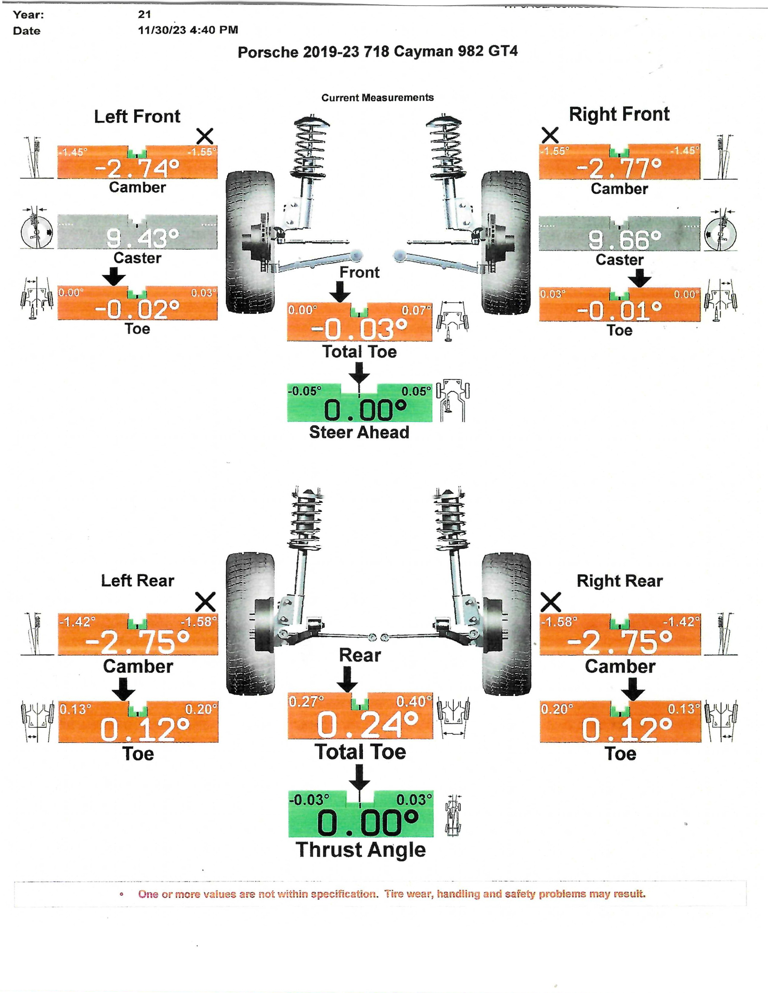

Meanwhile as a start, here are upgrades/changes done to my 2021 GT4 which mostly lives on track. A copy of current alignment too.

2. Square alignment works wonderfully for the GT4 - and most especially for me. Yes, Club Sports in sanctioned racing will generally have say, -3.5 front and - 2.5 rear, at least as a starting point, but for a regular GT4, symmetrical is good. As proof, the car does what I ask it to do. Square might not be the case for others but it works for me.
The specs were suggested to me by one of the best in the sports car racing business, Andy Pilgrim who knows my car well. (He's driven it.) Andy consults on setups (and tires) for various race teams worldwide in addition to his continued storied career as a fantastic pro race car driver, still in great demand. Here's what he suggested: "As far as the camber I would make it as square as possible right now. You will pretty much always end up with an understeering Cayman GT4 as you have so much weight at the back (Same with our Cayman GT4 race cars) but squaring it off will help keep the back stable to start with and you can adjust from there."
Well, I've kept the alignment square except for increasing overall camber all around as I added the new Tarett parts. I like the way it performs.
Andy also stressed toe settings. Where mine are as shown in the alignment sheet is where they should be, at least for my setup.
I was also having terrible tire wear the first season. Correcting the camber (among other things such as going to the Apex 19" forged wheels) rectified that.
As for the sways, front Full Soft and rear Full Stiff. This what most race shops recommend. Also it's what TPC Racing/DSC recommends for the GT4. (Andy P too.)
