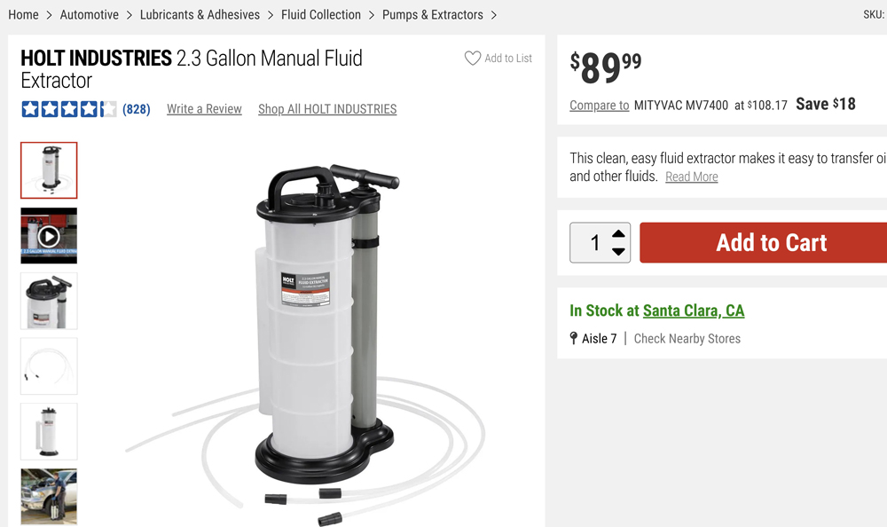

Posted: Wed Oct 08, 2025 5:43 pm
Would you be able to get at it with an extractor pump like this cheapy from HF?
