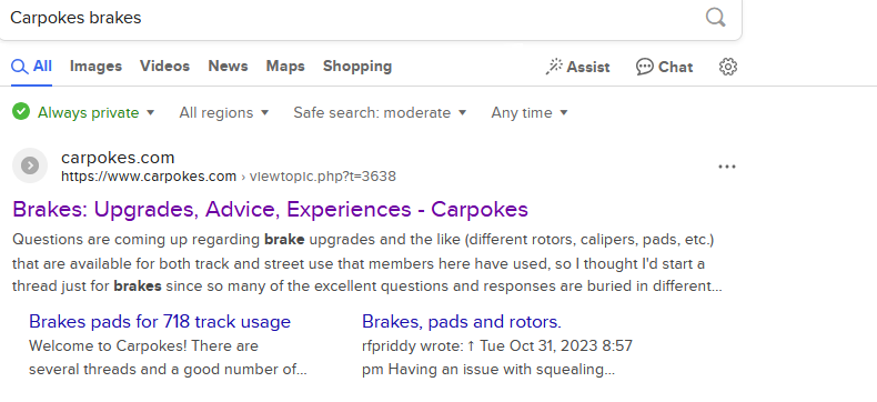

PS: I just now did a search engine query using "Carpokes brakes" in the search field. The results below popped up in the attached screenshot. The new thread was already at the top of the results list of a public search engine!

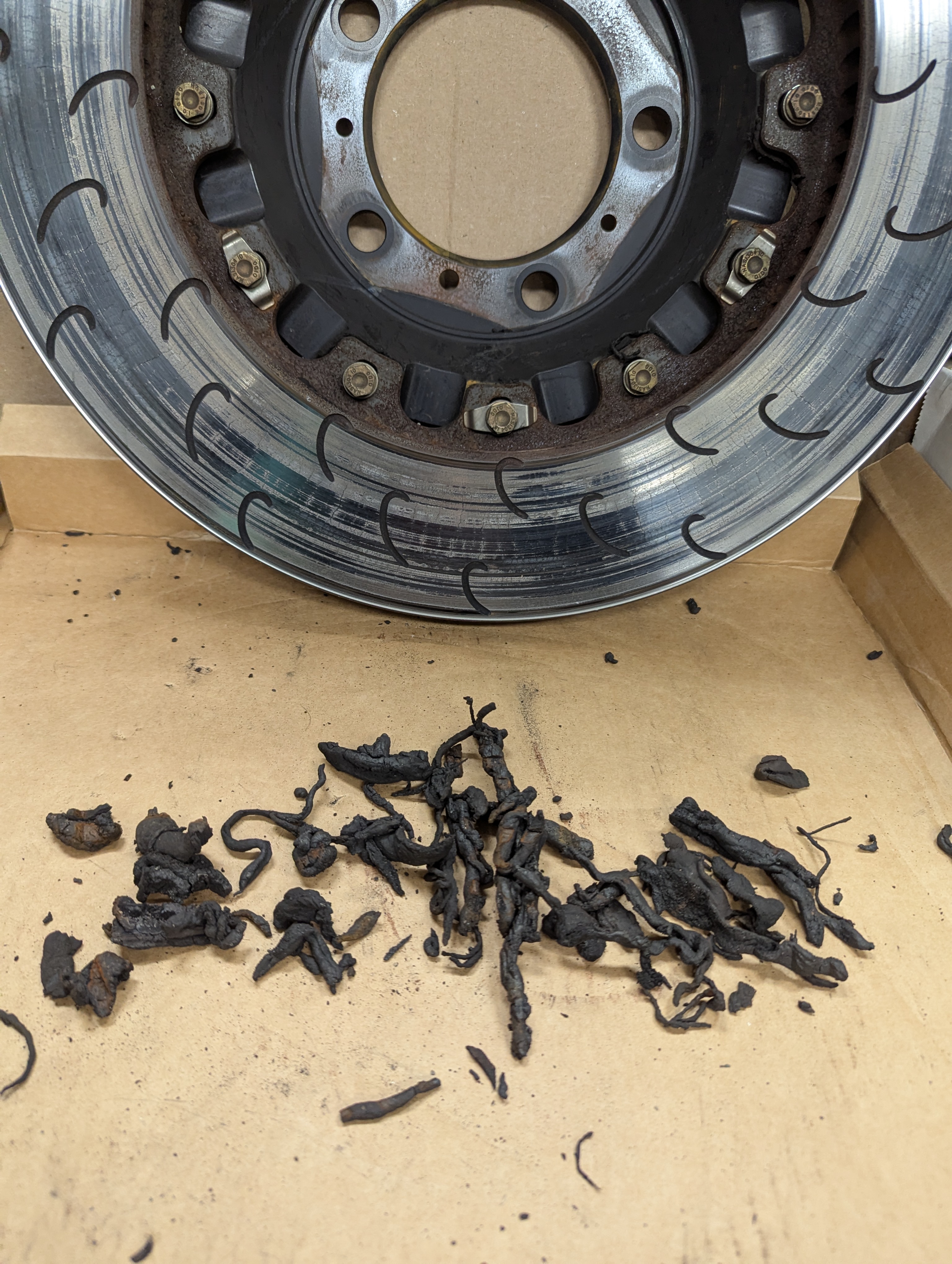

I intended to post this at the end of 2024 track season but forgot.
An area that can be overlooked for debris (rubber) is the inside rotor cooling slots which are not always easily seen or accessed until the rotors are removed. The exit slots can get clogged, significantly diminishing their ability to cool extremely hot brakes. The collected and accumulated rubber in the second pic was from the inside slots of just one front wheel. I'm now making sure that I reach behind each rotor, cleaning those slot areas when rotating wheels/tires.

Super solid post as I have seen this over the years but I have failed to ever report it and as blueline noted it can diminish the cooling ability to a large degree. Thanks blue I will place a line on my track check sheet from now on to make sure I have cleaned things out if needed. I have had the same experience but I really should check this more often since I brake rather late , like ... yesterday, ha! Appreciate this valuable tip as rocks can get between the caliper and pad , but this is a way more common concern. I have had " Flame On " in my rotors a couple of times and each situation could have been avoided if I had remembered to do this rotor check.

Tim, wow on the rubber in the rotors. I have rubber bits nearly everywhere else so it makes sense but I have never looked there. Will check next time I am under the car or the tires are off. I was under the front today making a sway bar hole adjustment.
