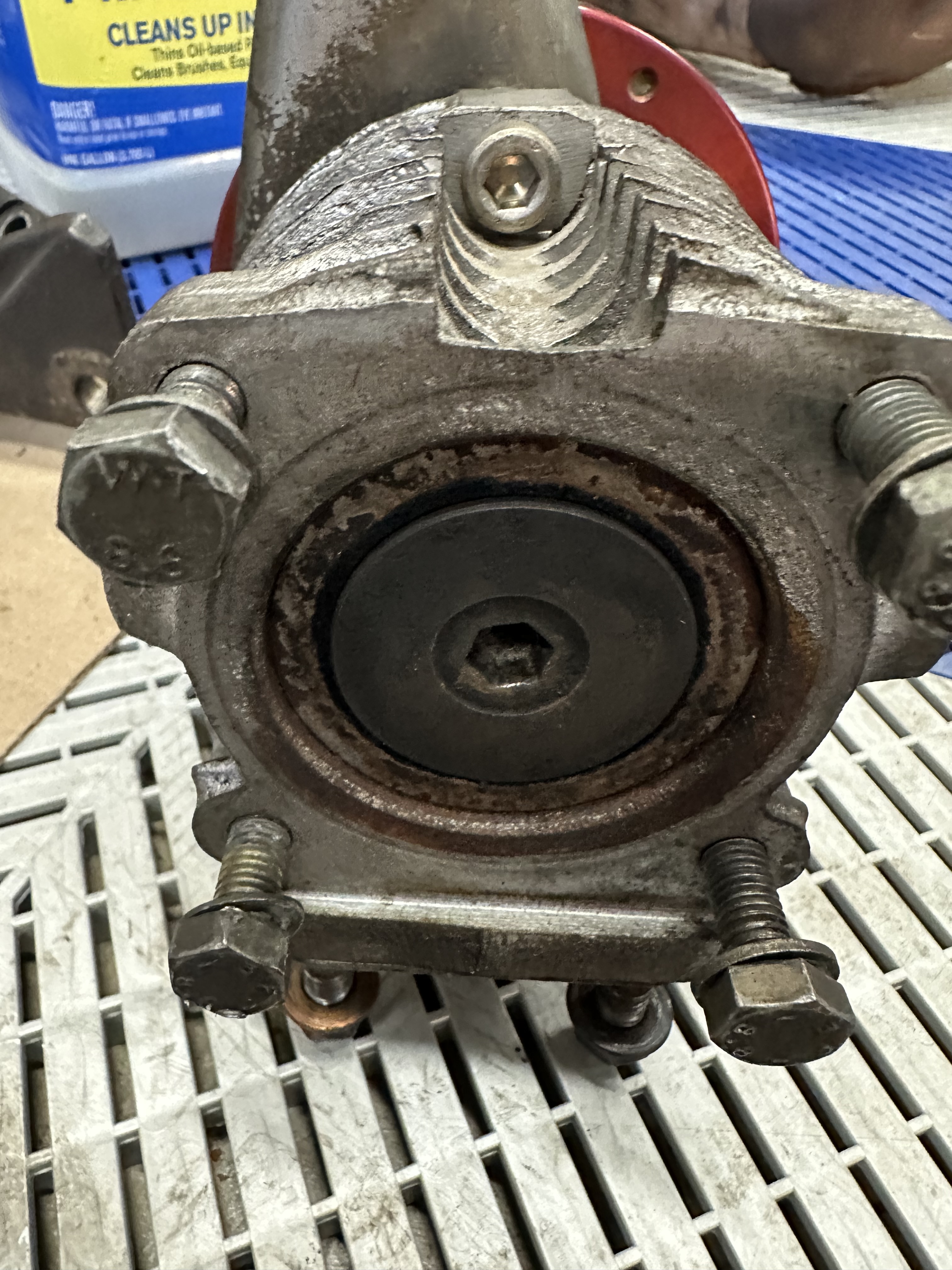

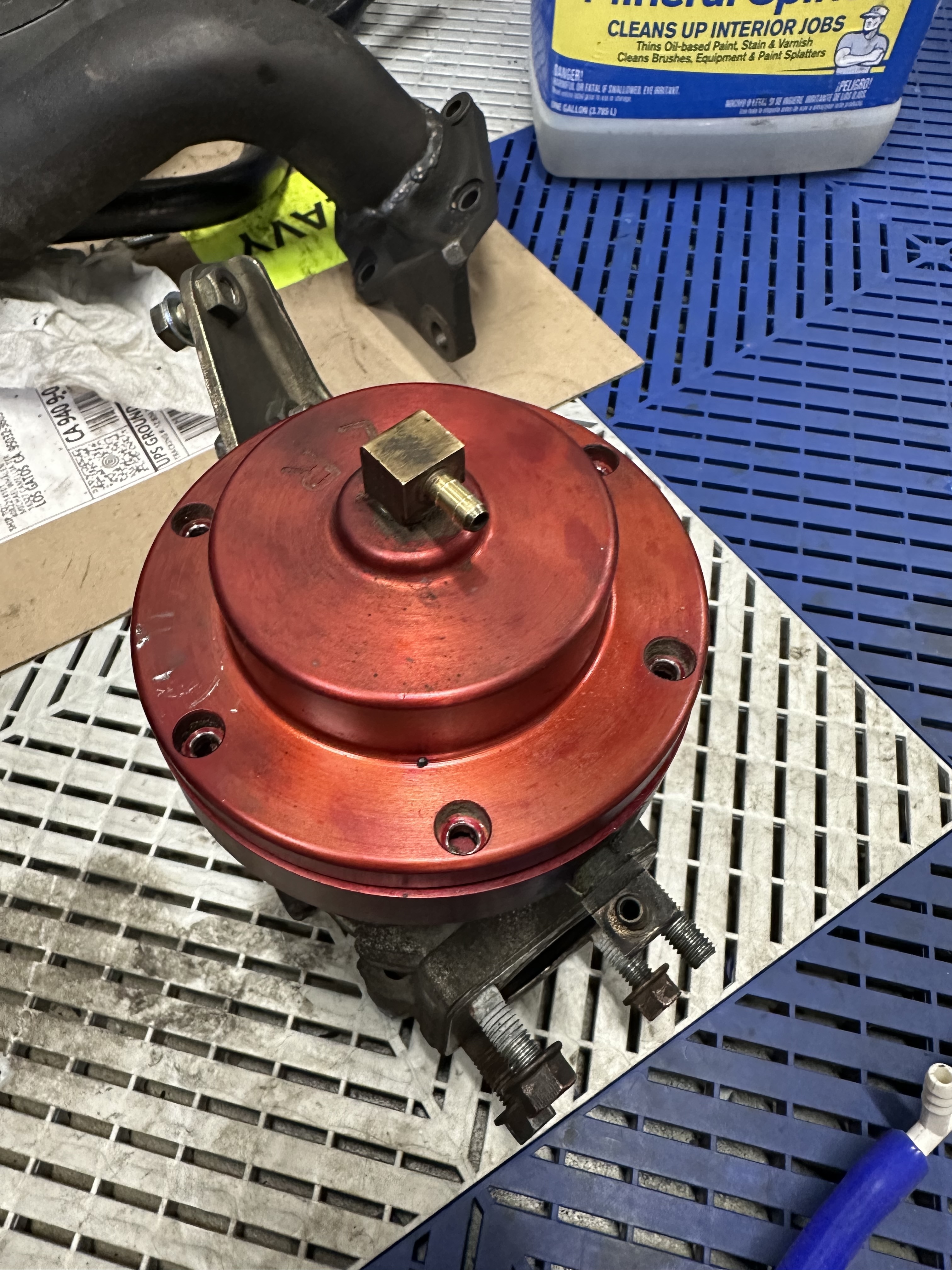

Also - I never found any good instructions on how to replace the spring, so here it is with pictures:
(1) Remove wastegate completely from car - remove all attached exhaust parts
(2) Remove 6 x 4mm allen cap nuts from the top of the wastegate - note that this is NOT under spring pressure, so just go for it.
(3) Remove cover.
(4) You will see a hex allen M6 allen fastener on top of the diaphragm after removing the cap and M8 one on the valve. I used a vice to hold an 6mm allen wrench in the top one and then an 8mm socket drive in the valve.
(5) Loosen from the valve side slowly as it is under spring pressure. You can certainly hold the valve down with your free hand when the valve is ready to release
(6) Swap the spring & then in the same viced position, pressure the whole assembly down so that the valve can be rethreaded. Reattached the cover and make sure that if you have a 90 degree port on top, it points towards the port on the side.
(7) Put the 6 screws back in the top.
See pics.
