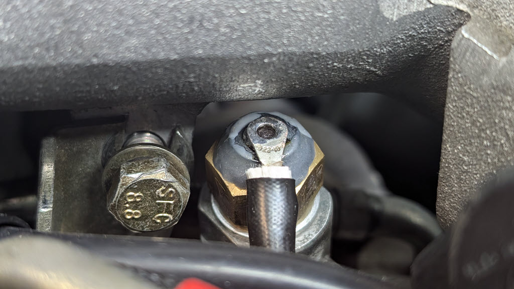

Anyone have a current source for a short temp sensor for the turbo? I got my current one at Napa, part #FS158, many years ago and just noticed the wire is frayed where it comes out of the potting material (so not really repairable). It's needed to accommodate the bigger turbo under the intake. Napa is "out of stock" nationally it seems, and I can't seem to find a suitable replacement...

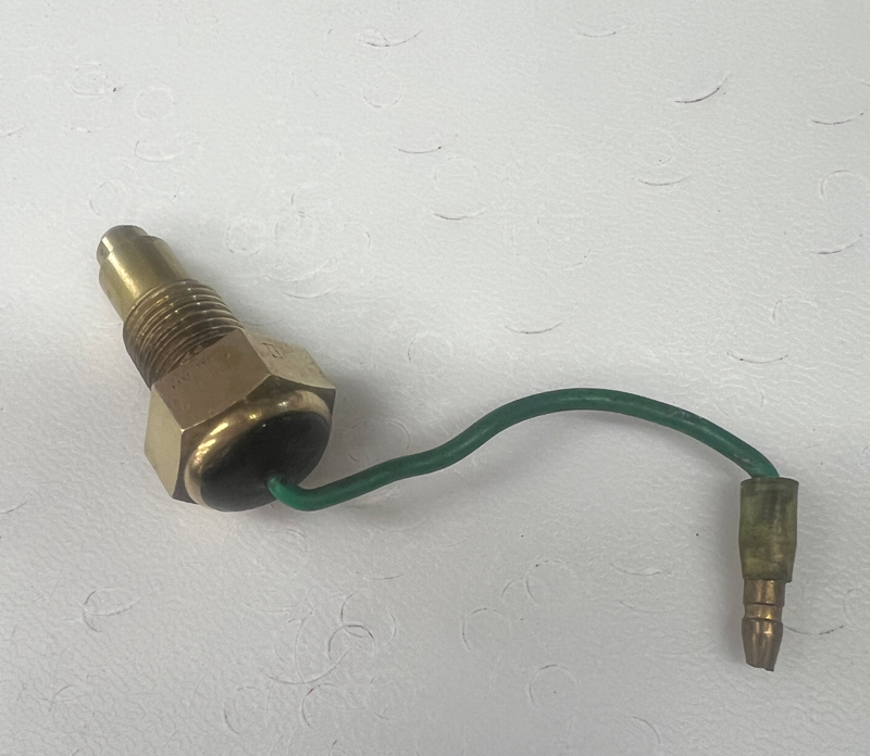

Well I got lucky and found a good used one in my big pile of old parts :)

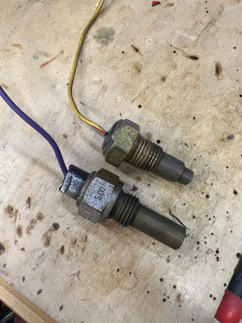

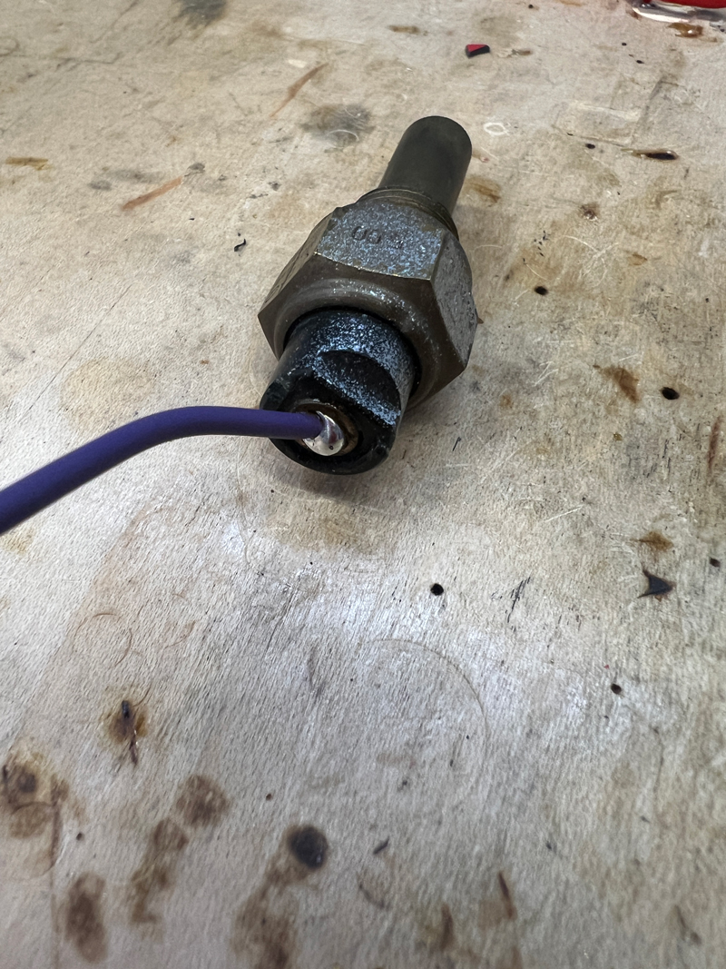

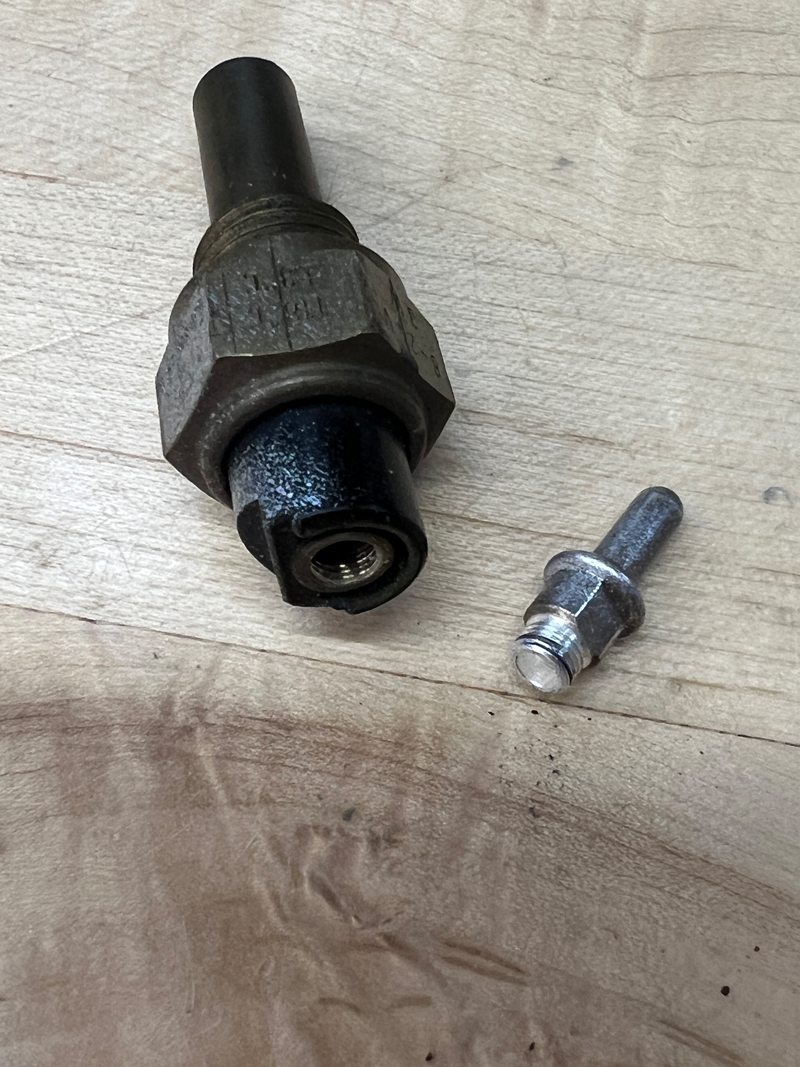

Since the short Napa versions are no longer available, I thought I'd see if I could shorten the factory one. I have not yet tested to confirm it still works, though I can't imagine it wouldn't. Turns out the top portion of the switch screws out using a 6mm wrench. Removing that connector piece shortens the piece significantly. Still not as short of the old Napa versions as shown in the last picture, but probably short enough to work for some. After playing with various ideas, I ended up just soldering a wire directly into the port where the connector piece unscrews.

Tom,
I did the same thing but had to make mine a bit shorter. The remaining insulator piece was a bit loose, so I added some JB weld to stabilize it. Works great. To test it, measure continuity between your new wire and the case. It should be open circuit. I carefully heated the sensor end using a small propane torch until my ohmmeter started beeping. Zero ohms is what you want to see. Soon as it cools back down, you should see the open circuit again.
