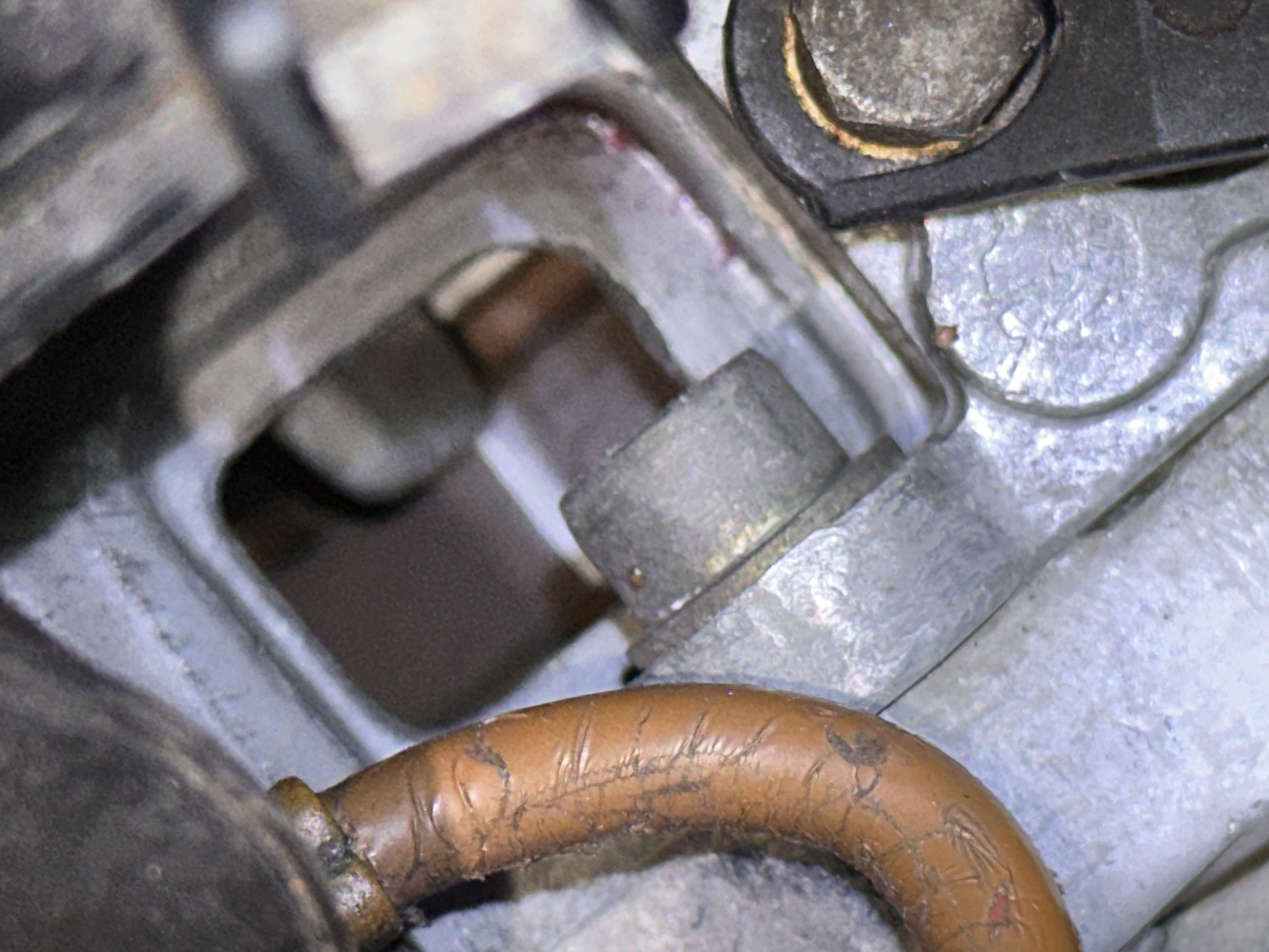

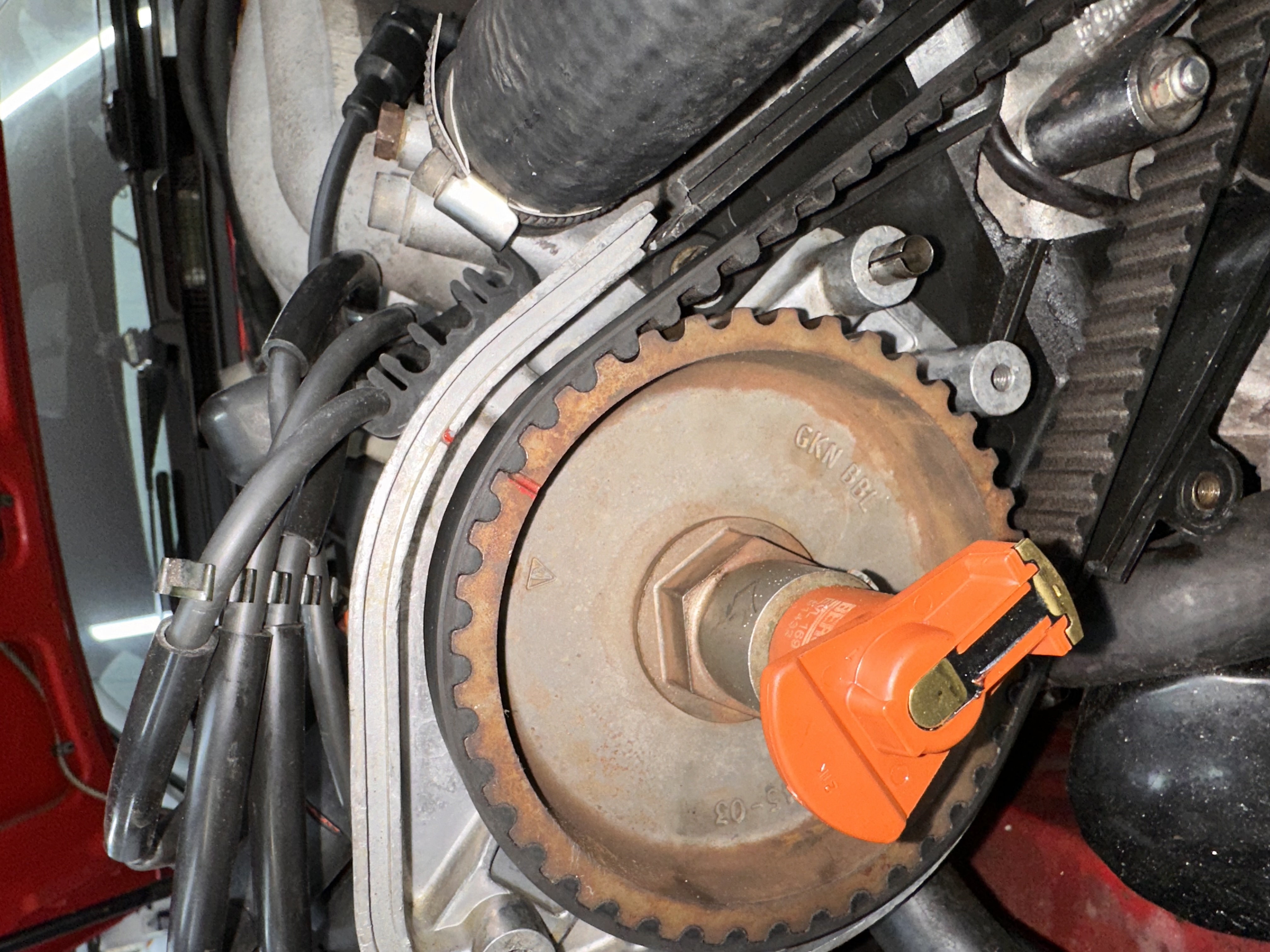

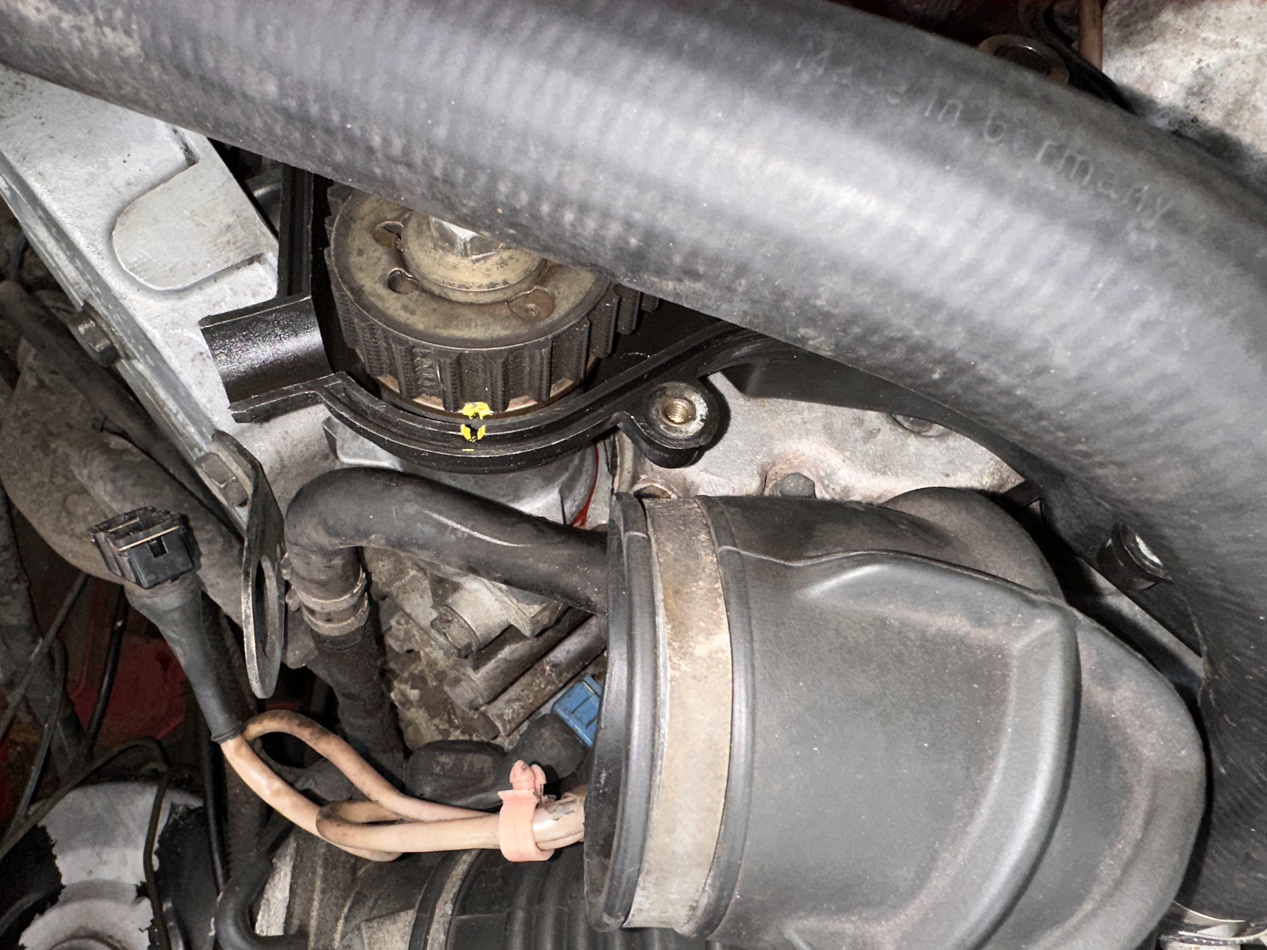

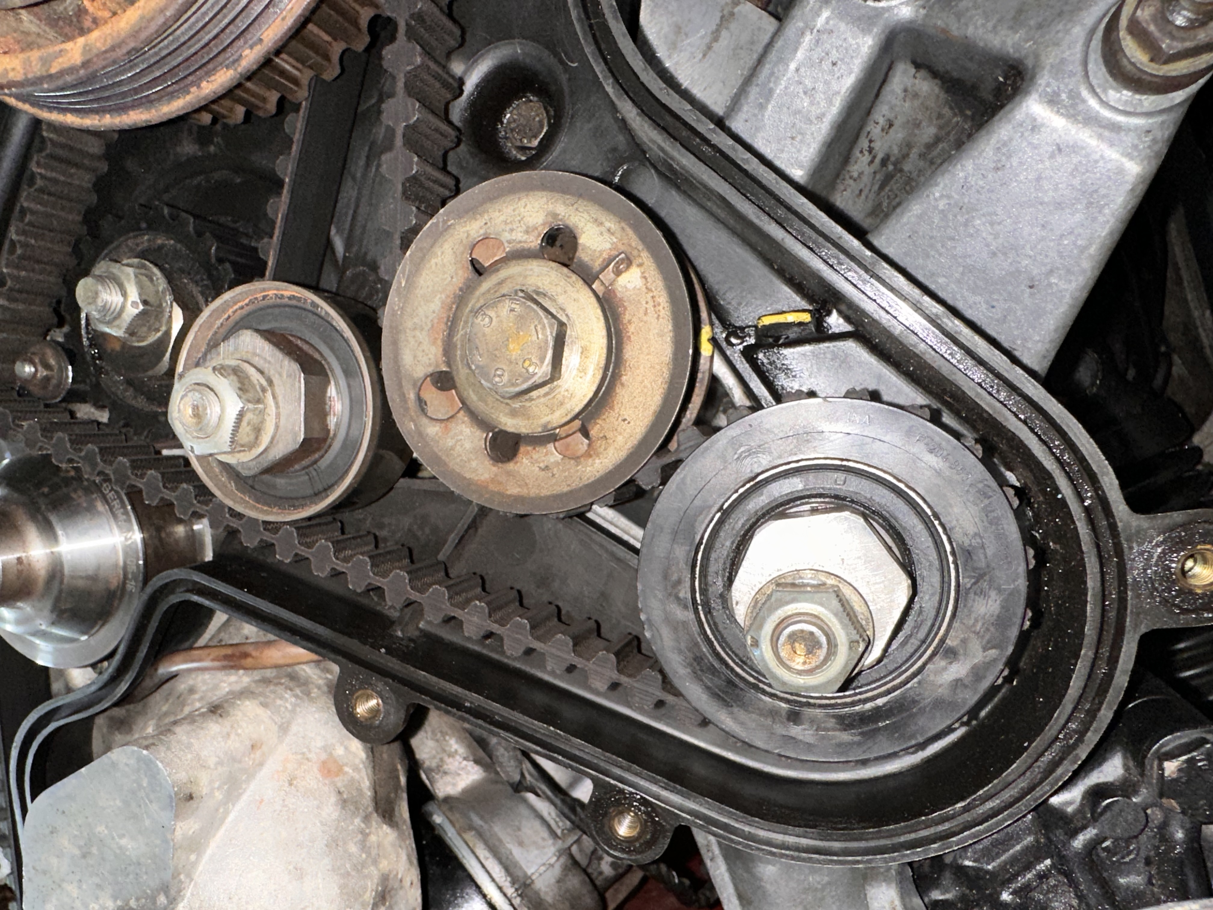

I’ve left it over night and gone away to check my settings. This morning I’ve gone out and again removed the spark plug and spun it by hand (no noises) and checked my settings, below are 4 pictures of what I saw. I could find the lower flywheel/crank marking.
The only thing I can think of is when doing the balance shaft seals, when I removed the housing both shafts moved forward around 50mm is this normal?

The components appear to be positioned correctly. It is possible that a roller / tensioner bearing is responsible for the sound.

Yes you can run the engine without the balance belt.
The eccentric pulley in the middle of the first pic can be tricky to position correctly. If it's too low it will rub on the belt below it.
