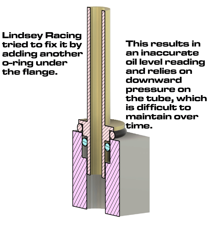

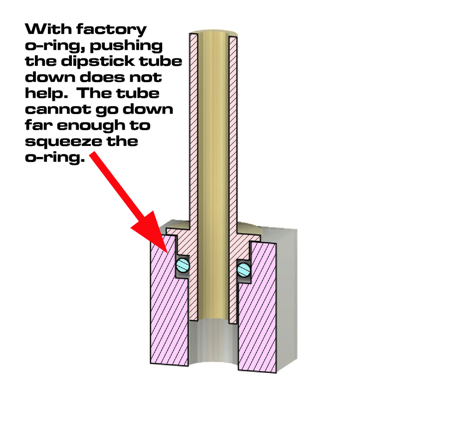

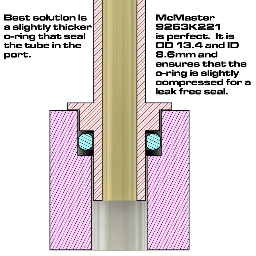

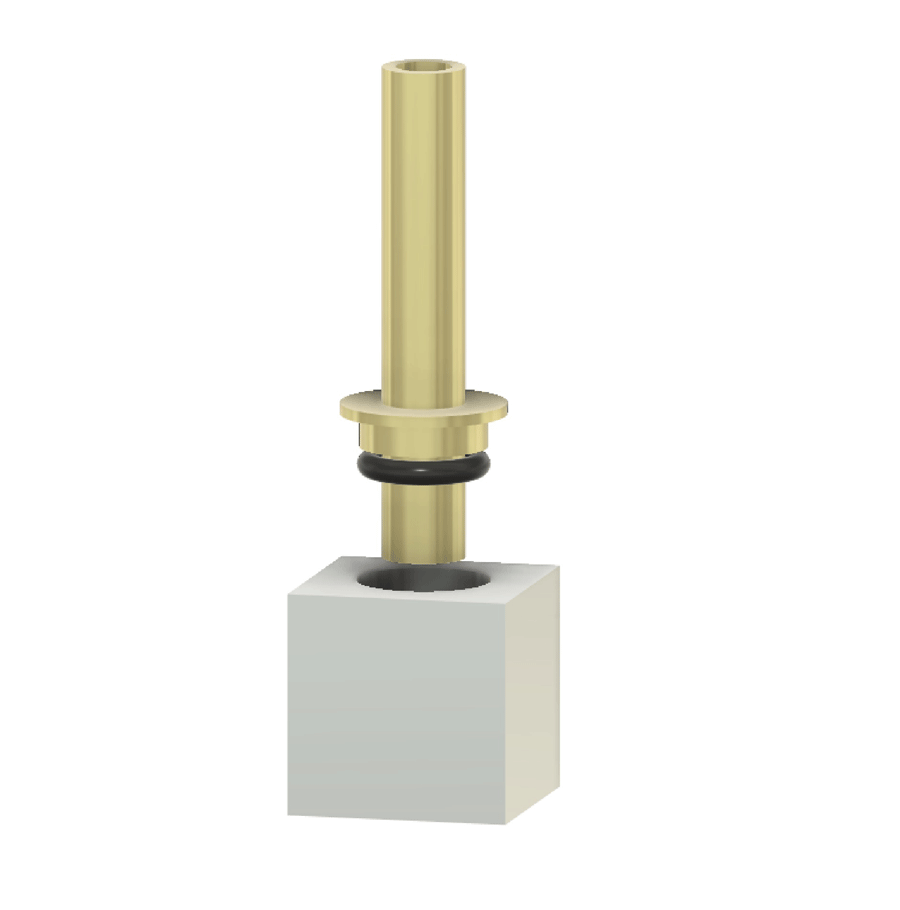

I've did a deep dive on the dipstick tube seal a while back. The TLDR version is to use McMaster's o-ring # 9263K221. The factory o-ring is very slightly smaller than the tube it goes into, so while it might block oil from coming out when under no pressure, as soon as you add a little boost-induced crankcase pressure, it will leak. Pushing down on the tube does not help because the flange (or spacer on later tubes) prevents the tube from going down far enough to squish the o-ring. Lindsey tried to solve that by adding a second o-ring under the flange, but that relies on constant, perfectly plumb, downward pressure, which the little mounting tab at the top of the tube was never designed to do. A second o-ring also makes the tube stick up a little higher, which throws off the oil level reading by that same amount. The McMaster o-ring solves the issue once and for all, with no downsides. See drawings below.
