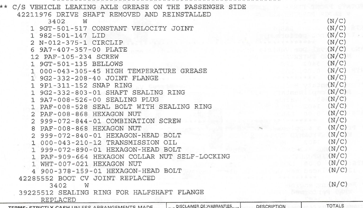

No clicking for me but I did have an inner rear CV joint on my '21 GT4 that needed work at 12k miles. It's possible that's the culprit for you. The mounting bolts had loosened allowing for unwanted play, CV joint grease was slung out all over the area of the right inboard joint. Warranty took care of it with lots of new parts. They went the extra mile with the new parts to make sure it was corrected properly.
