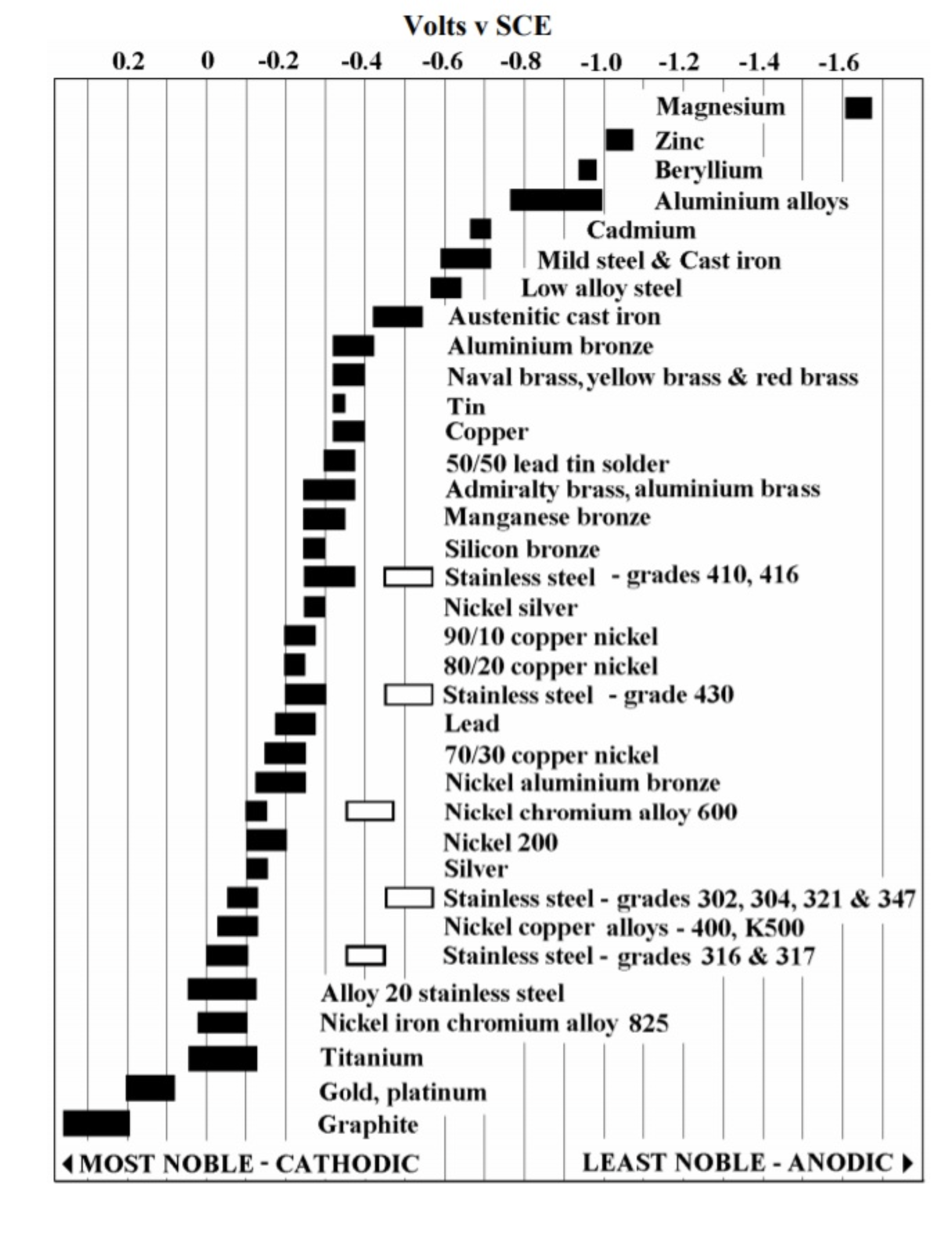

I'd just use factory studs -- metric 8.8 yellow zinc, along with factory washers and nuts. Stainless isn't as strong as 8.8, can gall easier, and increases the galvanic corrosion potential. See the galvanic corrosion scale below. The further apart the metals, the higher the potential for galvanic corrosion. Note how close aluminum alloys and mild steel are; and how much further away stainless (and copper) are... That's not to say stainless wouldn't last a long time in the right environment, but if your goal is to minimize galvanic corrosion, the chart speaks for itself.
galvanic scale.png (1.77 MiB) Viewed 513 times

The Rennbay kit has the added advantage of the hex key on the end, which is nice. I'm sure they will last a very long time! My comments above were really just focused on the galvanic scale question. :)
