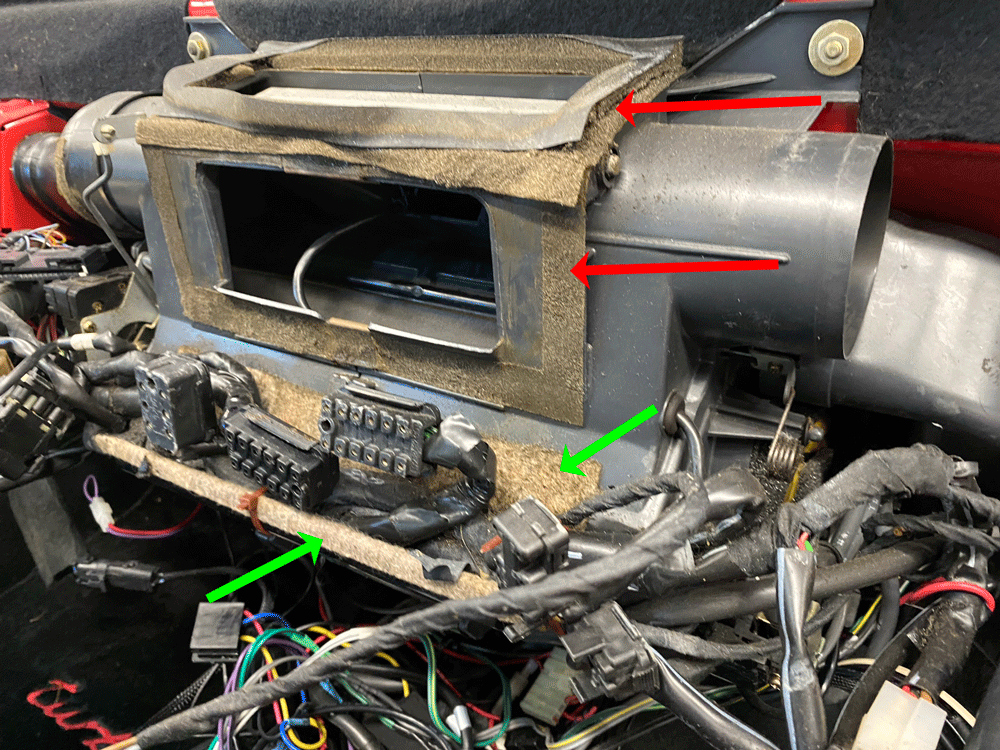

While I wait for the dash to be done in leather, I am starting in on cleaning up and de-rattling under the dash.
The foam on top (red arrows) appears to be factory part, but it's NLA. So what to use?
Also, does anyone know if the lower parts (green arrows) were originally foam -- or more of a flat felt-like horsehair? Mine seems to crushed into a pretty hard substance at this point....

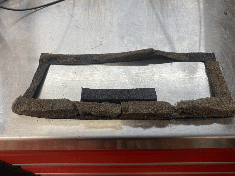

In the meantime, I found a foam that's very close to the dimensions of the original stuff. The old stuff crumbles to powder just by touching it, so hard to say exactly what size it was originally, but I figure this has got to be better than having petrified foam dust coming out the vents. :)

Tom wrote: Sun Dec 26, 2021 5:05 pm In the meantime, I found a foam that's very close to the dimensions of the original stuff. The old stuff crumbles to powder just by touching it, so hard to say exactly what size it was originally, but I figure this has got to be better than having petrified foam dust coming out the vents. :)
Hi Tom, what dimension foam have you chosen? TIA

It's 1/2" square open cell foam. As best I can tell from the crumbling foam left behind, the original was slightly bigger -- maybe 15mm square. If you find something closer, let me know :)
