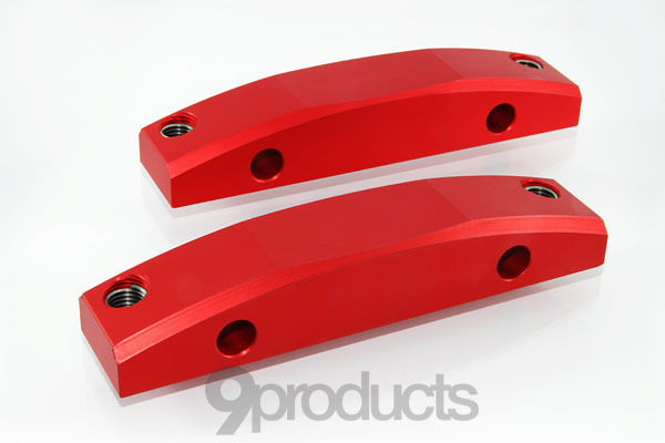

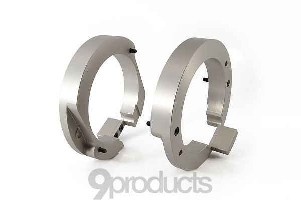

Front brakes - You have the option of using the adapters for 996TT, GT2 or GT3 callipers respectively. I opted for the 996TT due to availability, cost and I wanted to retain the option for 17” wheels, for now. You have two disc options. The standard 996TT 330mm option or move up to the 350mm found on the 997. I chose the 350mm. This is the fun part. I asked Antti if I’d need a spacer for the bigger discs as even Girodisc sends one for 996TT owners that are upgrading their discs to the 350mm. He said I did not need such an adapter. Well, as I write this my car is in the air on a rack at the shop waiting on new spacers to be made locally since I was given wrong information, and not enough parts as I would have ordered the spacers if Antti said “yes” instead of “no”. Remember, he sent me everything because he was supposed to send me everything that works TOGETHER. He didn’t. But why didn’t I just order the spacers to be overnighted from Finlnad to Western Canada, you may ask? That leads to the next issue.
The front adapters
Loose mockup of how everything will look.
Rear brakes - It is clear on his website that if you’re running 996TT rear callipers with 330mm discs, you need to mill the legs of the rear callipers down by about 10 or 11mm. This is one reason why I wanted 350mm discs, so I could avoid having to do this. Simple bolt on affaire, right? Wrong. The adapters themselves were not right. Once everything was assembled, the pads that he sent me (OEM Textar for the 996TT) left about 2mm of overhang on the disc. So, the adapter has to be milled down 2mm at the same shop that is making my supposedly unnecessary front spacers as well.
Rear adapters that are 2mm too thick

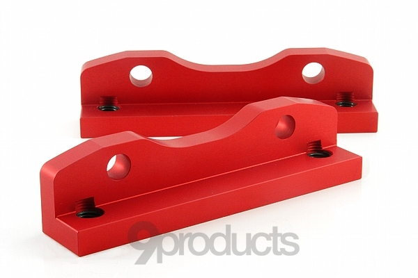

E-Brake - This was a cool option to include as it helps you to retain a normal street experience by keeping the E-brake functional with an adapter bracket. What you don’t know, because there are no instructions of guidelines online or sent in hard copy, is that the rear hubs have to be removed entirely for the adapter to be installed. They contacted Antti directly and he confirmed all of their assumptions, EXCLUDING the fact that the hub itself has to be modified to allow the factory parking adjustment hole to line up with the 350mm discs. Good times.
E-brake adapters

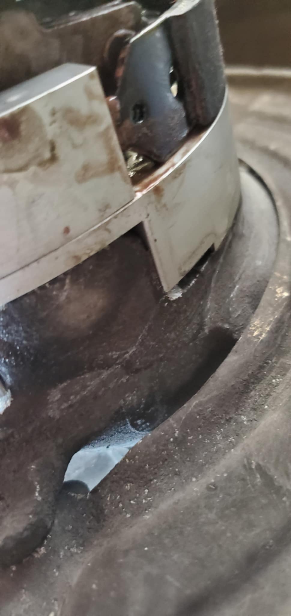

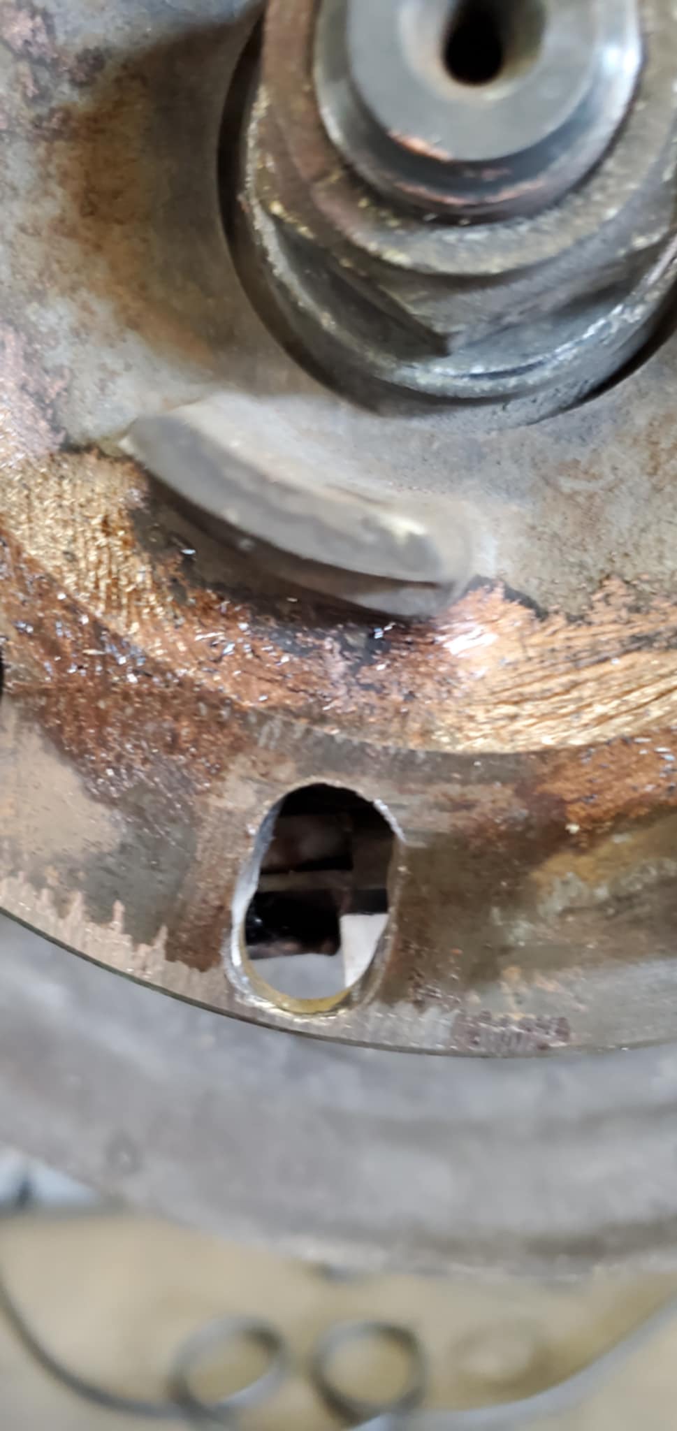

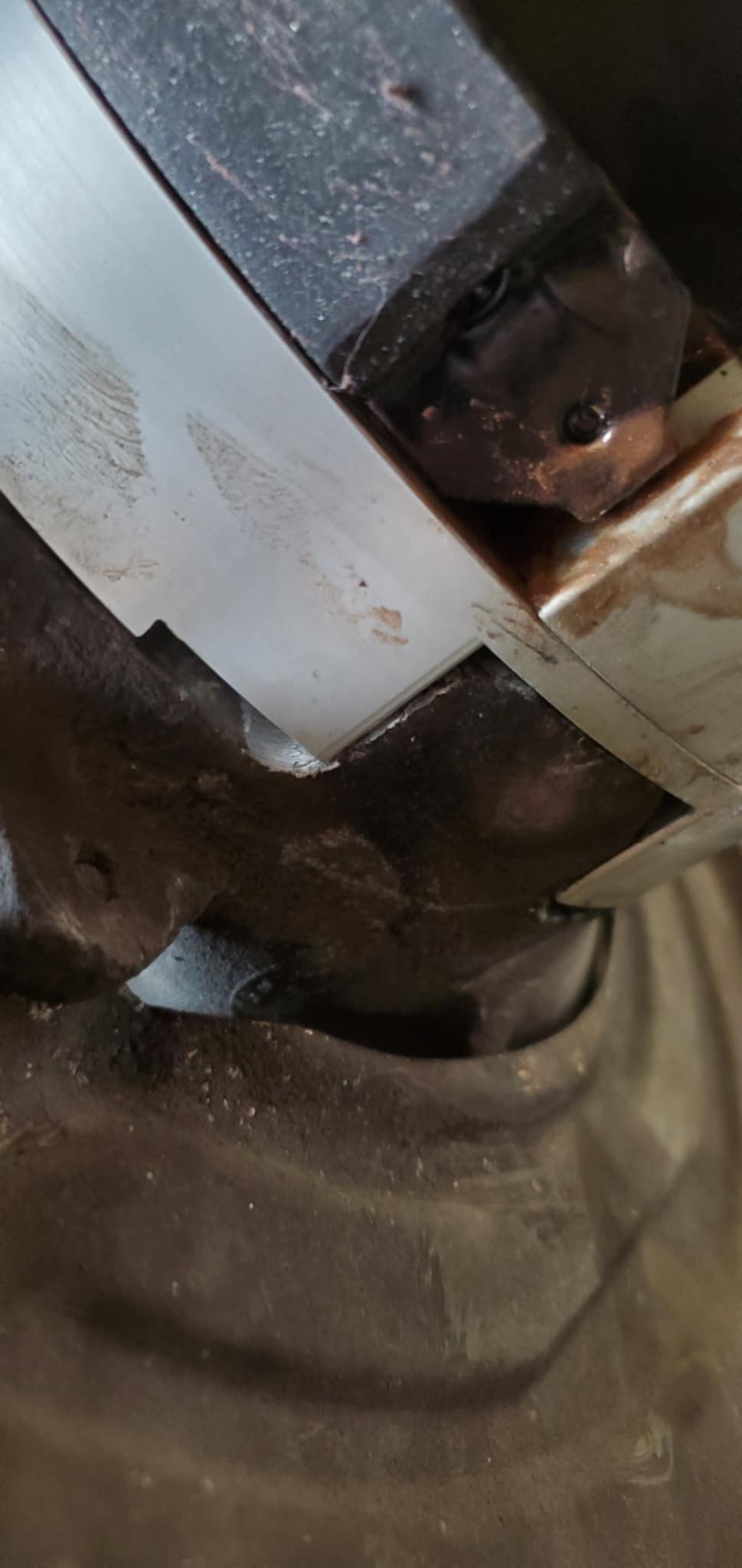

Hub alignment for the 350mm discs
Hub mods to accommodate the "bolt on" e-brake adapter.

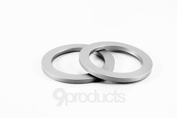

I told Antti to send me what I need to make this work, asked the questions about the spacers for the front with the wrong answer, etc. etc. My rear discs has to be redrilled with countersinks so they'd line up with the e-brake adapters on top of everything else. I mean, it's like he sent me gear made for another car so anytime I need to replaced my rear discs I'll need to modify them. The more I think about this more pissed I'm getting. I'm very understanding with these things but it's as if he was so busy he couldn't be bothered enough to pay the eff attention to my order.

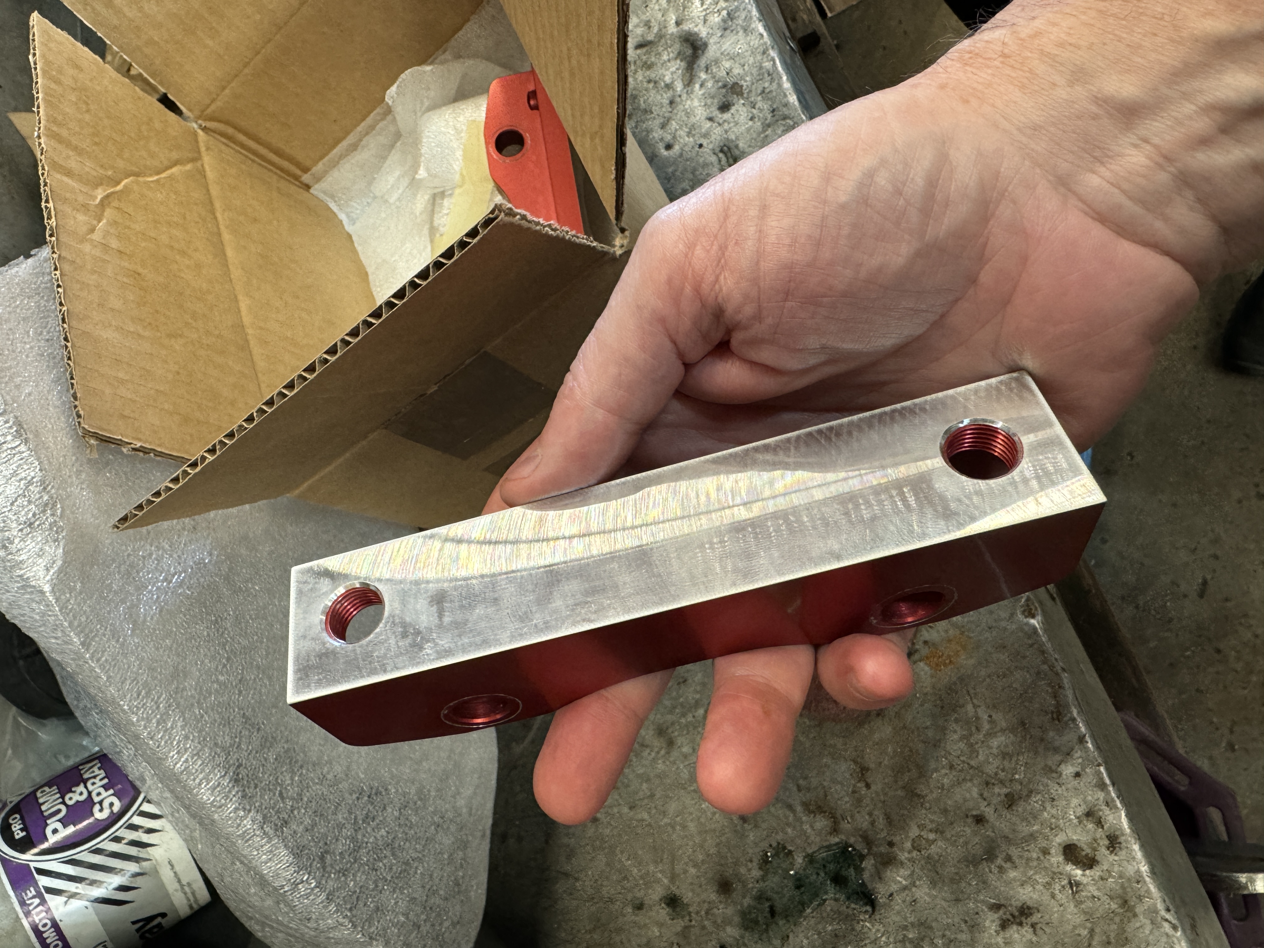

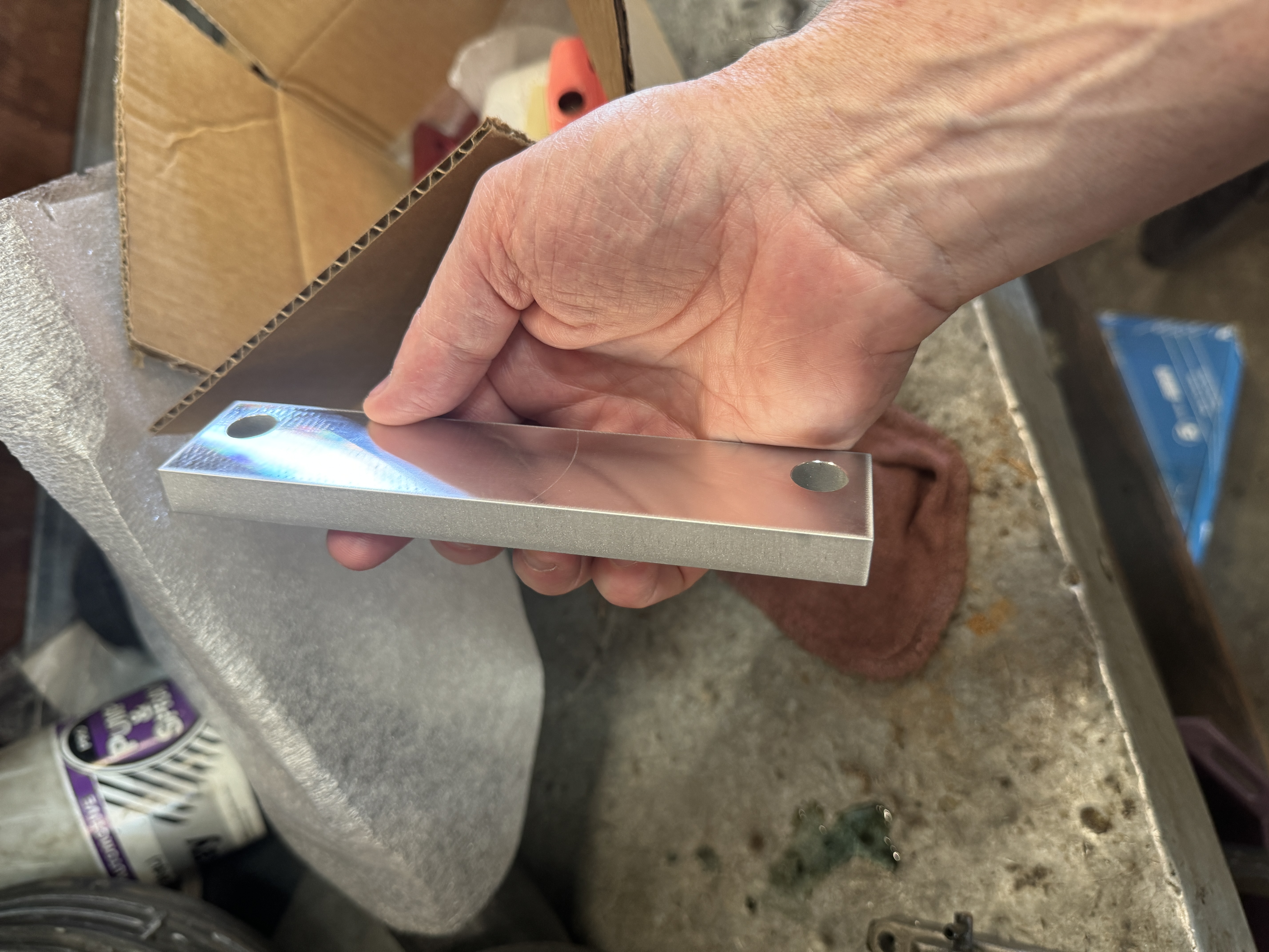

New spacers finally came in today along with the modified rear adapters.
One of the new spacers. Looks like what everyone else made for themselves that didn't buy this kit.
One of the rear adapters with 2mm shaved off. They sure are purty, and useless without spending more money to make them work.

Well, the car is finished. I had more work done to the car while we were waiting on the machine shop. I ordered a refurbished throttle body from the UK and now that it's installed and set up the car is running much better. I had an air leak at the spring on the TB that I detected with my smoke machine and that is why my idle was slightly off and I'd get a slight stumble when moving forward from a stop. Smoke machines are AWESOME for finding these problems. The shop also found that the coolant hose under the TB was about to split. The previous owner did some sort of voodoo setup assuming because he didn't have an OEM hose handy. The shop was shocked it lasted as long as it did, from before I bought the car nearly two years ago. So that was a good surprise fix. Since the rear hubs had to be removed I had the shop replace the bearings and they found that the e-brake shoes were worn so those were replaced as well. So when all is said and done, these are positives that have come about from this experience, on top of having a completely new upgraded braking system. Final bill was 8300 bucks plus tax. This included labour but also all of the custom machine work done to the custom parts that I thought were custom enough to not need more custom work. I haven't calculated how much of the final bill was brake system related, but it was the majority of the bill.

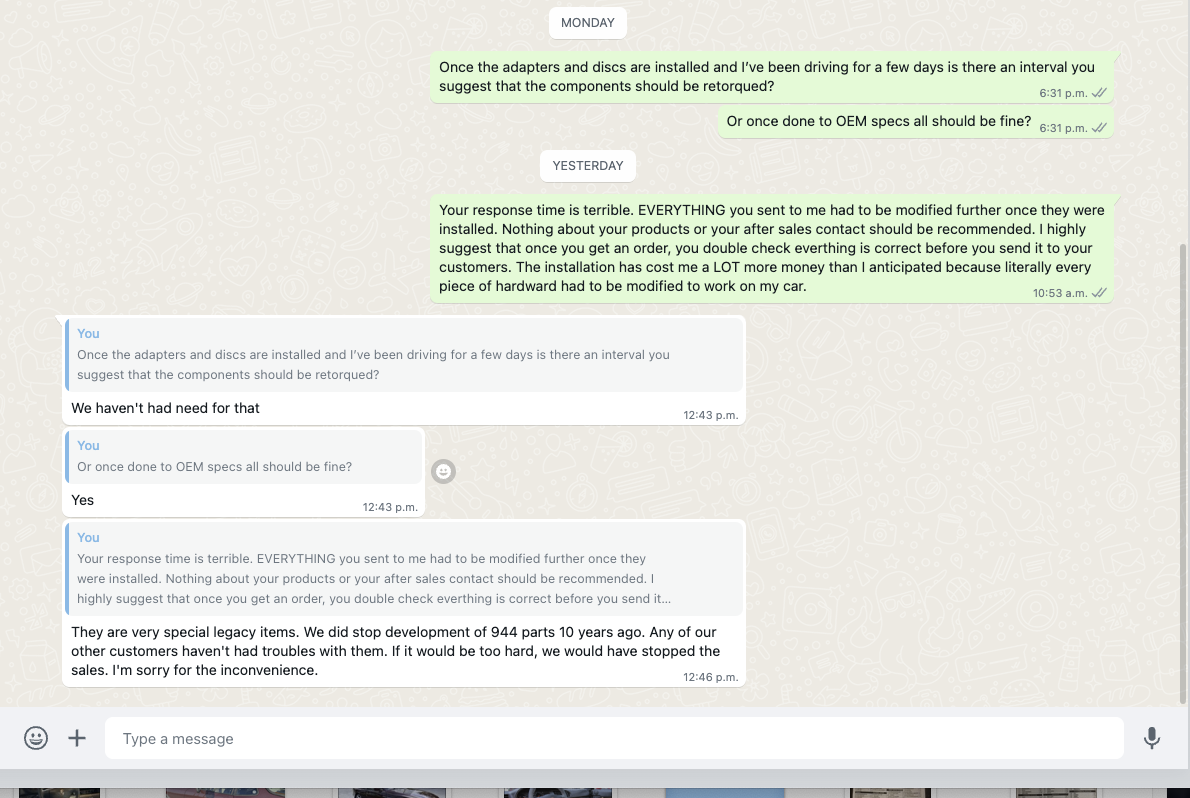

This was Antti Linkosalo's response to my frustration.
Screenshot 2024-07-17 at 9.05.20 AM.png (407.27 KiB) Viewed 1147 times
How does this justify how nothing fit?

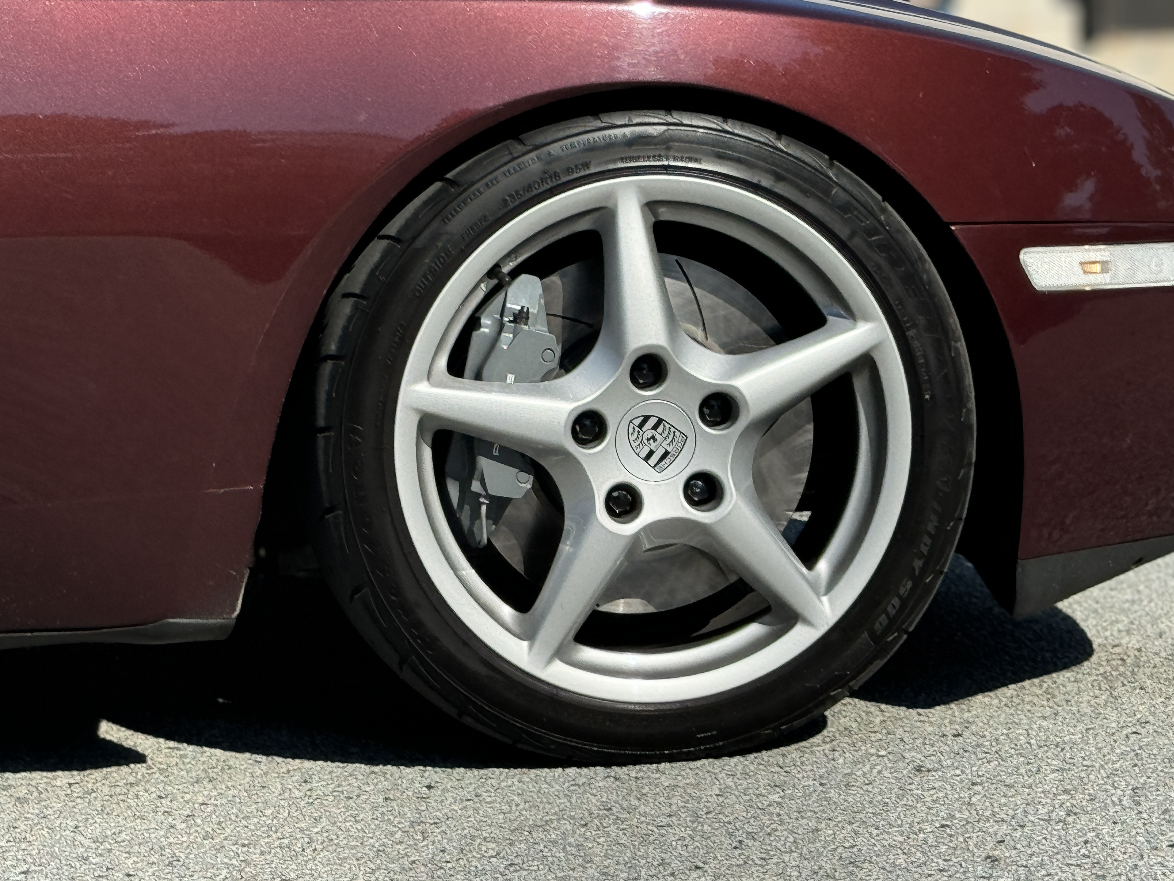

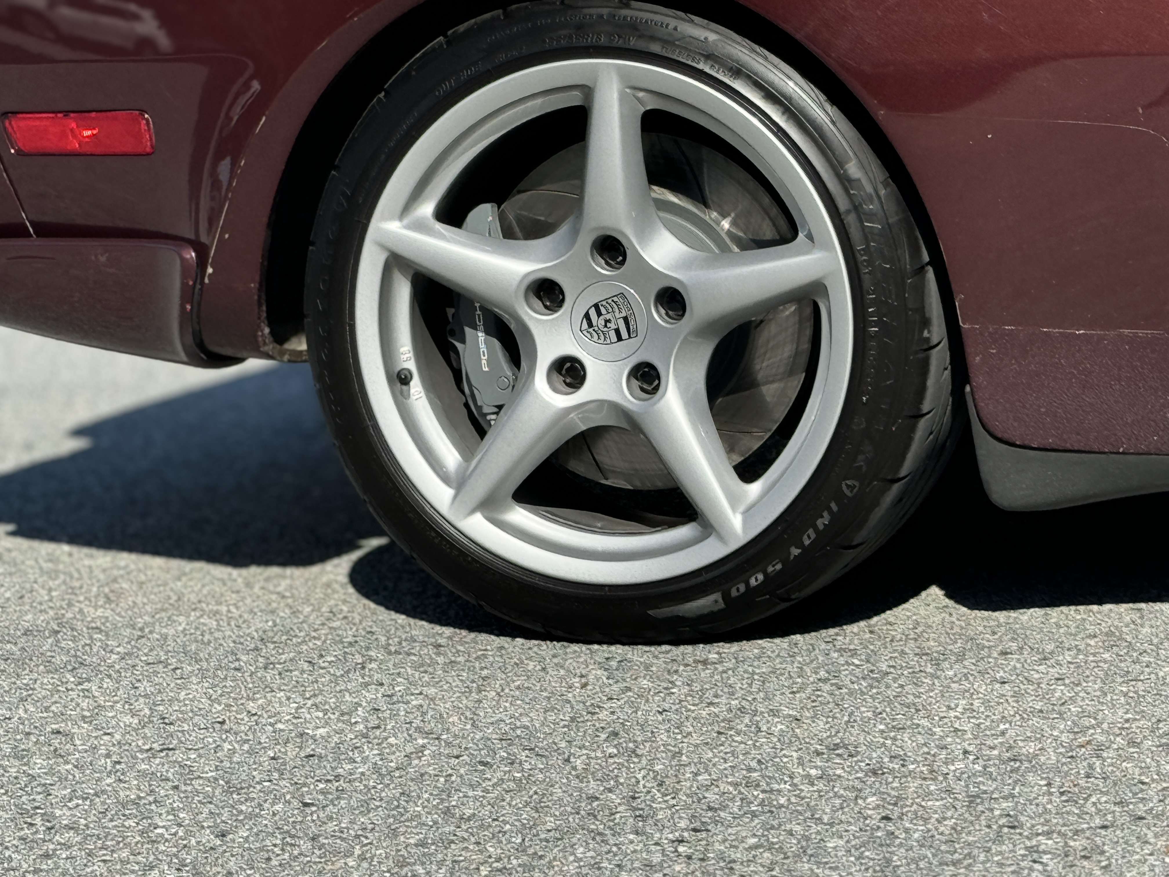

The results.
Having driven the car around for a few hours yesterday, I'm happy with the performance and the bling factor but ONLY after Juan's Auto in Richmond BC spent so much time modifying every single piece that was used to make everything work as intended. I'm being literal when I say "every piece" because it's as if Antti sent me a brake adapter kit designed to install Bentley brakes on a Honda Civic.
If anyone is researching their brake upgrade options including adding 996TT callipers to their 944, look elsewhere. 9Products.com is a joke. They don't make their own products as Antti Linkosalo told me he sold all of his machine tools so he farms the work out to another shop. The communication is non-existent. If he takes 24 hours to reply to any emails or Whatsapp messages, it's a miracle. Many questions were never answered and most that were answered were only answered after a few days and follow up reminders.
